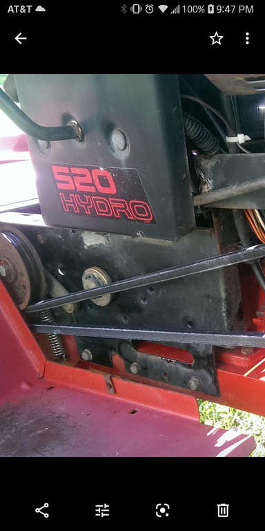

WHX?? 55,195 #2 Posted April 5, 2020 The spring hooks on a tab in back of the pully to a hole just below it. You can just see the tab here. Sorry doesn't show the lower hook hole. Was trying to show the bad bearing but check that and the condition of the drive belt. Share this post Link to post Share on other sites

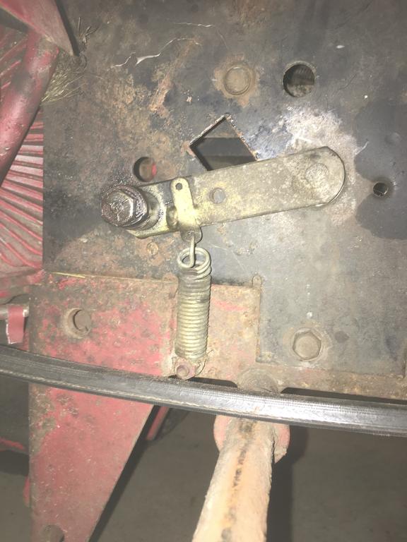

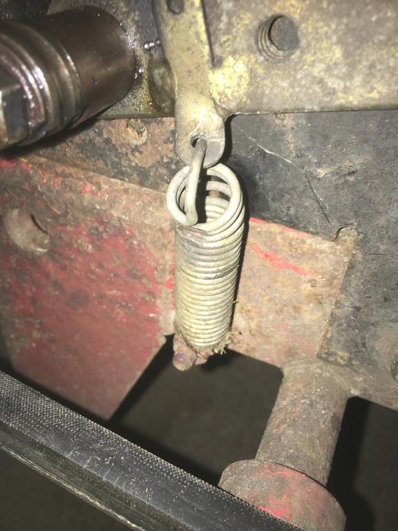

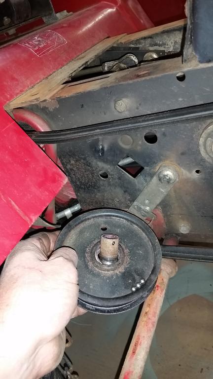

mechanic28 5 #6 Posted April 6, 2020 Here is a picture of the spring in question attached to a fixed point on the chassis at the bottom of the spring and a tab on the idler arm at the top. Just myself replacing the idler pulley which will put quite a bit of tension on the belt when installed with the spring loaded. 1 Share this post Link to post Share on other sites
WVHillbilly520H 10,378 #7 Posted April 6, 2020 14 minutes ago, mechanic28 said: Here is a picture of the spring in question attached to a fixed point on the chassis at the bottom of the spring and a tab on the idler arm at the top. Just myself replacing the idler pulley which will put quite a bit of tension on the belt when installed with the spring loaded. Hope this helps... Share this post Link to post Share on other sites
Kennyk 1 #8 Posted April 6, 2020 Perfect!! Pictures really helped. Runs strong again. Now if I am not pushing my luck, do you know what oil filter I could use from an auto store. Our Toro dealer is shut down because of virus. Again thank you. Ken Share this post Link to post Share on other sites
