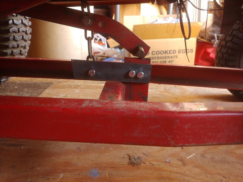

3148ISGREAT 5 #11 Posted April 4, 2020 This is what I ended up with 7 hours later. I really need to stock up on hardware. Once this virus deal is over I'm going to get the flat iron welded to the frame. I don't foresee ever selling this plow separately. So I'm not too concerned about modifying it The only thing is now the lift lever doesn't stay locked but I might just get a winch put on the front to hold the plow up in the future. 1 Share this post Link to post Share on other sites
