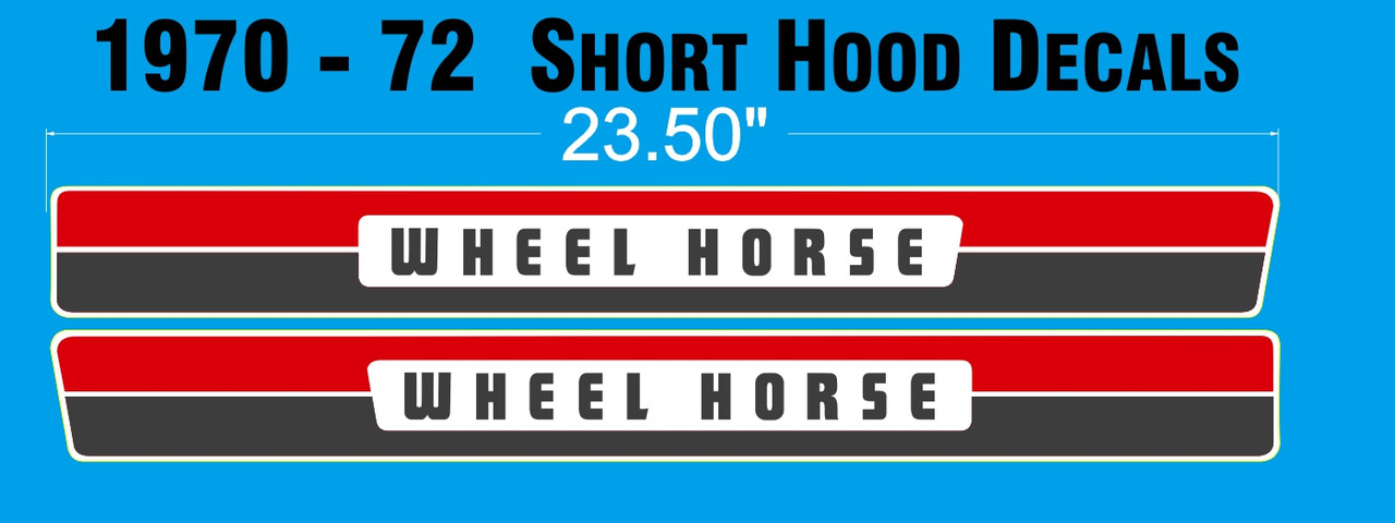

953 nut 70,347 #7 Posted April 4, 2020 10 hours ago, troutbum63 said: they must of used different decals during the year of 1970 as the decals on my electro 12 are different from the ones shown in the brochure Yes '69 was very cooo wood grained background and '70 went to a very plane background. What the heck were they thinking? Share this post Link to post Share on other sites
troutbum70 858 #8 Posted April 5, 2020 What is on mine is ok, but I did like the decals used in the brochure better. If I were to put new decals on I would probably stay with what I have. So based on the pic you sent did the 69 have a longer hood? Also I see it had different muffler, same muffler thats on my commando 800. Share this post Link to post Share on other sites
