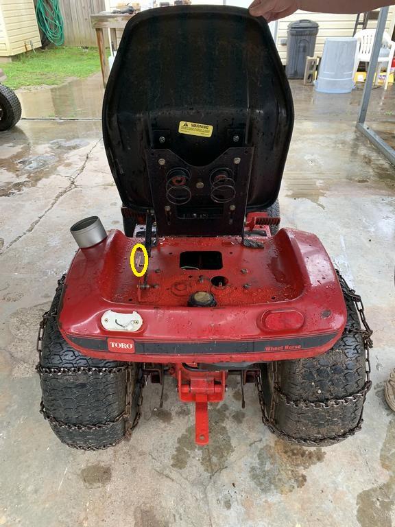

wvhunter 88 #55 Posted April 1, 2020 9 hours ago, gwest_ca said: 1990 or newer because of the black on the decals. 1989 and older were maroon. If still readable this decal has the important numbers. Axles should be 1-1/8" diameter and the differential should have 8 pinion gears. It does not get any better. Garry I found these numbers, 3112K801 15413 Share this post Link to post Share on other sites
gwest_ca-(File Mod) 12,483 #56 Posted April 1, 2020 Click on the fuzzy picture for more info Garry 2 Share this post Link to post Share on other sites

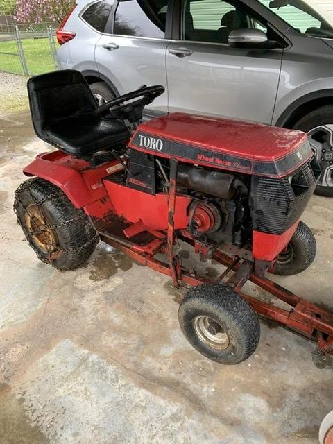

wvhunter 88 #57 Posted April 1, 2020 I drained the gas and took gas lines loose and took air hose and blowed them out.also took bowl off of carburetor and cleaned it out. started purring like a kitten, motor sounds good and all the gears work good.thanks for your help 1 4 Share this post Link to post Share on other sites
wvhunter 88 #58 Posted April 1, 2020 16 minutes ago, gwest_ca said: Click on the fuzzy picture for more info Garry thank you Share this post Link to post Share on other sites
ebinmaine 80,605 #59 Posted April 1, 2020 10 minutes ago, wvhunter said: I drained the gas and took gas lines loose and took air hose and blowed them out.also took bowl off of carburetor and cleaned it out. started purring like a kitten, motor sounds good and all the gears work good.thanks for your help Super awesome that it runs. We'd love to see video. not sure how time-consuming it's going to be but you definitely need to replace that fuel line. Do you have access to non ethanol gas in your area? Share this post Link to post Share on other sites
wvhunter 88 #60 Posted April 1, 2020 1 minute ago, ebinmaine said: Super awesome that it runs. We'd love to see video. not sure how time-consuming it's going to be but you definitely need to replace that fuel line. Do you have access to non ethanol gas in your area? yes sir, I am planning on replacing the lines. I just wanted to see if I could get it running for know. I don't know for sure where I can get ethanol gas at though. I will find out,not getting out much know because of this virus, I will try and post video of it running, thanks for the help 1 1 Share this post Link to post Share on other sites

tom2p 2,396 #62 Posted April 1, 2020 21 hours ago, peter lena said: wvhunter , just did a quick look up on your pto clevis shaft point ,, good brake down pictures , you will need , bearing ,snap ring, shaft . wheel horse parts available on this site , pete pete - how (in the heck) were you able to determine there was an issue with the PTO shaft ? from just one pic that showed that area - and it was not a close up or zoom ... eagle eyes pete ? from that pic I did notice the brake pedal appears to be back a bit more than typical (toward rear) ... ? ... 1 Share this post Link to post Share on other sites
peter lena 10,047 #63 Posted April 1, 2020 just the look of the galled bearing shell , and the fact that the pto shaft is in the middle of it tells me that is part of the failure . i have replaced the bearings and shafts on my 3 tractors , due to past owner neglect, don,t wait for a failure , regularly check out that pto set up , stay after it , pete Share this post Link to post Share on other sites

tom2p 2,396 #67 Posted April 1, 2020 (edited) 1 hour ago, peter lena said: just the look of the galled bearing shell , and the fact that the pto shaft is in the middle of it tells me that is part of the failure . i have replaced the bearings and shafts on my 3 tractors , due to past owner neglect, don,t wait for a failure , regularly check out that pto set up , stay after it , pete you were able to see a galled bearing shell in the pic below ? you must have chuck yeager eyes ! ( or a giant screen / monitor ? ) Edited April 1, 2020 by tom2p Share this post Link to post Share on other sites

peter lena 10,047 #69 Posted April 1, 2020 tom2p, the first picture you sent , that was right up on the pto drive shaft lever point , told me what was going on , when you look at the facebook site i sent , and scroll down on pictures , there is a stack of pto drive pulleys , and the guys name , easy to see the complete drive pulley with intact drive shaft . that is what you want , pete 1 Share this post Link to post Share on other sites
