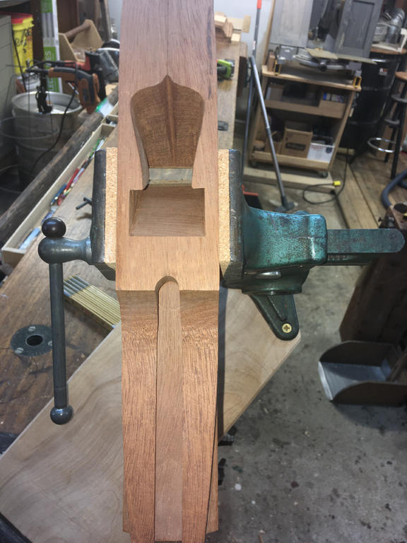

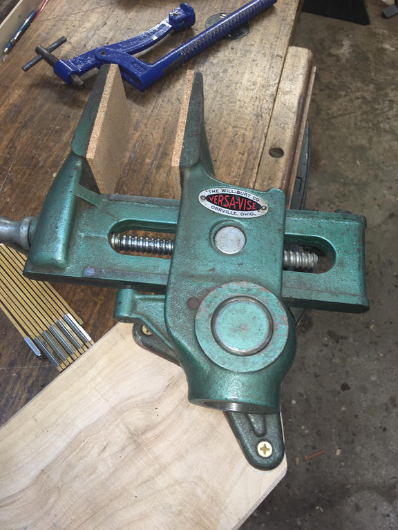

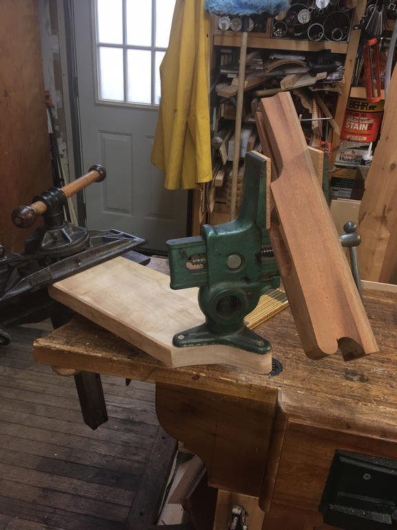

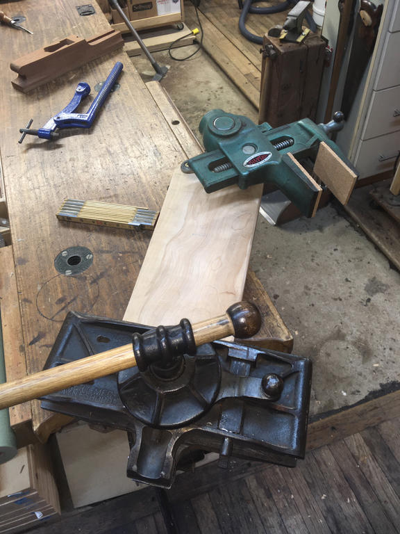

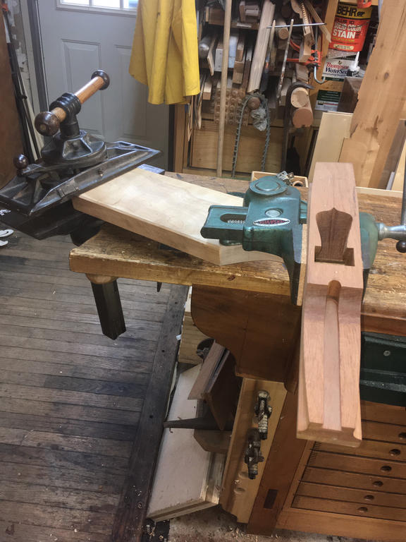

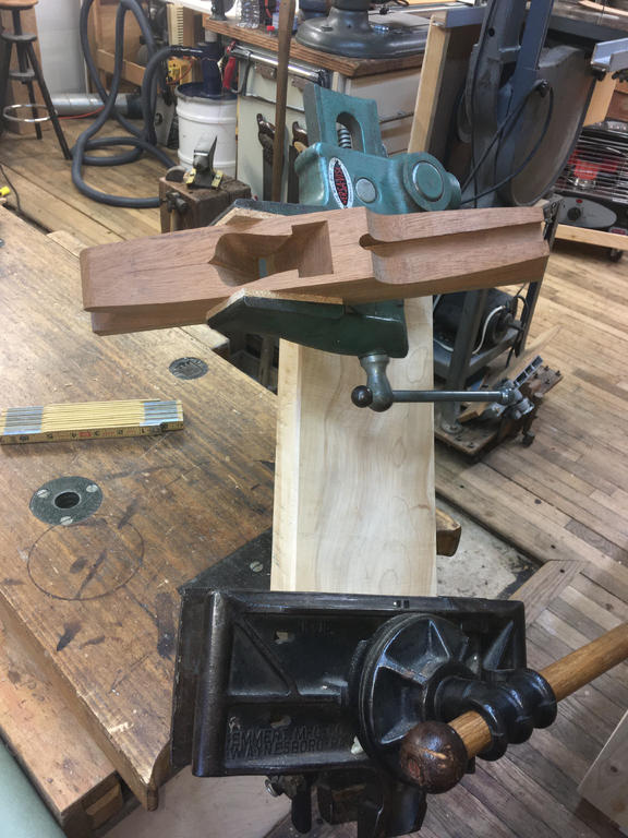

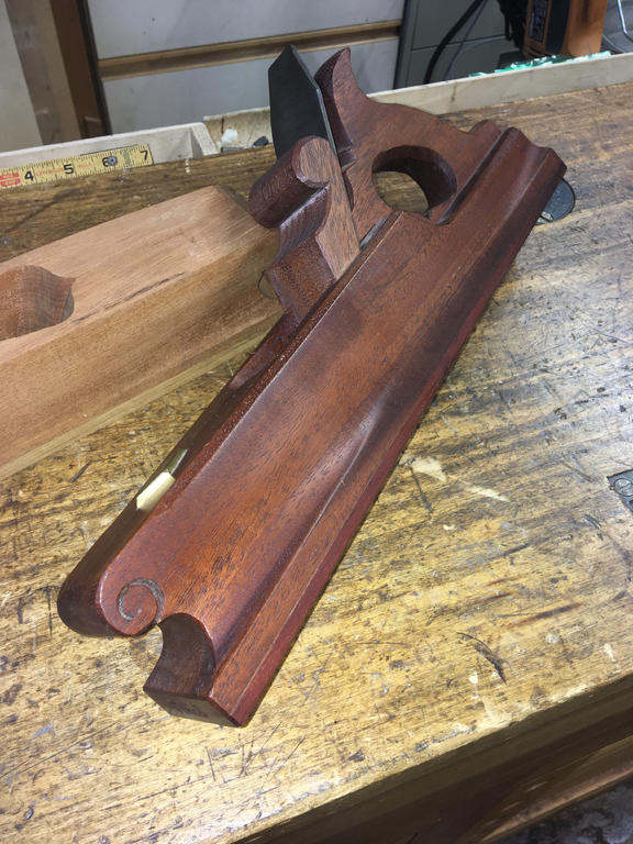

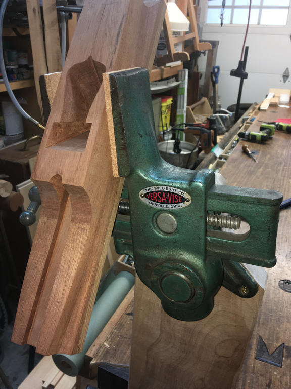

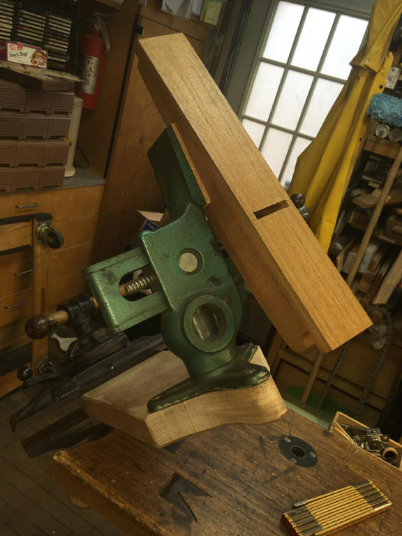

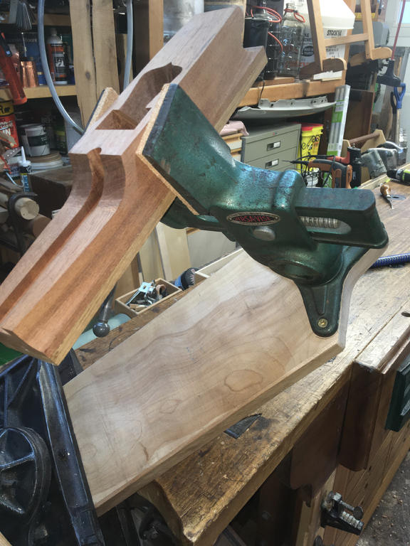

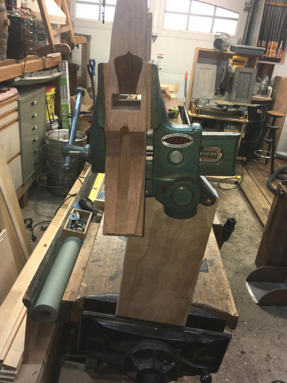

formariz 12,045 #1 Posted March 30, 2020 (edited) In my line of work there are pieces that are difficult to clamp and work on. Many times I quite literally have to have the work piece next to my face whether due to the nature of the work or to keep my back straight on long tedious tasks. For that I use an all original Will-Burt Versa Vise from 1956, attached to a dedicated board and in conjunction with an Emmert. Together they form an articulated arm that allows me to place the work at any angle or position possible allowing easier access to hard areas on hard to clamp pieces while I can comfortably keep my back straight. Vise van be mounted vertical or horizontal in its post. It is extremely versatile and together with the Emmert it is just without any peer for these tasks. I actually came about this system one day many years ago while sitting on the dentists chair and watching him moving the articulated light to all kids of positions while he worked on me. Edited March 30, 2020 by formariz 9 1 1 3 Share this post Link to post Share on other sites

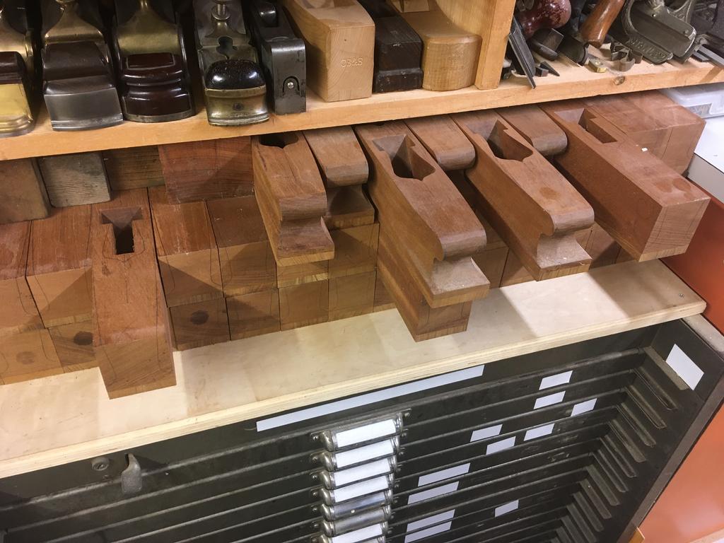

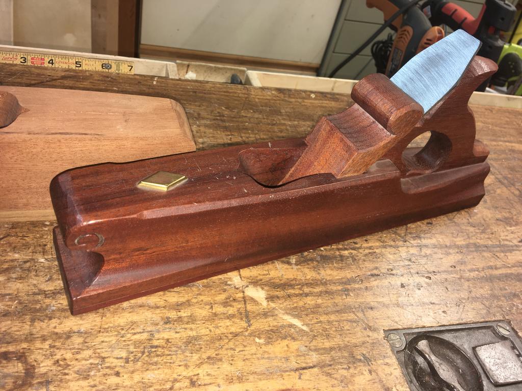

formariz 12,045 #6 Posted March 31, 2020 (edited) 5 hours ago, CCW said: Who do you make these for? I would not have thought there would be that big a demand. I have made hundreds of planes of all types. Back when Garrett Wade in NYC was the premier woodworking tool store in the Northeast I used to make planes for them. Somewhere here I still have a catalogue with one model in it. This particular plane happens to me my " trade mark " plane. People still request them and I enjoy making them.I also give a lot of them away. I am probably the last of a handful of people that makes this many planes or makes them at all. Its part of my heritage and I feel its my responsibility to do it for as long as I can. This particular one is fashioned after a family tool that incredibly has recesses worn into the wood from generations of users hands . My father worked with it since a young age and remembers his grandfather saying the same about it. Edited March 31, 2020 by formariz 1 2 Share this post Link to post Share on other sites

formariz 12,045 #8 Posted August 26, 2021 15 hours ago, yogdenyn said: Do you use this wooden tool to level the surface of the tree? Or why? Yes it is used to prepare lumber to its finished stage,. Its used as a scrub or jack plane depending on iron used. Share this post Link to post Share on other sites
