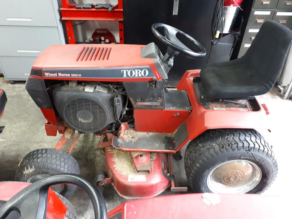

WHX?? 54,533 #3 Posted March 26, 2020 (edited) Note the nipples that are capped as they are not used. Ther is only in, out and pulse. Pulse line is on the back. It would have been mounted on the fan shroud. Left rear side of engine you should see mounting holes and a hole for the pulse line to block. A few guys ditch this pump and go to electric. I have never had issues with factory but would consider it. Cleat's a faster typer! You can see it on the upper rear part of shroud on this 520. Those pumps can be had for 20 clams on fleabay. Edited March 26, 2020 by WHX24 Share this post Link to post Share on other sites
