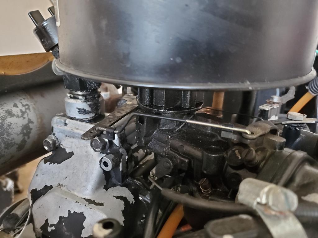

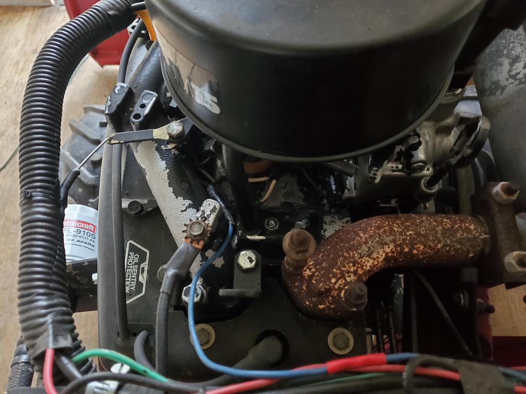

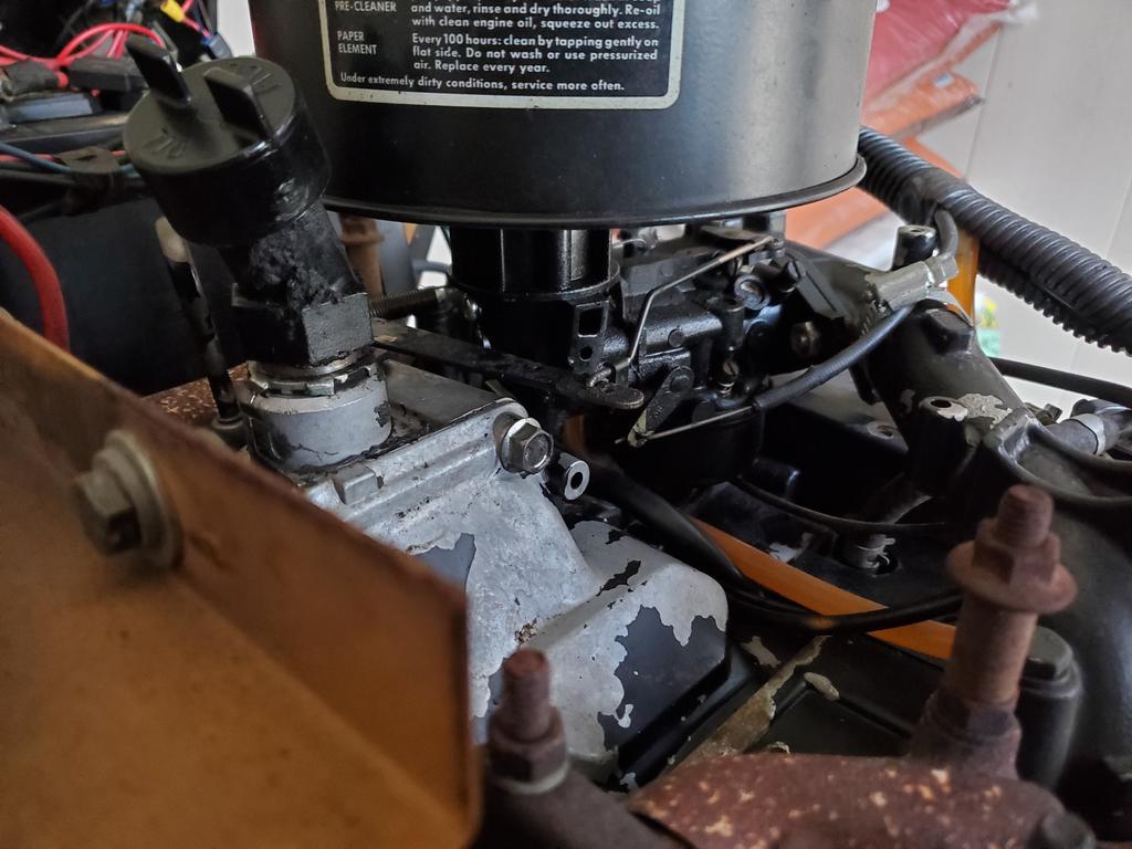

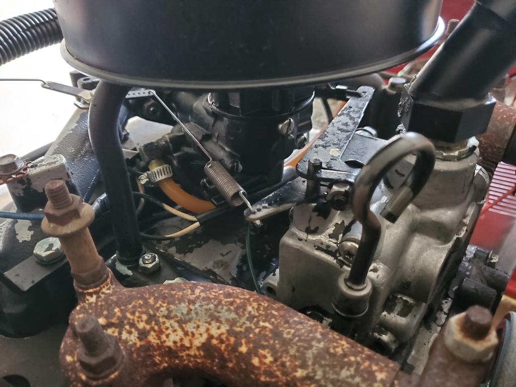

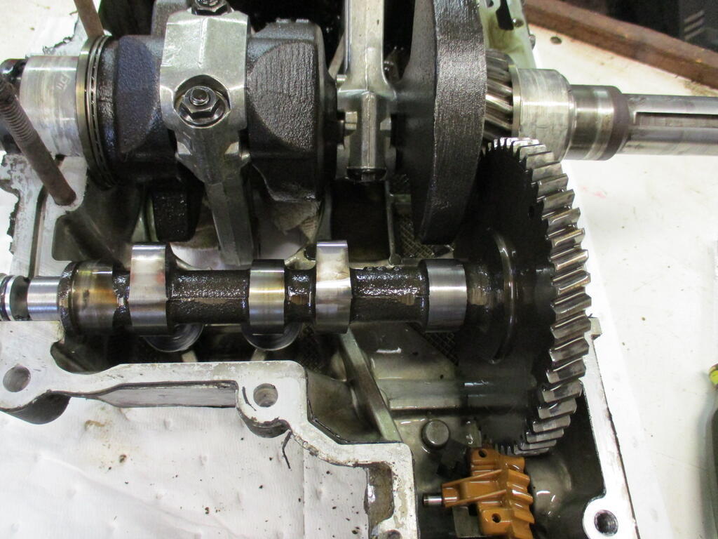

bds1984 1,509 #27 Posted April 11, 2020 Here are a few shots of the carburetor from my M18 that I repowered my 520H with. Hopefully this will help. 3 Share this post Link to post Share on other sites
bellevillerod 836 #28 Posted April 11, 2020 thank you very close to what I came up with. Won't know if mine will work until I get it running on a tank. But now I know how it is supposed to be like. Need to look up that long armed spring really could use that. Share this post Link to post Share on other sites

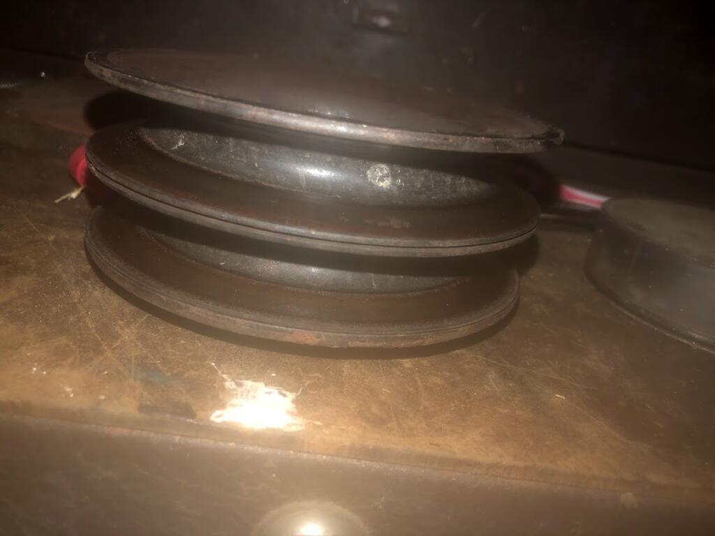

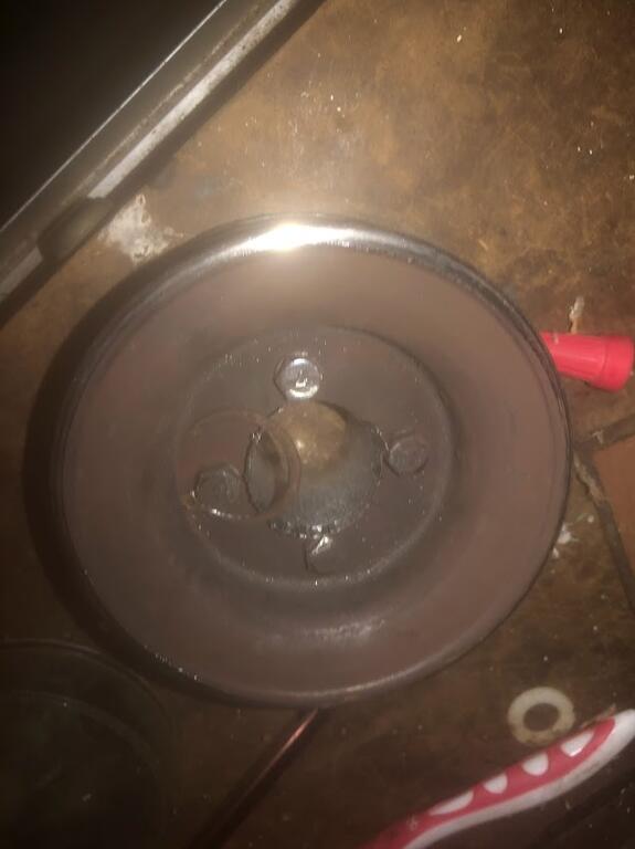

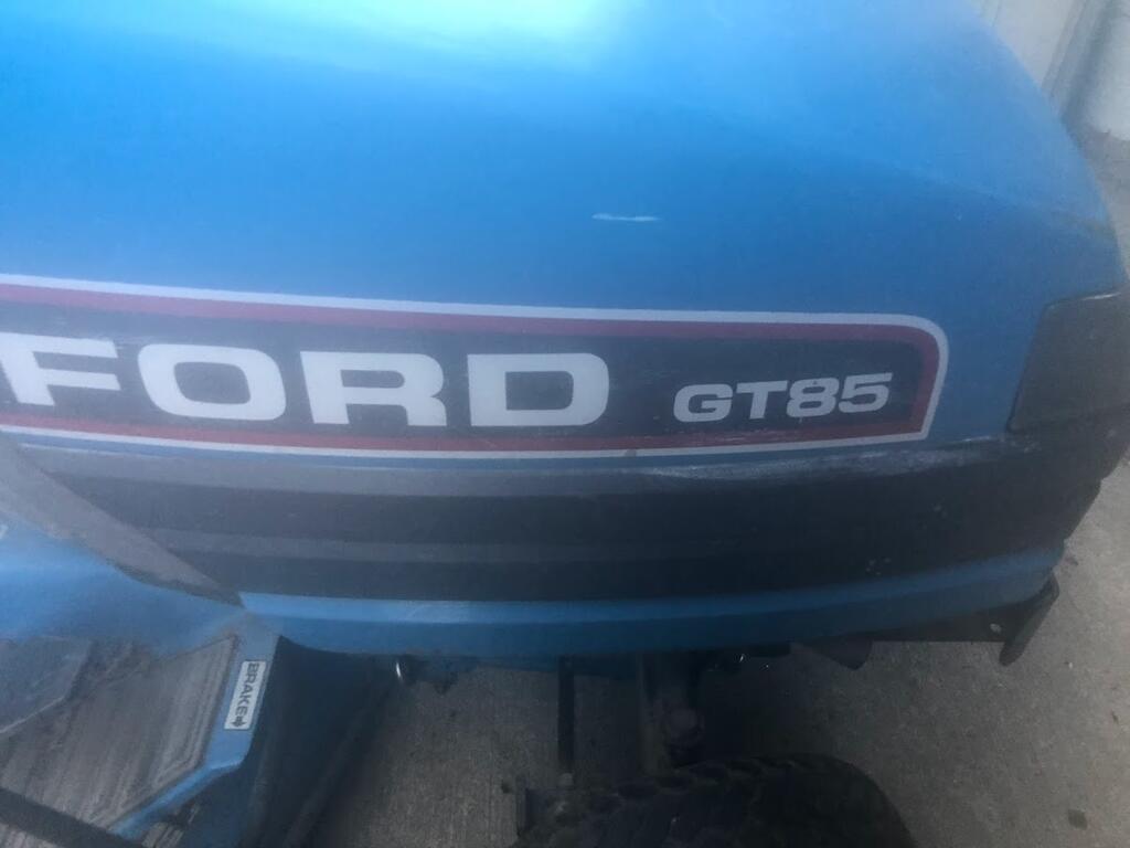

hermie 0 #33 Posted April 27, 2021 (edited) I am trying to fix my mothers ford gt85. This pulley is off the front of the Kohler M18 it drives the belt for the deck. I can not find a replacement even in the parts microfiche. Can someone give me an idea of where to find one or does anyone have a used one? It looks like the hub wore off. Thanks Edited April 27, 2021 by hermie Share this post Link to post Share on other sites

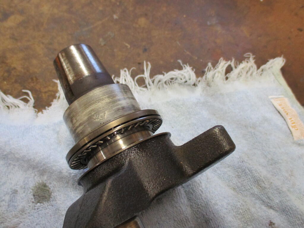

pfrederi 20,655 #38 Posted December 30, 2023 The thrust bearing that WH paid extra for from Kohler is on the Flywheel side. (I doubt they woudl do that if it wasn't needed...very very few Magnum 18 have the thrust bearing) When you engage the PTO you are trying to push the crank out the flywheel side of the block. Withe the standard sleeve bearing there is only a thin lip to resist side loading. You can see the radial needle bearing and hardened thrust washers in these pics. Good luck on your rebuild i did mine and wouold not do it again... too expensive. Some over/underparts are hard to find and machine shop work is pricey ... two of everything. 3 1 Share this post Link to post Share on other sites
Handy Don 16,751 #39 Posted December 30, 2023 Excellent pictures showing the thrust bearing and races. Clarifies why it is an extra expense when making the engine and why it is on the flywheel side! 2 Share this post Link to post Share on other sites

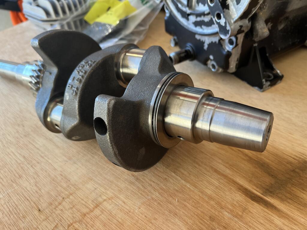

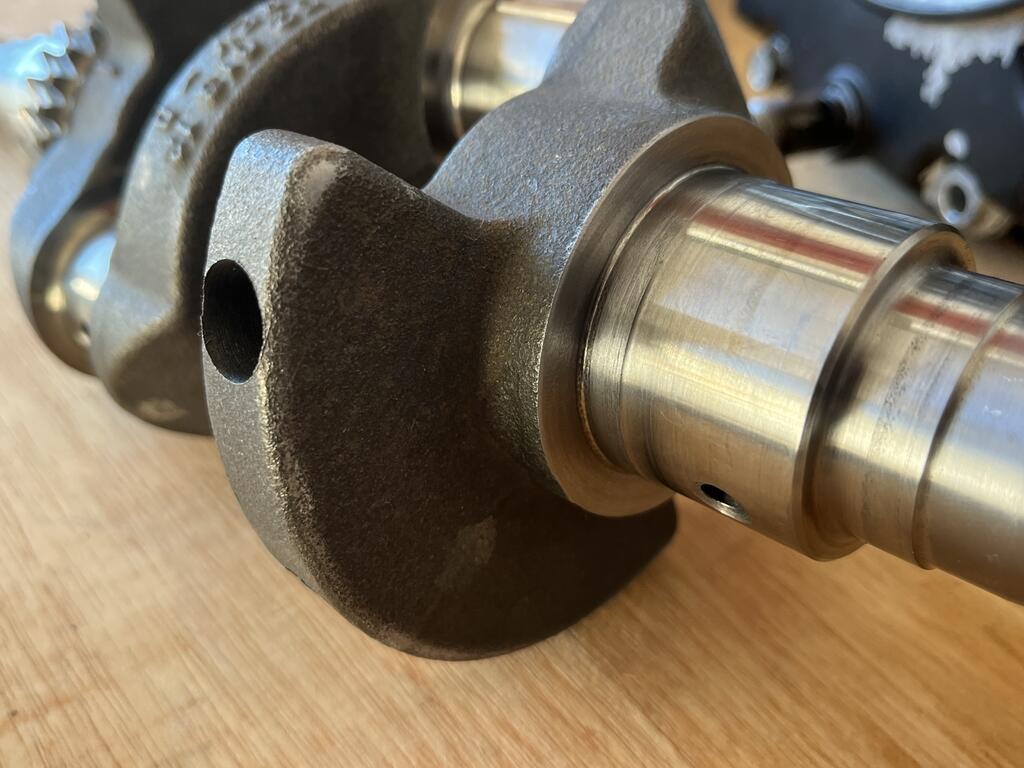

Too many horses 9 #41 Posted December 31, 2023 Magnum 18 Torrington bearing retrofit. Took the crank to work today and machined .253” off the thrust surface at the flywheel end of the crankshaft. Most of the time was to make sure the indicated runout was less than .001” With the crank in the block there is .009” end play now. Thanks to all that replied to my inquiry! Joe 3 1 Share this post Link to post Share on other sites
