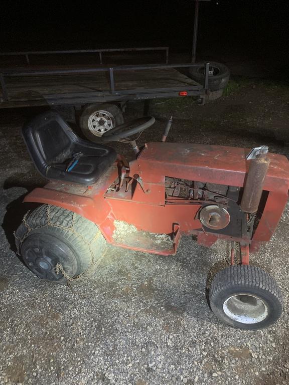

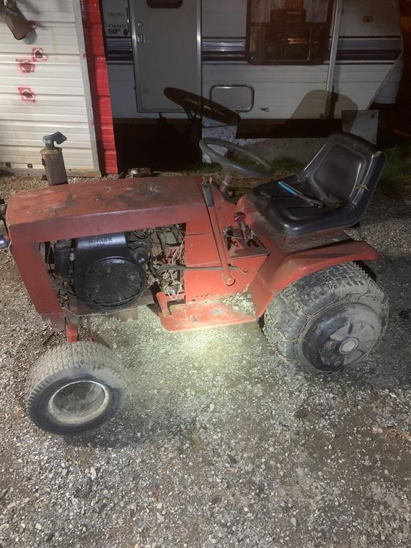

wheelhorse66 10 #1 Posted March 23, 2020 (edited) Can someone tell me what kind tractor this is?it has no tag on it.it has a 12hp Kohler engine.thanks Edited March 23, 2020 by wheelhorse66 1 Share this post Link to post Share on other sites

Sparky-(Admin) 26,485 #15 Posted March 23, 2020 So if the motor is original it’s a C-121 8 speed. This model was produced in 1978 and 1979. 81-12K801 1978 C Series Garden Tractor C-121 8-Speed Kohler K301AS-47648D 12 Wheel Horse 103916 91-12K801 1979 C Series Garden Tractor C-121 8-Speed Kohler K301AS-47648D 12 Wheel Horse 103916 3 Share this post Link to post Share on other sites

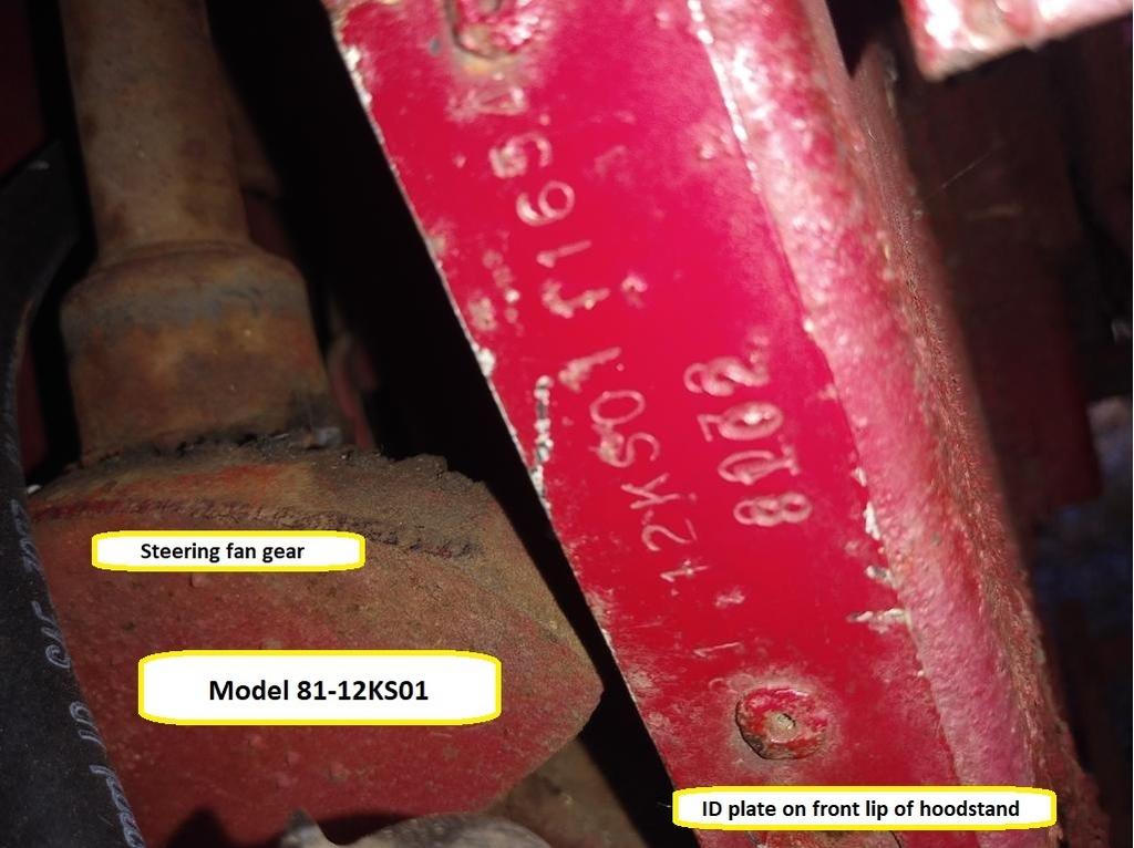

953 nut 69,739 #16 Posted March 23, 2020 There is probably a tag just under the dash board on the tower. Share this post Link to post Share on other sites
gwest_ca-(File Mod) 12,505 #17 Posted March 23, 2020 The model and serial may be in an odd location. This photo is taken standing at the left front wheel looking back toward the rear of the tractor. This is a 1978 Auto model. Garry 1 1 Share this post Link to post Share on other sites
wheelhorse66 10 #18 Posted March 24, 2020 Ok I will check that location when I get home.there is no tag underneath the dash. Share this post Link to post Share on other sites
8ntruck 9,328 #19 Posted March 25, 2020 Pictures showed up for me. It's an 8 speed. Looks like it has a clutch pedal on the left and a brake pedal on the right. There is a cover on the frame tunnel. Looks like the pto is incomplete. Early C series? 1 Share this post Link to post Share on other sites
8ntruck 9,328 #20 Posted March 25, 2020 A quick wander through tractor data.com suggests a C 121. 2 Share this post Link to post Share on other sites
Retired Wrencher 7,002 #21 Posted March 25, 2020 Do I see a cradle mount on the engine? 1 Share this post Link to post Share on other sites
bottjernat1 2,197 #22 Posted March 25, 2020 34 minutes ago, Retierd Wrencher said: Do I see a cradle mount on the engine? i see it to! Share this post Link to post Share on other sites
wheelhorse66 10 #23 Posted March 26, 2020 What do yaw mean by cradle mount? I just bought this tractor with a blade for 250.00 guy said it needs a starter.but still wandering about a cradle mount.what is it? Share this post Link to post Share on other sites
cschannuth 3,821 #24 Posted March 26, 2020 In 1978 instead of mounting the engines directly to the frame they were mounted to a cradle (steel plate). That cradle was mounted to the frame using 4 rubber mounts to reduce vibration. 4 Share this post Link to post Share on other sites
