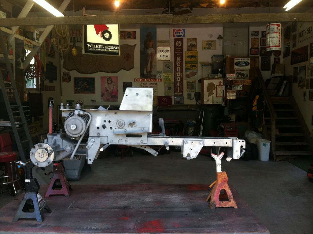

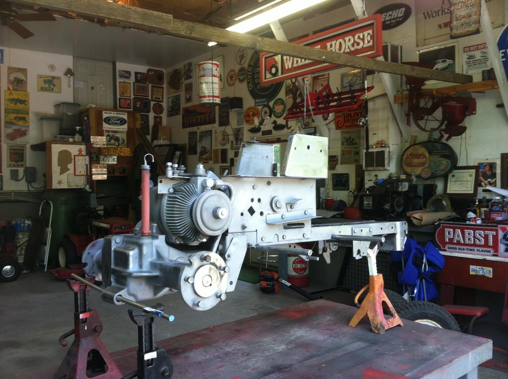

c-series don 10,821 #4 Posted March 22, 2020 (edited) 12 hours ago, ZXT said: Do you have the broken pieces? I'd stop drill any cracks that are present, and weld the missing ears back on with extra reinforcement. This is exactly what I did. This is a common problem with these models. As a matter of fact the wobbly seat was the main reason I took my Work Horse apart. One thing lead to another and next thing I know it looked like this! Edited March 22, 2020 by c-series don 2 2 1 Share this post Link to post Share on other sites

ronhatch 410 #6 Posted March 22, 2020 (edited) C-SERIES DON; Nice job. Love the Blue oval and the red belly too! Edited March 22, 2020 by ronhatch 1 Share this post Link to post Share on other sites
