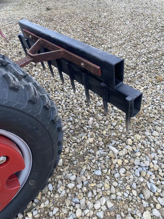

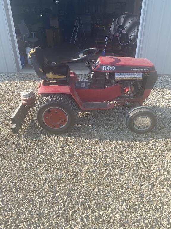

Tonytoro416 1,387 #2276 Posted July 23, 2023 Finally got time to finish my quick and dirty harrow build. Not anything fancy or pretty but it worked really good. I was extremely happy with how well it worked on my driveway. Of course the hydraulic lift on the 416 makes it really nice 3 12 Share this post Link to post Share on other sites

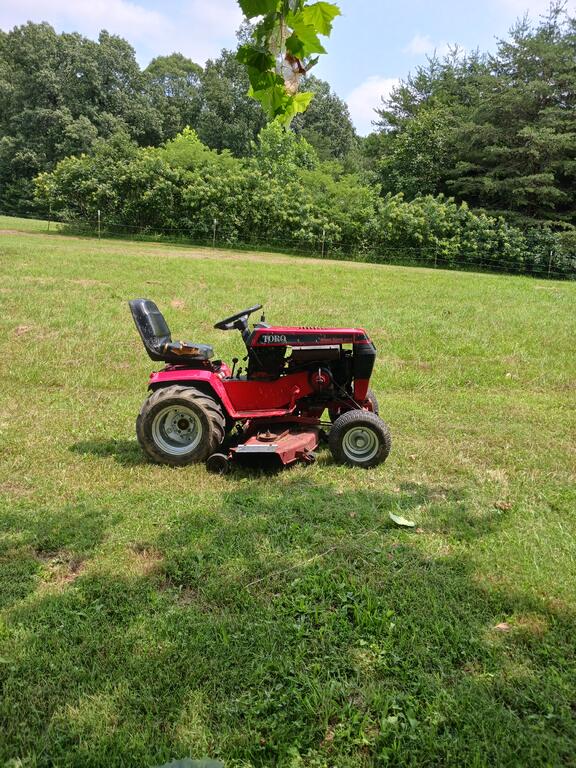

Sodaking27 1,358 #2277 Posted July 23, 2023 Out for a morning stroll. 8 2 Share this post Link to post Share on other sites

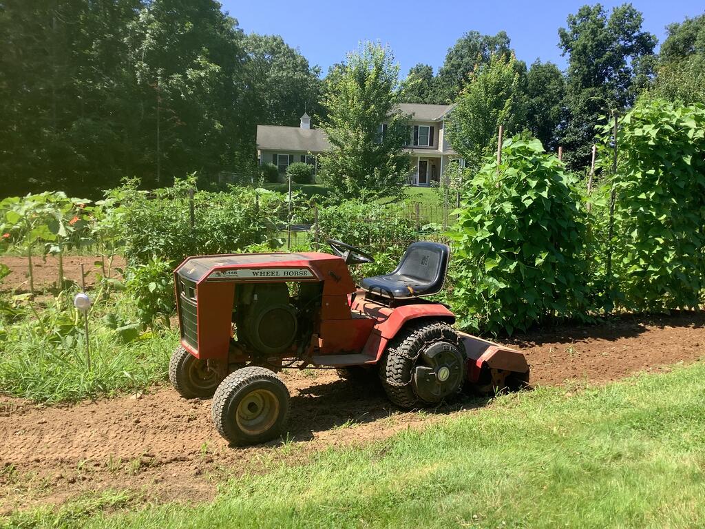

TonyToro Jr. 2,540 #2278 Posted July 23, 2023 Took the C-145 out today for a little rototilling in the garden did a very good job. 11 2 Share this post Link to post Share on other sites
Horse Newbie 7,405 #2280 Posted July 23, 2023 1 hour ago, Sodaking27 said: Out for a morning stroll. @Sodaking27, Is that a 1600 or 1800 ? Share this post Link to post Share on other sites

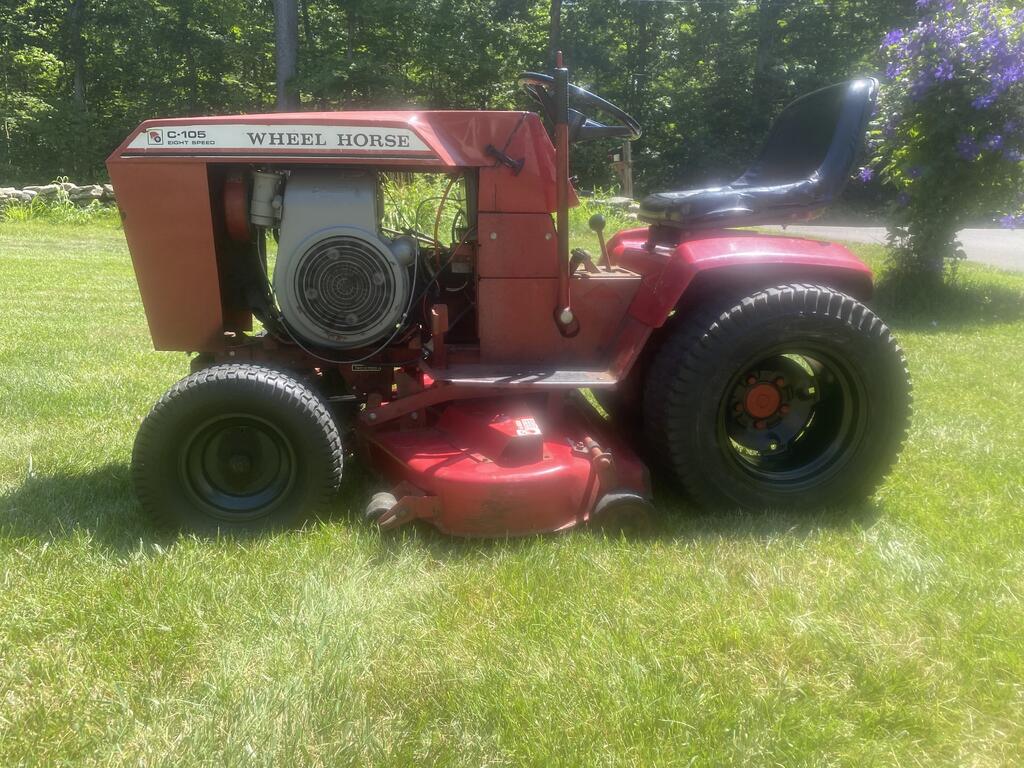

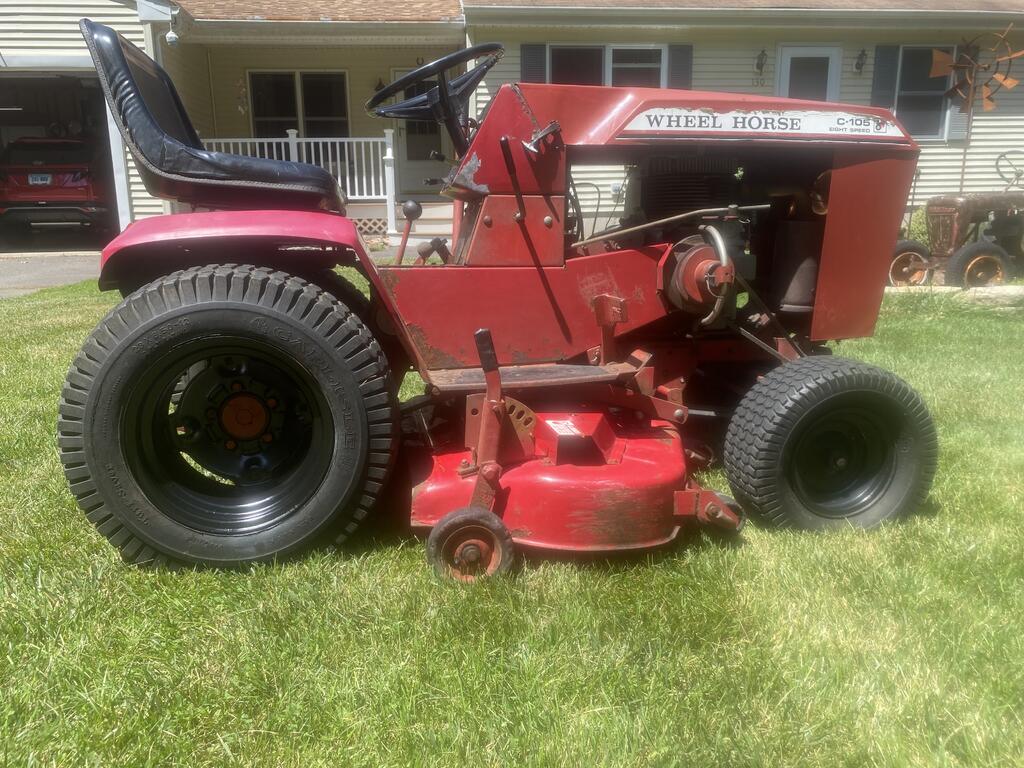

Sparky-(Admin) 26,389 #2281 Posted July 23, 2023 This one is going up for sale next weekend when I get back home. Tried to sell it with a noisy 36RD and mismatched wheels (color) but no interest. Wheels all match now and it has a quiet 42RD. First pic is how it looked a couple days ago. 4 3 Share this post Link to post Share on other sites
Sodaking27 1,358 #2282 Posted July 23, 2023 (edited) 27 minutes ago, Horse Newbie said: @Sodaking27, Is that a 1600 or 1800 ? @Horse Newbie 1800 with a Kohler KT17. So I guess technically it’s a GT 1700 😊 Edited July 23, 2023 by Sodaking27 2 Share this post Link to post Share on other sites
Heatingman 977 #2283 Posted July 24, 2023 12 hours ago, TonyToro Jr. said: Took the C-145 out today for a little rototilling in the garden did a very good job. For a cover crop? Or just to maintain a path? 2 1 Share this post Link to post Share on other sites
ebinmaine 80,757 #2284 Posted July 24, 2023 On 7/22/2023 at 10:17 PM, Tonytoro416 said: my quick and dirty harrow build. I was extremely happy with how well it worked on my driveway Looks good and solid. Did you do a build thread or any other pics somewhere? What's your general procedure for use? We've been using the Mid Mount Grader Blade for driveway maintenance and it does well. I've been thinking about something that would "chew in" a bit first. Share this post Link to post Share on other sites

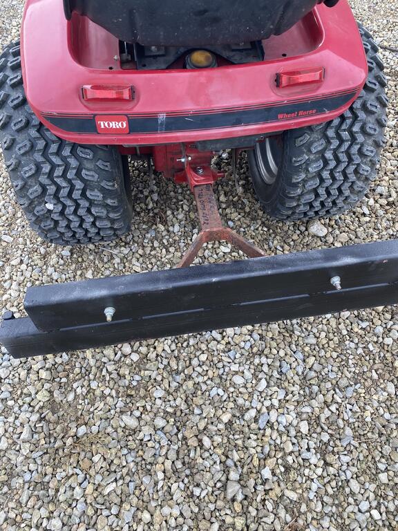

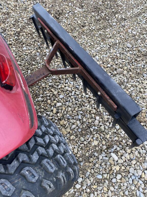

Tonytoro416 1,387 #2285 Posted July 24, 2023 2 hours ago, ebinmaine said: Looks good and solid. Did you do a build thread or any other pics somewhere? What's your general procedure for use? We've been using the Mid Mount Grader Blade for driveway maintenance and it does well. I've been thinking about something that would "chew in" a bit first. I can take some closer pictures this evening. I used a slot hitch cultivator frame. I bolted it to the tube steel. 2 pieces of tube was needed to the barrow would sit straight up and down. Welded those together and welded railroad spikes to the bottom tube. Spikes were from a wooden drag type Harrow that grandpa made years ago. Wood was rotted on it so I used to spikes 1 Share this post Link to post Share on other sites

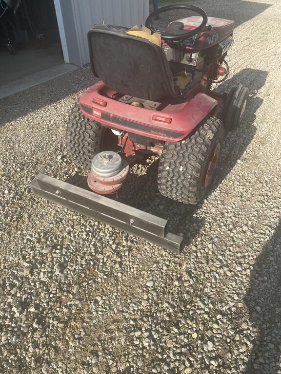

Tonytoro416 1,387 #2286 Posted July 24, 2023 Just now, Tonytoro416 said: I can take some closer pictures this evening. I used a slot hitch cultivator frame. I bolted it to the tube steel. 2 pieces of tube was needed to the barrow would sit straight up and down. Welded those together and welded railroad spikes to the bottom tube. Spikes were from a wooden drag type Harrow that grandpa made years ago. Wood was rotted on it so I used to spikes Ended up using some additional Weight to help as our drive was packed down pretty hard. It is important for the harrow to have some give so it can jump if it snags a rock 1 Share this post Link to post Share on other sites
Tonytoro416 1,387 #2287 Posted July 24, 2023 Plan on using the mid mount grader blade next 1 Share this post Link to post Share on other sites
TonyToro Jr. 2,540 #2288 Posted July 24, 2023 7 hours ago, Heatingman said: For a cover crop? Or just to maintain a path? Just to keep the weeds down on the places we don’t have anything planted. 3 Share this post Link to post Share on other sites
Tonytoro416 1,387 #2290 Posted July 25, 2023 On 7/22/2023 at 10:17 PM, Tonytoro416 said: Finally got time to finish my quick and dirty harrow build. Not anything fancy or pretty but it worked really good. I was extremely happy with how well it worked on my driveway. Of course the hydraulic lift on the 416 makes it really nice I got a few closer pictures for a few that asked. Really is nothing special. I used existing holes in cultivator frame and bolted the harrow to that so I didn’t hack up a good cultivator frame. 1 3 Share this post Link to post Share on other sites

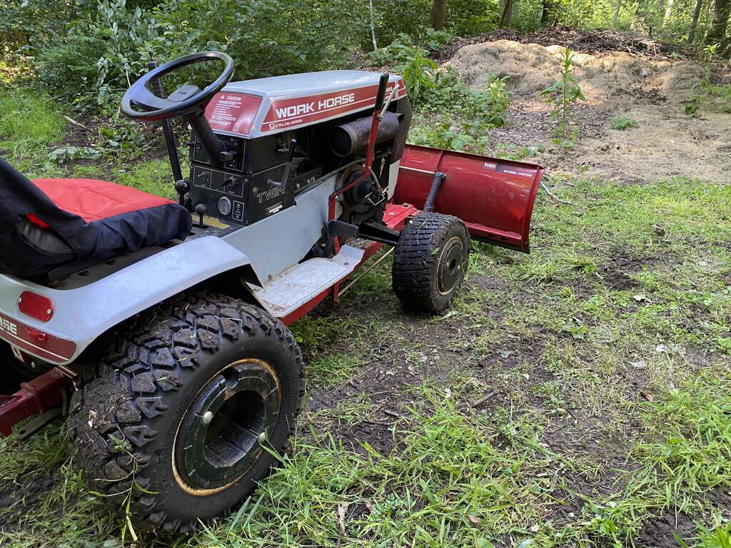

Sparky-(Admin) 26,389 #2296 Posted August 5, 2023 Doing chores with my dedicated plow machine… GT-1600 with a Mag10 swap m 5 4 Share this post Link to post Share on other sites

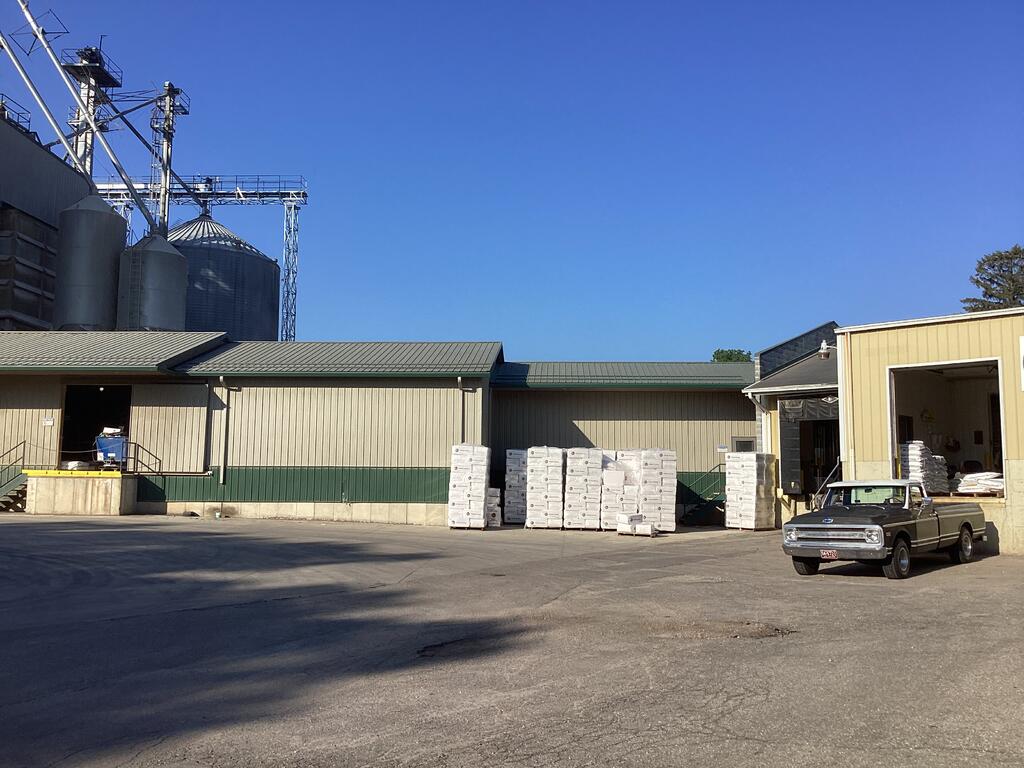

Pullstart 71,286 #2297 Posted August 5, 2023 The Snowmowtractor needs to look complete for Thursday’s car show. It’ll be riding in the back of Ole Smoky my ‘69 C10. This is one of the reasons I went to the feed mill for chicken food, to see how it held up to 6-700 lbs in the bed. Like a champ! 4 6 Share this post Link to post Share on other sites

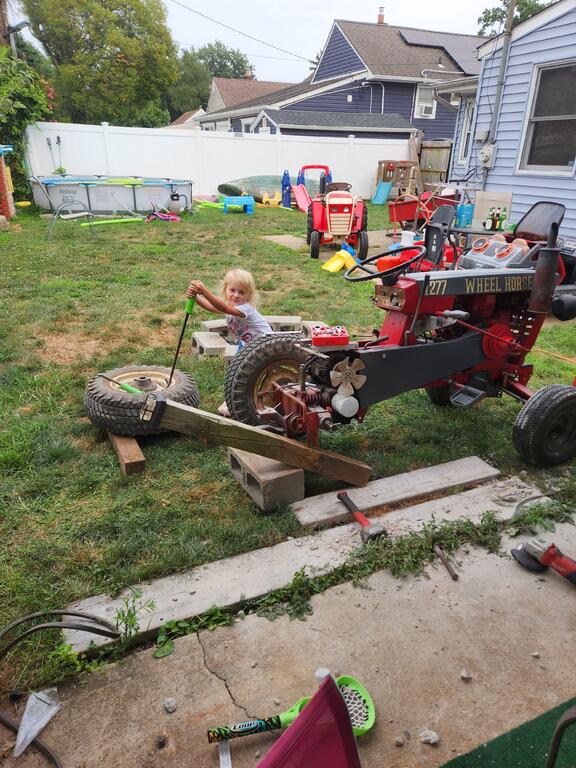

Monstrosity 1,153 #2299 Posted August 5, 2023 Got one of the horrible cement wheel weights out now working on the other one had me a little helper too. 6 2 Share this post Link to post Share on other sites
ebinmaine 80,757 #2300 Posted August 6, 2023 2 hours ago, Monstrosity said: me little helper Got one of the horrible cement wheel weights out. now working on the other one ... Who REALLY did the heavy work here??? 3 Share this post Link to post Share on other sites
