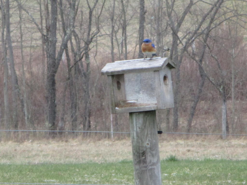

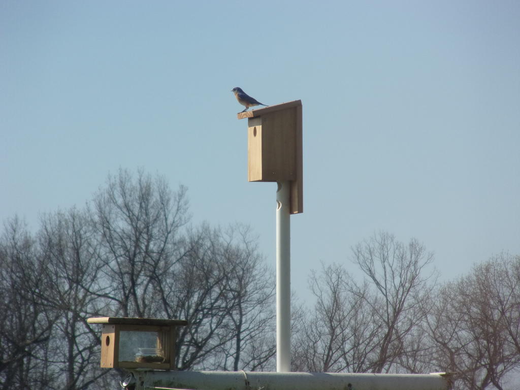

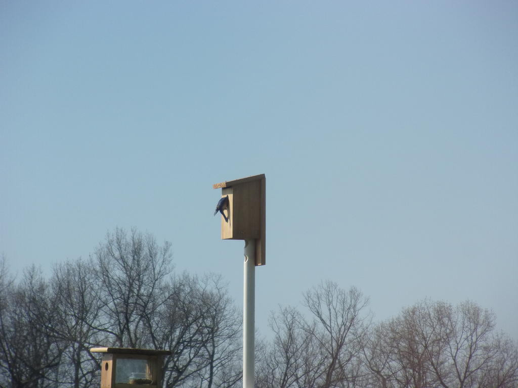

Ed Kennell 47,260 #76 Posted April 9, 2020 Any visitors to Rylee's bird house? I had this guy checking mine this morning, but I haven't seen him since the wind storm blew thru this afternoon. 2 2 Share this post Link to post Share on other sites

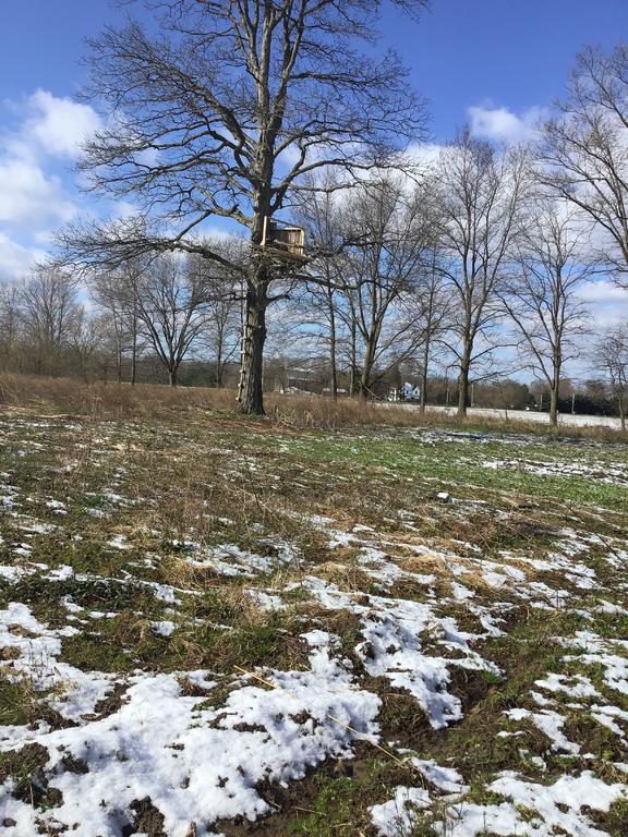

Pullstart 71,207 #80 Posted April 10, 2020 I assume this time of year they are building nests pretty actively? How long might we expect to sit for a bird to be in and out of the house right now? 1 Share this post Link to post Share on other sites

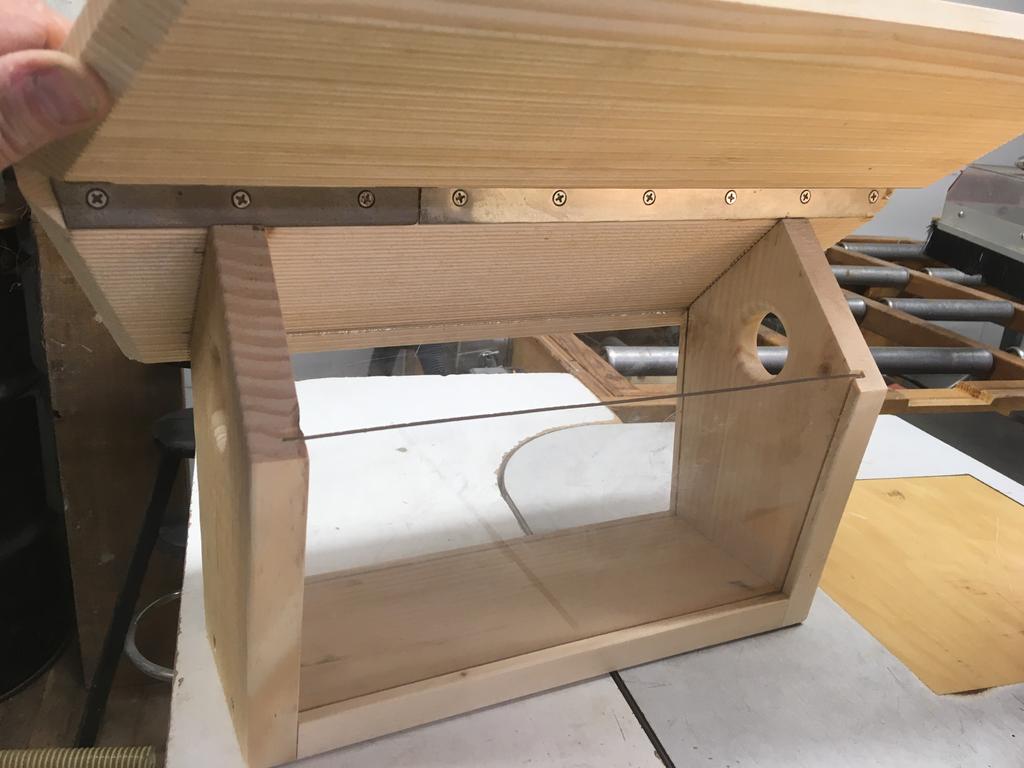

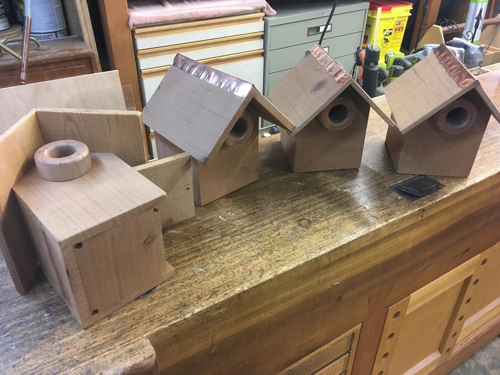

formariz 12,381 #85 Posted April 11, 2020 Did these today . On to a couple of feeders now . Will try to mount them tomorrow since we can’t go anywhere. It will be an Easter project. Hopefully it will be a nice day. 2 Share this post Link to post Share on other sites
pfrederi 21,145 #86 Posted April 11, 2020 51 minutes ago, formariz said: Did these today . On to a couple of feeders now . Will try to mount them tomorrow since we can’t go anywhere. It will be an Easter project. Hopefully it will be a nice day. Nice work what kind of wood did you use.? 1 Share this post Link to post Share on other sites

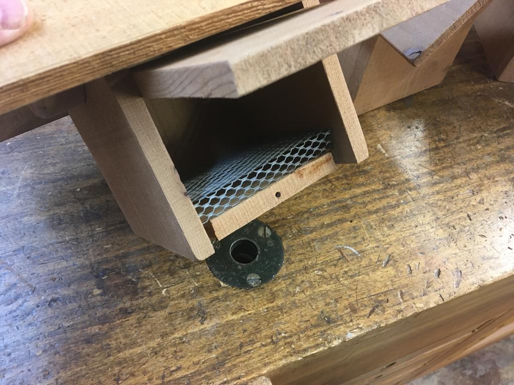

formariz 12,381 #87 Posted April 11, 2020 2 minutes ago, pfrederi said: Nice work what kind of wood did you use.? Thank you. Cedar. I have quite a few cut offs from 12x12 beams left over from a job, so I just re saw them into 1/2 boards. The "donuts"are Santos Mahogany. Hard as a rock, besides a beaver no animal is going to chew through that. Was reading about the issue with the Blowfly larvae so I made the little grate on the bottom to allow them to drop away from nest. I am just not sure that the holes are big enough for that to happen. Share this post Link to post Share on other sites
pfrederi 21,145 #88 Posted April 11, 2020 I made mine out of cedar 3/4'. some are 15 years old but they have begun to split or some one has gnawed on the entry, Share this post Link to post Share on other sites

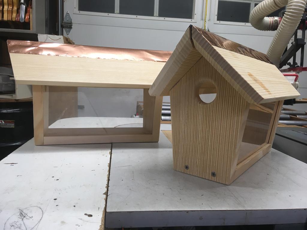

formariz 12,381 #89 Posted April 12, 2020 (edited) 18 hours ago, pfrederi said: I made mine out of cedar 3/4'. some are 15 years old but they have begun to split or some one has gnawed on the entry, Can’t ask for much more than that. Cedar is great for them. Found that roof makes a big difference on their longevity. Large overhangs keep water from inside and from seeping in where sides meet bottom.Making boxes tapered also helps with that. Feeders are done also. Just have to devise some type of latch for door .Have to scout property tomorrow for best spots to place them and houses. Relaxing work making them. Good way to spend day. Edited April 12, 2020 by formariz 4 Share this post Link to post Share on other sites

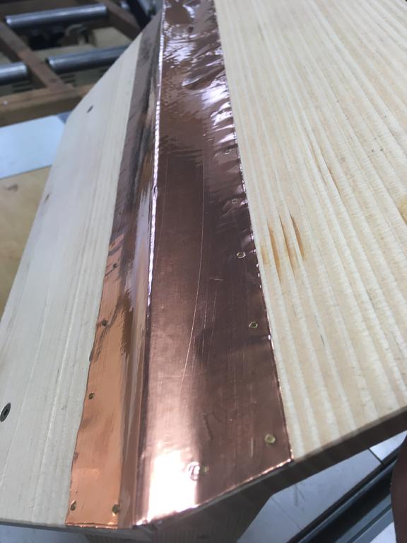

pfrederi 21,145 #90 Posted April 12, 2020 Like the foil over the peak is it copper? How many open close cycles do you think it will last.I get water in my feeder through the peak and hinge may have to try something like you did... Share this post Link to post Share on other sites
formariz 12,381 #91 Posted April 12, 2020 1 hour ago, pfrederi said: Like the foil over the peak is it copper? How many open close cycles do you think it will last.I get water in my feeder through the peak and hinge may have to try something like you did... It’s copper flashing. It has a thin rubber like coating on the back. It should last a long time since I only tack it on the edges with tiny brass tacks. This way when it opens it’s really not flexing much along crease. (photo below). I buy these rolls of copper flashing from Home Depot. They are expensive but many always have some damage on them from being dropped. No one buys those so I just take them to the service desk and ask them to give me a break on them. Always got them for $15 each and they cost a little over $40. Everything around here always gets moss growing on it, the copper prevents that also keeping roof clear if it. 4 Share this post Link to post Share on other sites

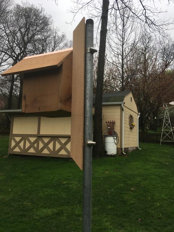

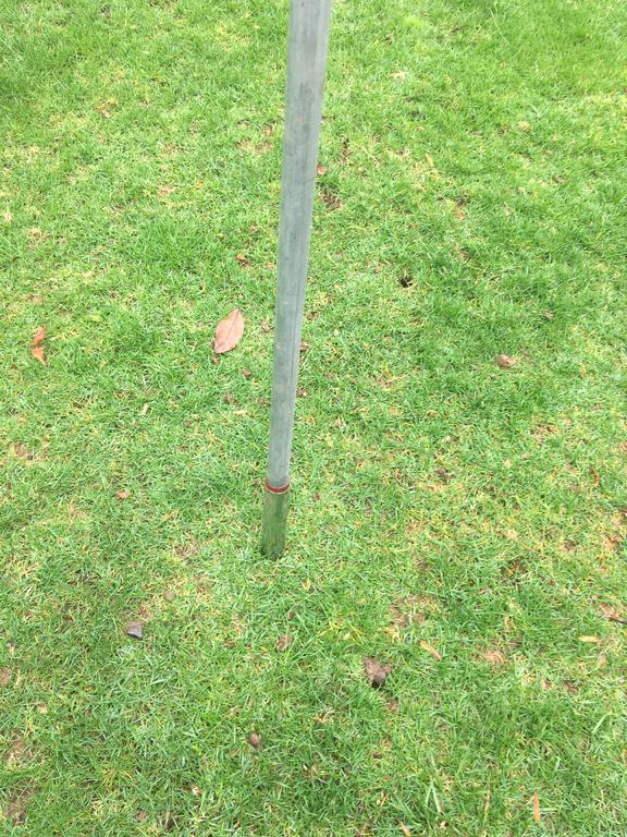

formariz 12,381 #92 Posted April 13, 2020 So this is what I came up with for mounting boxes. Drove a “ sleeve” about 20” into ground. Then used 3/4” galvanized pipe for a post since I had here several 16’ lengths from using them for pipe clamps. This way I can move them easily to another location if these don’t work out. Sleeves also come out easily. 1 2 Share this post Link to post Share on other sites

Pullstart 71,207 #96 Posted April 16, 2020 That gives me more hope, we need to get out and check Rylee’s house! Share this post Link to post Share on other sites
Ed Kennell 47,260 #97 Posted April 16, 2020 I had a pair start to build a nest then the sparrows took over and moved in. Bummer. 3 Share this post Link to post Share on other sites
Pullstart 71,207 #98 Posted April 16, 2020 We’re out watching Rylee’s house... not much action. My tree stand is in the middle of the field. Would that help, or should we find a free standing pole to hang it on? 1 Share this post Link to post Share on other sites
Ed Kennell 47,260 #99 Posted April 16, 2020 Any one of those trees in that open fence row should work if there are any birds in the area. 1 Share this post Link to post Share on other sites
Pullstart 71,207 #100 Posted April 16, 2020 Ok, we’ll keep watching! There were blue jays and other large field birds, but nothing small and blue (yet). 1 Share this post Link to post Share on other sites
