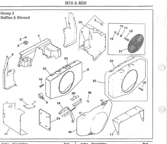

WildmanC120 613 #1 Posted March 17, 2020 (edited) What are the differences between the KT and M series? Will the KT series blower housing fit a M series? Might sound weird but I like the look of the KT series better with the exposed flywheel screen spinning, like a K series over the M series with that giant screen over everything. Edited March 17, 2020 by WildmanC120 Share this post Link to post Share on other sites
pfrederi 19,794 #2 Posted March 17, 2020 Blower housing would fit. Other shields are related to spec number ( Buyer) not Kt vs M. Other wise KT has battery points M has Magneto. Share this post Link to post Share on other sites

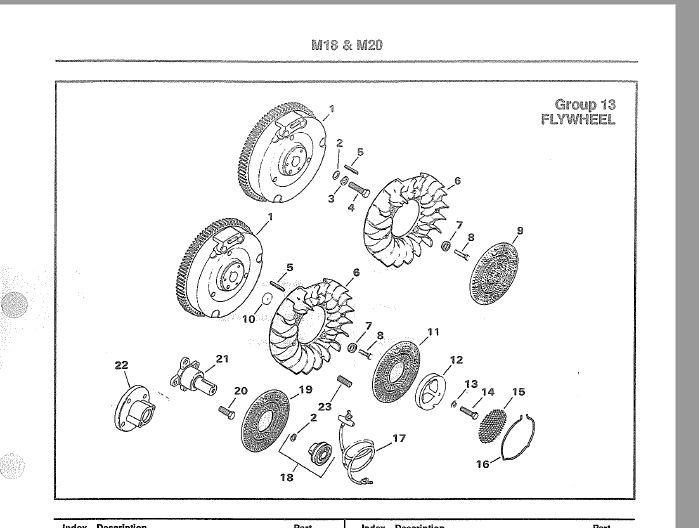

WildmanC120 613 #5 Posted March 17, 2020 9 minutes ago, pfrederi said: Yes Depending on Spec # may have oil pressure port. Cool thanks. Only issue is I don't think the magnum flywheel is drilled for the screen to mount on it Share this post Link to post Share on other sites

pfrederi 19,794 #10 Posted March 18, 2020 Looked at my magnum. Not drilled and tapped...however 4 of the fins have a small 1/4"+/- stud like projection that may be used to hold a screen. hard to see with out removing the outer screen. Not not all M18 had the big outside screen there were a couple of styles of smaller flywheel only screen. 1 Share this post Link to post Share on other sites
WildmanC120 613 #11 Posted March 18, 2020 30 minutes ago, pfrederi said: Looked at my magnum. Not drilled and tapped...however 4 of the fins have a small 1/4"+/- stud like projection that may be used to hold a screen. hard to see with out removing the outer screen. Not not all M18 had the big outside screen there were a couple of styles of smaller flywheel only screen. Thanks for that. I'll have to dig I to it later. Share this post Link to post Share on other sites
