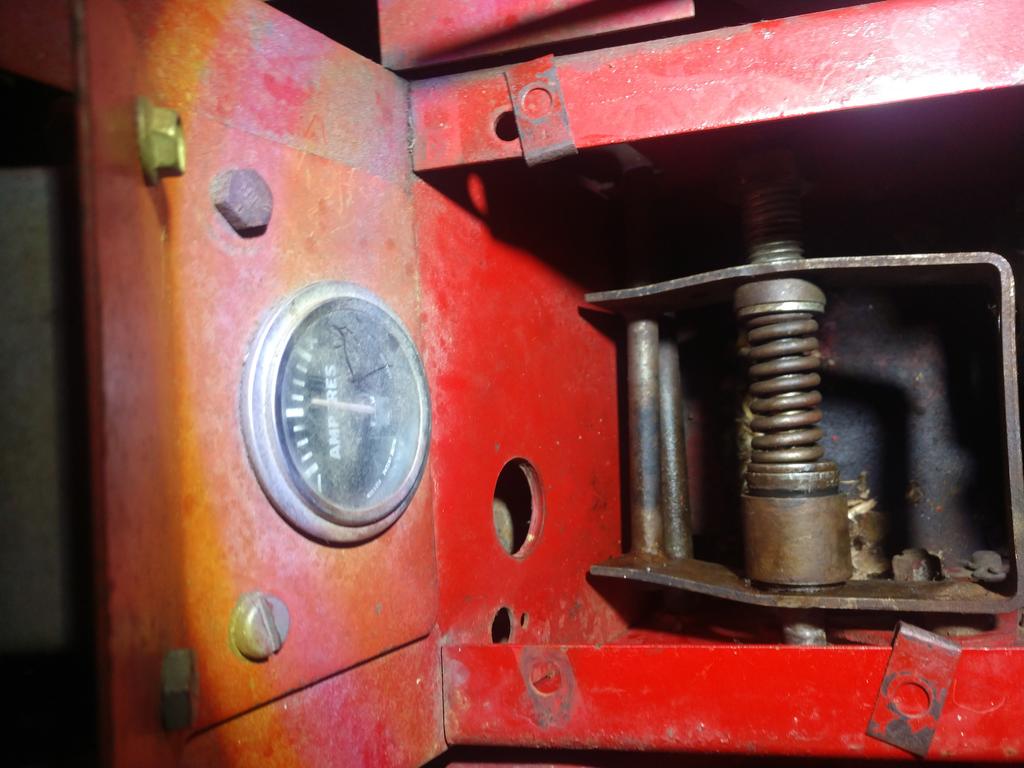

seven 202 #1 Posted March 15, 2020 Looking for help to find the parts list diagram for above. Trying to fix bent control arn bracket Share this post Link to post Share on other sites

WildmanC120 613 #3 Posted March 16, 2020 I think your inital problem is where the red box is. The nit was over tightened attempting to get the hydro lever to stay and not drift speed. As you can see there is a gap between that cup and the flat piece. Those should be tight and move together. That way when you tighten the nut for tension, tension is actually applied instead of that cup staying stationary and only the bracket moving. I had a similar issue and repaired mine with just a little bead of weld. Now will never have to worry about them coming apart again. Share this post Link to post Share on other sites
seven 202 #4 Posted March 22, 2020 Yes what happened was the cup was not moving on the shaft and it bent the frame apart took it all apart straightened it cleaned the shaft and good to go now. Share this post Link to post Share on other sites
