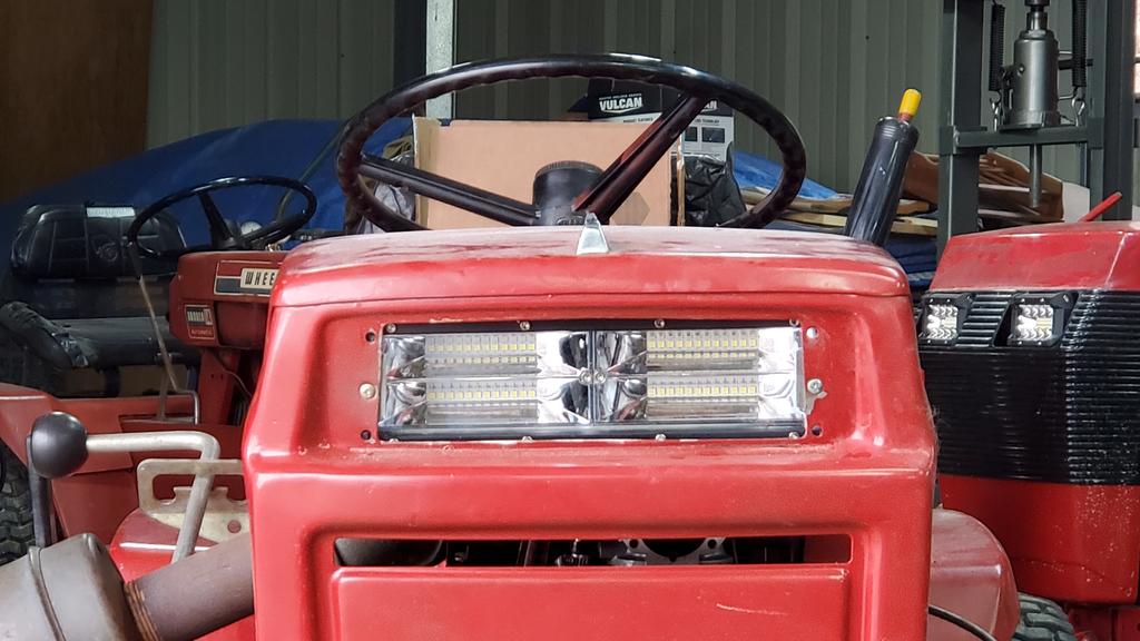

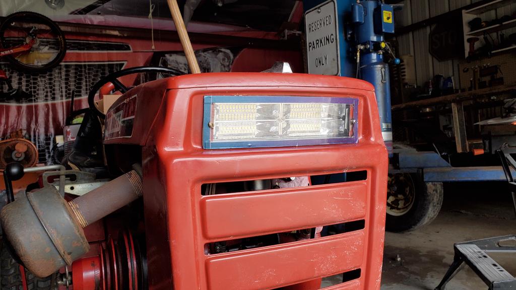

David Ullman 142 #1 Posted March 11, 2020 I put these LED lights in my Raider 12, first is a picture with just the lights, then it didn't look right to me without a lens so I made a lens with plexiglass just to see if it would work. I'll be doing a better job with the lens shortly when I have more time. 7 5 Share this post Link to post Share on other sites

bottjernat1 2,196 #3 Posted March 11, 2020 (edited) Looks pretty good I'd put the factory lens on see how she looks! Edited March 11, 2020 by bottjernat1 Share this post Link to post Share on other sites
David Ullman 142 #4 Posted March 11, 2020 here are the lights 9" LED Light Bar 288W Led Pod Lights Offroad Fog Driving Lights for Trucks Pickup Jeep SUV ATV UTV, 2 years Warranty and I will try the factory lens, I have to borrow one because the one that was on it was in pieces. 3 1 Share this post Link to post Share on other sites

pfrederi 19,875 #6 Posted March 11, 2020 Is there an amp draw level for this light?? The only spec I could see on the Amazon page was 288 watts...that is a huge current draw...24 amps way more than your charging system.... Share this post Link to post Share on other sites
Pullstart 68,878 #7 Posted March 11, 2020 46 minutes ago, pfrederi said: Is there an amp draw level for this light?? The only spec I could see on the Amazon page was 288 watts...that is a huge current draw...24 amps way more than your charging system.... I wonder if that is equivalent to a 288 watt light, or possibly 28.8? My LED light bars on my plow truck are incredibly bright with barely any amp draw! Share this post Link to post Share on other sites
David Ullman 142 #8 Posted March 11, 2020 I'm not sure on the draw, being that they are LED's I don't think they use a lot of power but I haven't used them that much yet. I'll keep you updated later this summer when I have a chance to use them more. Share this post Link to post Share on other sites
lynnmor 8,623 #9 Posted March 11, 2020 Apparently the 288 watts is correct, way too much. Share this post Link to post Share on other sites
troutbum70 858 #10 Posted March 12, 2020 Only way to know for sure is put an amp gauge in line and check draw and then report back with findings. I think it would be equivalent to 288 watts, it should have also gave a lumens ratting. Share this post Link to post Share on other sites
