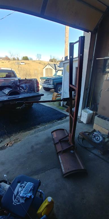

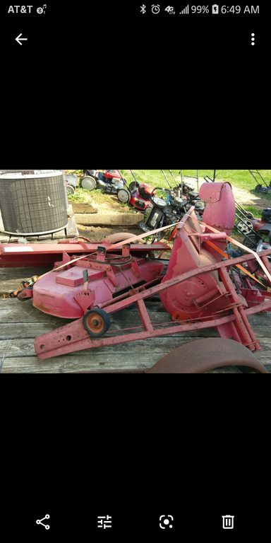

WVHillbilly520H 10,376 #3 Posted March 11, 2020 (edited) Maybe this will help... 1st pic D series plow frame, 2cd 300 series Edited March 11, 2020 by WVHillbilly520H Share this post Link to post Share on other sites
