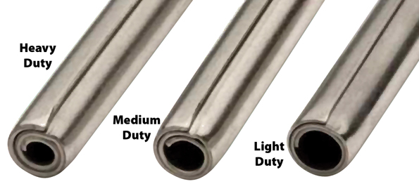

Achto 30,219 #3 Posted March 9, 2020 If you end up drilling the insert & shaft I suggest using a heavy duty roll pin. A roll pin will keep constant pressure in the hole so that it has less chance to wallow out. 4 Share this post Link to post Share on other sites
