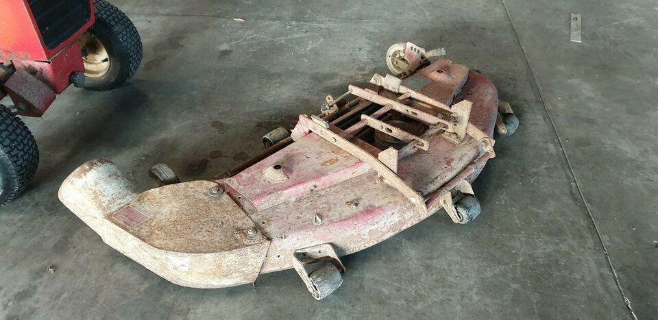

VenetianWheelHorse 19 #1 Posted March 8, 2020 Recently purchased a C-125 with a 48 in. deck. Went onto the Toro website to get the part number for the spindle belt and the drive belt. It appears that Toro gives exactly the same numbers for both the 42 in. AND the 48 in. decks, i.e. # 6738 for the spindle belt, and # 102742 for the drive belt, for both decks. I can, perhaps, understand that the drive belt might be the same for both decks. But the spindle belt? The width of cut is wider in the 48 in. and such increase in width is not due entirely to longer blades (16 in. vs 14 in.) but also, I assume, to the two side spindles being located further apart in the 48 in deck than in the 42 in one. Hence why the same belt? Can anybody who has the 48 in. deck (05-48MS02 or anything similar) confirm whether they are using the 6738 as the spindle belt? Thanks! Share this post Link to post Share on other sites

VenetianWheelHorse 19 #3 Posted March 8, 2020 Thanks Garry. That was fast! And you are right, I missed the fact that further down the page they also give 1594 as belt number for the spindle belt. But it is not clear yet which belt fits which desk. I am hoping that someone who is running a 48 in. side discharge deck can actually confirm which belts they are using. Share this post Link to post Share on other sites
pfrederi 19,002 #4 Posted March 8, 2020 48 SD is 1594 spindle belt. 1 Share this post Link to post Share on other sites
VenetianWheelHorse 19 #5 Posted March 10, 2020 @ gwest_ca-(File Mod) @ pfrederi Thank you both for your reply, but now scratching my head furiously! The original belt, as given by Toro's, i.e. # 6738, appears to have a length of 86 and 1/8 inches, while the one replacing it, i.e. # 1594, appears to have a length of 107 and 1/4 inches. That's quite a big difference in length. What's going on? Share this post Link to post Share on other sites
gwest_ca-(File Mod) 11,757 #6 Posted March 10, 2020 6738 is the spindle belt for the 42" deck Click on the picture Your deck in the original post looks like a 48" because the cut height adjuster is on the left side. The height adjuster is on the right side of the 42" decks. Decks are sized by their width of cut - not the width of the deck. The belts we use for most applications are sized like fractional horse power belts for small electric motors. 1/4hp to 3/4hp - why they are call fractional hp belts. The belts we need are designed for higher hp and if the belt runs over a flat idler it must be designed to withstand that reverse bend for a reasonable lifespan. Gates is a national make here and have a green covered belt that meets this requirement. Garry 1 Share this post Link to post Share on other sites
gwest_ca-(File Mod) 11,757 #7 Posted March 10, 2020 Here is an original manual for the 48" deck which may be different than your model but the belts will be the same. What uses what is clearly shown unlike the online parts lists. Click on the piture. Same manual number as the 42" above but I may have just posted the appropriate pages for each size of deck to reduce file size. Garry 1 Share this post Link to post Share on other sites
