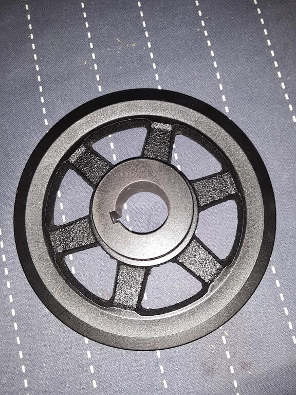

Oldskool 6,678 #210 Posted June 18, 2020 The new engine pulley should be here tomorrow. The new fuel pump should be here on Tuesday, but still waiting for the epoxy for the electric clutch. I may get a ride this Summer yet. 1 Share this post Link to post Share on other sites

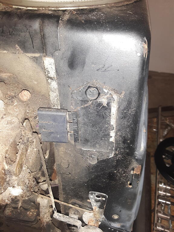

Pullstart 71,207 #215 Posted June 28, 2020 There should be a voltage regulator on the magnum up on the left front of the engine when it’s in the frame. On the blower shroud, left of the carb. Anything there? Wires? 1 Share this post Link to post Share on other sites
Oldskool 6,678 #216 Posted June 28, 2020 8 hours ago, pullstart said: There should be a voltage regulator on the magnum up on the left front of the engine when it’s in the frame. On the blower shroud, left of the carb. Anything there? Wires? Would this be it? There is a white wire on top and bottom and a purple in the middle. 2 Share this post Link to post Share on other sites

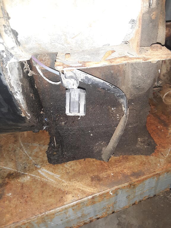

Oldskool 6,678 #217 Posted June 28, 2020 Here is the other plug. 3 whites and a purple. Share this post Link to post Share on other sites
953 nut 69,146 #218 Posted June 28, 2020 3 minutes ago, Oldskool said: Would this be it? There is a white wire on top and bottom and a purple in the middle Yes, the purple wire will go to the "R" terminal of your ignition switch. Since this is a Magnum the rest of the wiring should be the same as a GT-14, just bypass the voltage regulator mounted on the GT-14 and ignore the oil sentry on the engine (unless you want to do some extra wiring). 1 Share this post Link to post Share on other sites
19richie66 17,932 #219 Posted June 28, 2020 (edited) The two white wires at the regulator come from your stator. The purple wire between them comes snakes through the fan shroud and comes out at the bottom with another white wire and meets the two wires from the oil sensor in the bottom of the pan. That purple wire feeds 12 volts to your regulator. The two wires coming from the oil sender (in the block) I just cut off. The white wire coming from behind the flywheel cover with the purple wire is your kill wire for grounding out the coil and shutting down the engine. I ran mine to one side of a push button switch and the other side of the switch to battery ground. It will shut it off when you push and hold the button down. I just have to remember to turn off the key. 😁 Edited June 28, 2020 by 19richie66 1 1 Share this post Link to post Share on other sites
