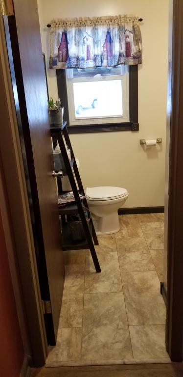

Pullstart 69,569 #35 Posted February 27, 2020 11 hours ago, gt14rider said: Well it took me 8 or 9 years to finish the bathroom . Now rip off /install sheetrock and insulation in up stairs bedroom . Why do bathrooms take so long? At the old house we counted 686 days. I didn’t keep as good of records with this one, but I don’t think I stalled long enough to hit my goal average again.... but I bet it was close! 2 Share this post Link to post Share on other sites
stevasaurus 23,662 #36 Posted February 27, 2020 Bathrooms are the 2nd most expensive room in the house and much thought must be had on the throne of knowledge before attacking the issues. 1 1 2 Share this post Link to post Share on other sites

JCM 11,077 #39 Posted February 27, 2020 I will be the first to admit the last thing I want to do after 44 years in the trade is Plumbing in our home. In 2008 when we purchased it I went hog wild with renovations for roughly 4 years and petered out, way more important things to do outside. Patti recently asked what my plans were for the 2 water lines and 1 drain line that have yet to find a home in the 2nd floor bath. My intentions were for a whirlpool tub and I keep telling myself I will do it. At least the water closet, lavatory and shower stall are in but still no whirlpool,but I did leave access to be able to slide it in from the loft behind it.She tells me to just cap those lines off and forget about it. So what do you guys think, cap it or finish it, and keep in mind I am looking for just 1 or 2 more tractors possibly at the Big Show in June if we can pull that off. 1 Share this post Link to post Share on other sites
ebinmaine 78,154 #40 Posted February 27, 2020 13 minutes ago, JCM said: So what do you guys think, cap it or finish it, and keep in mind I am looking for just 1 or 2 more tractors possibly at the Big Show If you've been without it this long I'd cap it.... 1 or 2 more per .... Year? Month? 1 Share this post Link to post Share on other sites

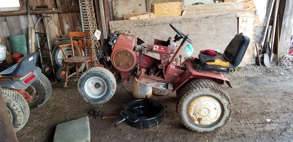

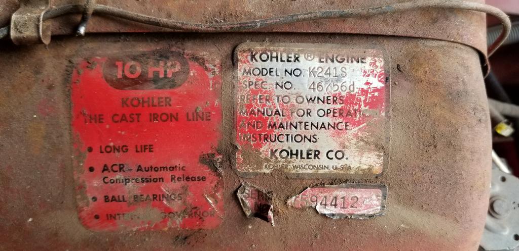

gt14rider 1,149 #43 Posted March 30, 2020 Well took some time and looked at this and hooked up a battery, hit it with ether, bam fire right up. That's the good news, cleaned of data plate and look what I found . Never looked at it really good 1 1 Share this post Link to post Share on other sites
953 nut 65,068 #44 Posted March 30, 2020 (edited) 1 hour ago, gt14rider said: cleaned of data plate and look what I found I would rather have a running No Name10 than a dead No Name 14. Edited March 30, 2020 by 953 nut fat finger 2 1 Share this post Link to post Share on other sites

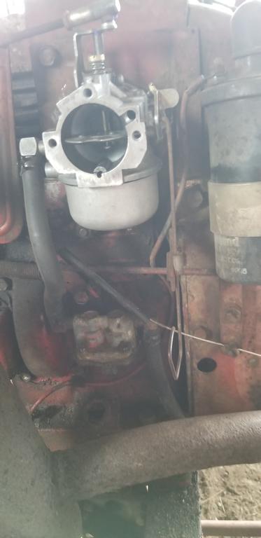

gt14rider 1,149 #45 Posted March 31, 2020 Not complaining, took carb off, pretty clean, took the tank off, it was drained and clean. So replaced fuel lines and filter. Working on new battery cables and oil change. Pics later. Are internet went down last Thursday, don't have good cellphone service so pic take for ever to load 1 Share this post Link to post Share on other sites
WHX?? 55,972 #46 Posted March 31, 2020 Just gonna say it never ceases to amaze me how often they fire right up after many years of sitting without even dropping the float bowl! Yes check that oil and change dirty or not. Share this post Link to post Share on other sites
gt14rider 1,149 #47 Posted March 31, 2020 On it. Oil change, kerosene flush on tranny, grease zerks, I disassembled, cleaned and reassembled carb, waiting on gaskets. Tires still have to be drained out of winter air and replace with spring air. 1 1 Share this post Link to post Share on other sites

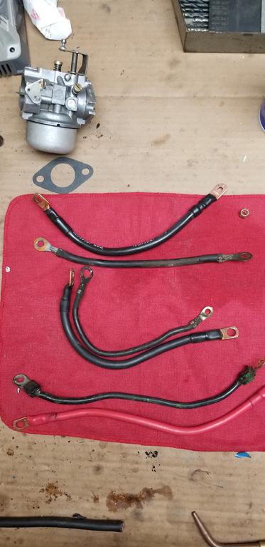

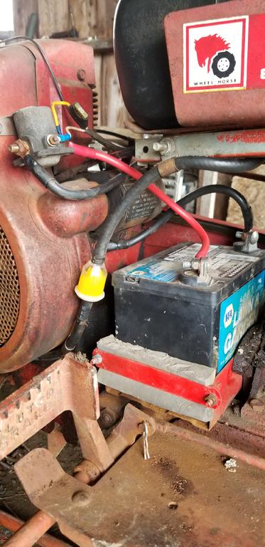

gt14rider 1,149 #49 Posted April 1, 2020 Got the fuel lines and filter replaced. Cleaned carb,Made up new battery cables and started cable, changed oil, 15/40 will run for short time, will replace with 30w. Started right up, purrs like a kitten. Shifted in all the gears, hi/low range, ran on jackstands. Will run a couple kerosene flushes and couple gear lube flushes. Still no internet so pics will follow. 3 2 Share this post Link to post Share on other sites
