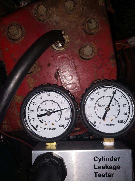

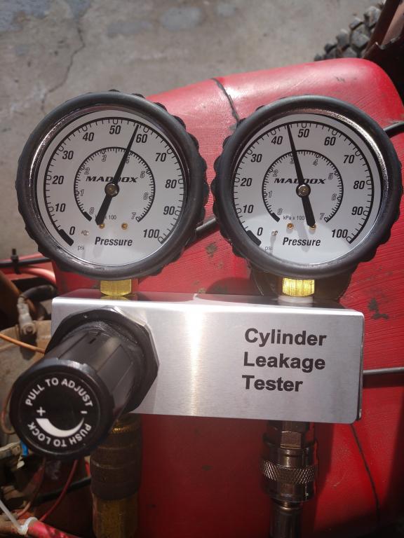

troutbum70 858 #1 Posted February 24, 2020 Picked up a new leak down tester at harbor freight yesterday. Done first test on cold engine then next two after a good warm up. The one at a little over 50 psi cold, then after warm up 60 psi first and 70 last. Had small leakage at heard coming out fill tube and small leakage coming out carb, thinking that might be improved with a valve adjustment. What I did find also is the butterfly on throttle shaft is only opening about a 1/4 of the way. So that is not good. 1 Share this post Link to post Share on other sites

troutbum70 858 #5 Posted February 25, 2020 More interested in what others with way more experience than I think about the numbers I got on leak down test. Carb needs rebuilt for sure. Watched your YouTube video of your wife out there hammering on the snow, my wife wants no part of that she hates the cold. 2 Share this post Link to post Share on other sites

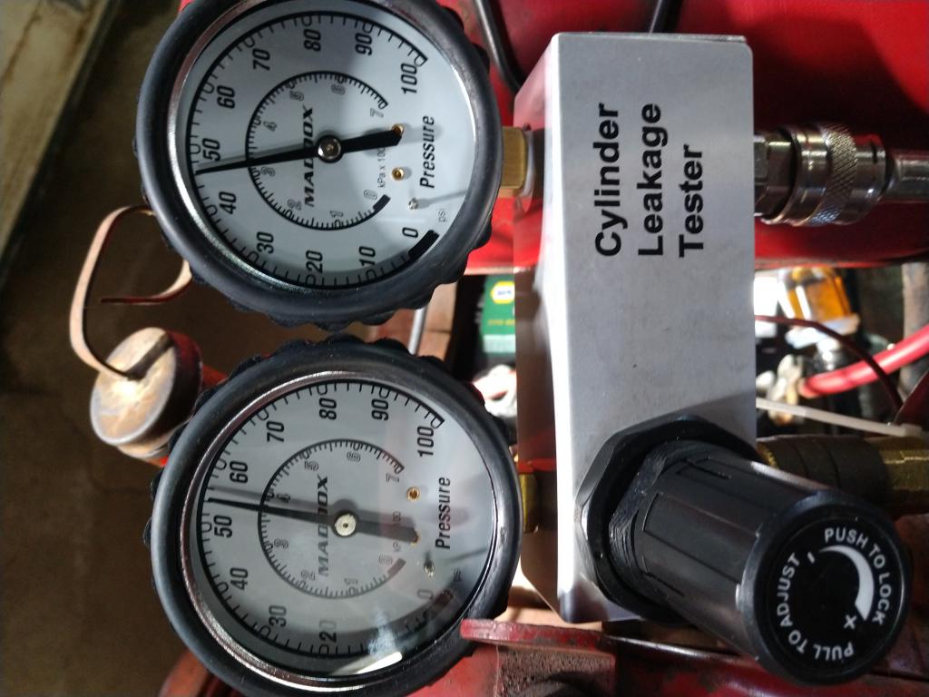

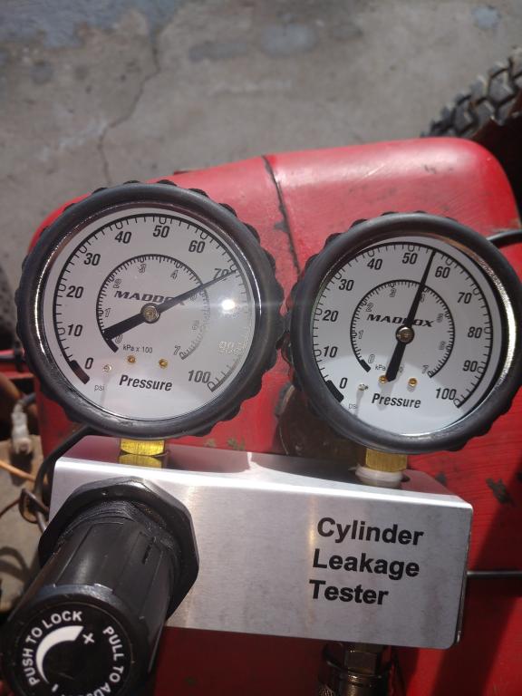

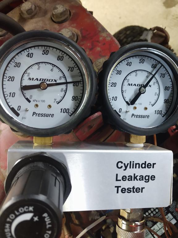

troutbum70 858 #14 Posted February 26, 2020 Follow up today on leak down test, made sure it stayed at TDC. First one cold and then engine block around 100 degrees, nut much difference between the two. The leakage sounds equal between intake valve and crank case at fill tube, if any at exhaust I could not hear it over the other two. Is it possible the intake could be improved with valve adustment? Is the loss enough to effect operation of the engine? Top reading is cold engine. Share this post Link to post Share on other sites
lynnmor 8,076 #15 Posted February 26, 2020 Of course the valves should be adjusted correctly, but any clearance should give a valid test. It is normal to have leakage past the rings because they all have a gap, but there should be next to none thru the valves. Check for clearance on the intake valve and if there is some, I would do a valve job. Share this post Link to post Share on other sites
Cvans 1,009 #16 Posted February 27, 2020 If your hearing leakage through the intake then as stated I would check the intake valve clearance and then the face of the valve and the seat. Share this post Link to post Share on other sites
