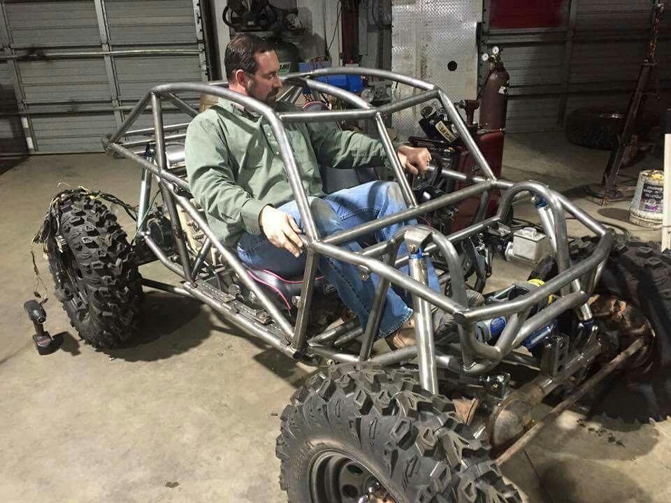

wallfish 18,857 #4 Posted February 20, 2020 Me Like You'd have to lock the pinion gears inside the WH trans differential to use it like that. Did you build that little tube frame? 1 1 Share this post Link to post Share on other sites

Shed 371 #6 Posted February 20, 2020 No havent started yet I wanted to make sure I can get it to work on paper first lay stuff out then the tube frames easy just 1 inch hot rolled seam all tube is fine for this thing 1 Share this post Link to post Share on other sites
