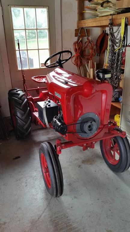

Oldskool 6,678 #31 Posted February 20, 2020 Maybe I should cut a key slot in them and put some AG tread to 'em and make a tractor from scrap? Share this post Link to post Share on other sites
SylvanLakeWH 32,703 #32 Posted February 20, 2020 Very cool! I vote for a low boy cart with simple axle rod and bearings as posted above... Maine is timber country... maybe go for a scale model of the old big wheel log hauler carts only with a flat bed to actually haul stuff around... 2 Share this post Link to post Share on other sites
WHX?? 58,307 #33 Posted February 20, 2020 Hang on here fellas before you go cuttin and butcherin for chandeliers. .. any chance those could be used to resto a senior??? Just thinking out loud here... looks close but I just got off my rocker.. Share this post Link to post Share on other sites
Oldskool 6,678 #34 Posted February 20, 2020 4 minutes ago, WHX24 said: .. any chance those could be used to resto a senior??? Just thinking out loud here... looks close but I just got off my rocker.. A senior? Share this post Link to post Share on other sites
SylvanLakeWH 32,703 #35 Posted February 20, 2020 18 minutes ago, Oldskool said: A senior? One of these... 2 1 Share this post Link to post Share on other sites
The Tuul Crib 7,354 #36 Posted February 20, 2020 Yea but it looks like the senior has less spokes. Alot fewer . 2 Share this post Link to post Share on other sites
