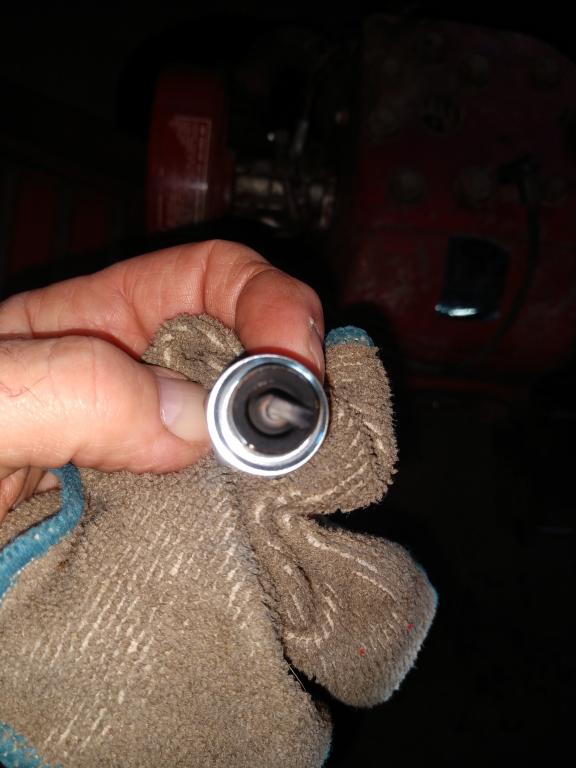

troutbum70 858 #1 Posted February 19, 2020 Put a new plug in today took a 2 mile ride half of it up a pretty good hill. Plug got quite black around the edge, tranny pump temp was 141 degrees when I got back. I noticed a tiny bit of ATF bubbling around the fill plug like it had air pressure in it, and did find when the push is in the drive position I can push it a little bit in both directions maybe a little less effort in reverse. So I am thinking acceleration valves need attention, any other thoughts? And I also did find the throttle shaft is sucking air. I have decided to nick name this tractor stinky because the exhaust stinks so bad, which I hope goes away after issues are fixed. 1 Share this post Link to post Share on other sites
ebinmaine 77,327 #2 Posted February 19, 2020 I can't comment on the transmission question but that plug looks like it might be running just a leeeettle bit rich. 1 Share this post Link to post Share on other sites
troutbum70 858 #3 Posted February 19, 2020 I agree but when adjusting the settings that's where it seems to run the best, but with the throttle shaft sucking air it's hard to get it right I am sure. Plus the secondary jet is not sealing properly as I can turn it all the way in and the tractor will spit and sputter but continues to run. Share this post Link to post Share on other sites
tom2p 2,394 #4 Posted February 19, 2020 the plug tip / electrode and top of the porcelain is not dark ( sorta / kinda tan ... not tan but some other color ) Share this post Link to post Share on other sites

ebinmaine 77,327 #6 Posted February 20, 2020 3 hours ago, troutbum63 said: I agree but when adjusting the settings that's where it seems to run the best, but with the throttle shaft sucking air it's hard to get it right I am sure. Plus the secondary jet is not sealing properly as I can turn it all the way in and the tractor will spit and sputter but continues to run. If it's happy there I'd leave it set. It may change after you fix the carb. 2 hours ago, tom2p said: sorta / kinda tan ... not tan but some other color Share this post Link to post Share on other sites
troutbum70 858 #7 Posted February 20, 2020 Yes I don't understand why just the outside of the plug is so black, when the electrode and all look like a pretty good burn. And I will clean up the filler tube and clean the vent it needed. I may get one of the carbs from Norman and see how that goes. Share this post Link to post Share on other sites

lynnmor 8,623 #10 Posted February 20, 2020 11 hours ago, troutbum63 said: Yes I don't understand why just the outside of the plug is so black, when the electrode and all look like a pretty good burn. And I will clean up the filler tube and clean the vent it needed. I may get one of the carbs from Norman and see how that goes. The perimeter of the plug is about the same temperature as the head and the color of it is a good indication of fuel mixture, but only if you know how to read plugs, do a long run and a quick shut down. The electrode area runs hotter, plugs have different heat ranges for various applications. The electrode area needs to run hot enough to burn off deposits, but not so hot that pre-ignition takes place. To control electrode temperature, plugs have different lengths of the path from the tip to the head. Unless you have a modified engine, there is no need to change plug numbers, just adjust or repair the carb. My guess is that your idle mixture screw is way off or that circuit has been damaged from over tightening the screw. Unless the throttle shaft has an extreme amount of wear, there isn't enough air bleeding in to upset the mixture at high speed. I would start from scratch and set the mixture screws per the manual. 1 Share this post Link to post Share on other sites

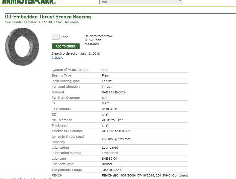

oliver2-44 11,212 #18 Posted February 20, 2020 You can also get those brass washers from the grey drawers of Hillman parts at you local hardware store. 1 Share this post Link to post Share on other sites
