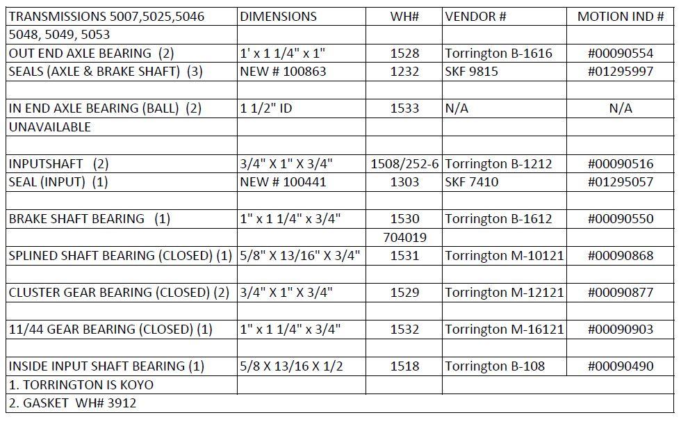

pfrederi 19,944 #4 Posted February 18, 2020 (edited) 5053 Bearings and seals Edited February 18, 2020 by pfrederi 3 1 Share this post Link to post Share on other sites

ebinmaine 77,518 #9 Posted February 24, 2020 6 minutes ago, Palskidoo said: Ok, I am finally getting back to working on this transmission. I am going to be ordering the gasket and probably the outer axle seals. Do you guys have any other suggestions? Is one of the needle bearings or other seals a good candidate for replacement? thanks While you have it split it's not a bad idea to do wheel bearings and seals. All parts can be had from our vendor Wheelhorse parts and more. Share this post Link to post Share on other sites
WHX?? 55,198 #10 Posted February 24, 2020 (edited) 35 minutes ago, Palskidoo said: needle bearings or other seals a good candidate for replacement? Fit the axles or shafts into their respective bearings and if you can move them more than 1/32" or even 1/64 I would replace them. Easier to do it now when you have it split. Edited February 24, 2020 by WHX24 Share this post Link to post Share on other sites
pfrederi 19,944 #11 Posted February 24, 2020 For about $7 each I always replace the axle needle bearings when it is split....My time is worth something .maybe not much but something Besides when needle bearings fail like this bad things happen.... Share this post Link to post Share on other sites
