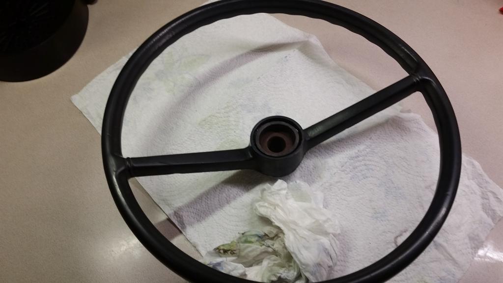

WHX?? 53,370 #1 Posted February 17, 2020 I know this has probaly been discussed before but what is the best way to put a shine on steering wheels, shifter knobs and the like? This wheel cleaned up rather nicely but now to put the shine back on it. A buffing wheel comes to mind?? 1 Share this post Link to post Share on other sites

The Tuul Crib 7,340 #4 Posted February 17, 2020 Polishing wheel and compound? 1 Share this post Link to post Share on other sites
Bigtrx34 321 #5 Posted February 17, 2020 I like lambs wool buff wheel at low rpm and light compound. 3M polish not cutting compound is my go to. 2 1 Share this post Link to post Share on other sites
76c12091520h 4,003 #6 Posted February 17, 2020 A small 2-3 inch buffing wheel in a drill or small hand held cordless buffer works great with some rubbing compound to bring the shine back. A heat gun also does a great job of bringing the color back out, just keep the gun moving and don't get too close; once you get a little heat built up in the area you're working on the color will actually come back out as the oils in the plastic re-flow. 1 2 Share this post Link to post Share on other sites

prondzy 3,889 #8 Posted February 19, 2020 (edited) Wetsand 1000 grit plus and some plastic polish is about it Jim. If you polish it on the tractor you can pretend your diving it in the garage, just dont let the wife see ya! Edited February 19, 2020 by prondzy 1 Share this post Link to post Share on other sites
WHX?? 53,370 #9 Posted February 20, 2020 I picked up a 4 in buffing wheel & arbor for a drill and some polishing compound for plastic at ACE. I think they saw me coming on the polish. It was in a old package and looked like it was ther since 1932! It was useless so I grabbed some mothers aluminum mag polish off the shelf. It didn't do the worse job. Will work it some more and try some other polishes off the shelf. Will also try the heat gun trick. Share this post Link to post Share on other sites
