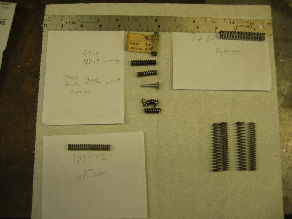

pfrederi 21,274 #1 Posted February 10, 2020 Trying to gt the Hydrogear in my GT14 fixed up. Like so many Hydrogears the acceleration valve springs were toast. I had looked in the Sunstrand manual and the two springs (inner and outer) are listed as 7052 (inner small) and 7264 (Outer large). (same listing in Charger and Electro tractor parts manuals) Neither one are available from Toro. Lowell listed repros but found the small inner one didn't come out right. He is reworking them. Wanted to get the tranny back together and was looking at the GT-14 parts manual. It listed the same big spring part number but the smaller inner spring is listed as 9215 which is still available... for over $30 each. Bit the bullet and ordered them. Look to be correct. I do not have a whole complete spring from a Charger Electro available for comparison. Can any one measure one that is complete??? Since all the other parts of the acceleration valve are the same between a GT-14 and other hydro gears I do not see why these 9215 couldn't be used in Charger/Electro hydro gears. You can see in the picture the coil size and thickness is the same as the fragment I have from a Charger. The 103265 spring is from a piston to piston hydro. Anyone know why they used a different part number for the GT-14s??? 2 Share this post Link to post Share on other sites

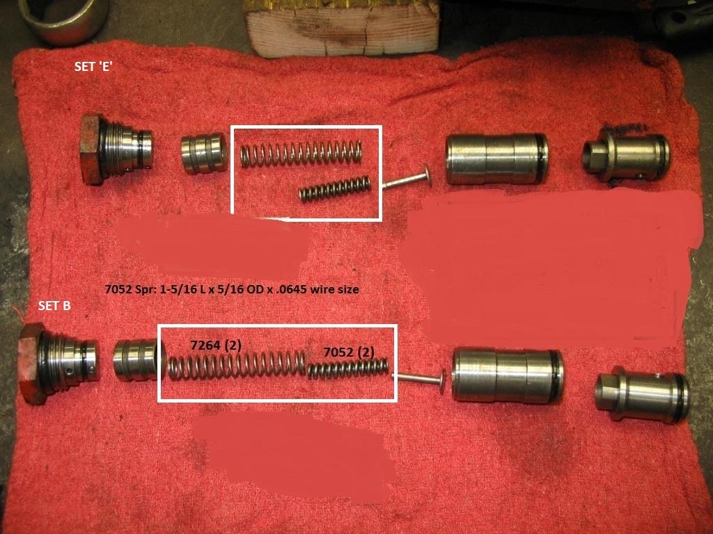

daveoman1966 3,884 #2 Posted February 10, 2020 This is from an old .jpg file.... Spring wire size is noted. 2 1 Share this post Link to post Share on other sites
pfrederi 21,274 #3 Posted February 11, 2020 20 minutes ago, daveoman1966 said: This is from an old .jpg file.... Spring wire size is noted. Dave Thank you so much !!! I will measure my 9215 in the morning!!! 1 1 Share this post Link to post Share on other sites
pfrederi 21,274 #4 Posted February 11, 2020 Some interesting variances. The 9215 spring is 1.24 inches long vs the 7052 Dave measured 1.3125 The 9215 is slightly heavier wire .069 vs .0645 9215 is slightly bigger around .285 vs .265 Both seem to have 12 coils. Other interesting stuff. I measured some of the pieces I have from broken springs. They are slightly different diameter and wire thickness than either the above.... The 9215s are going in the GT-14 hopefully it will work out... 1 Share this post Link to post Share on other sites
