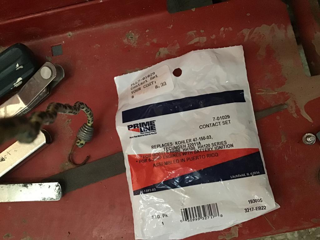

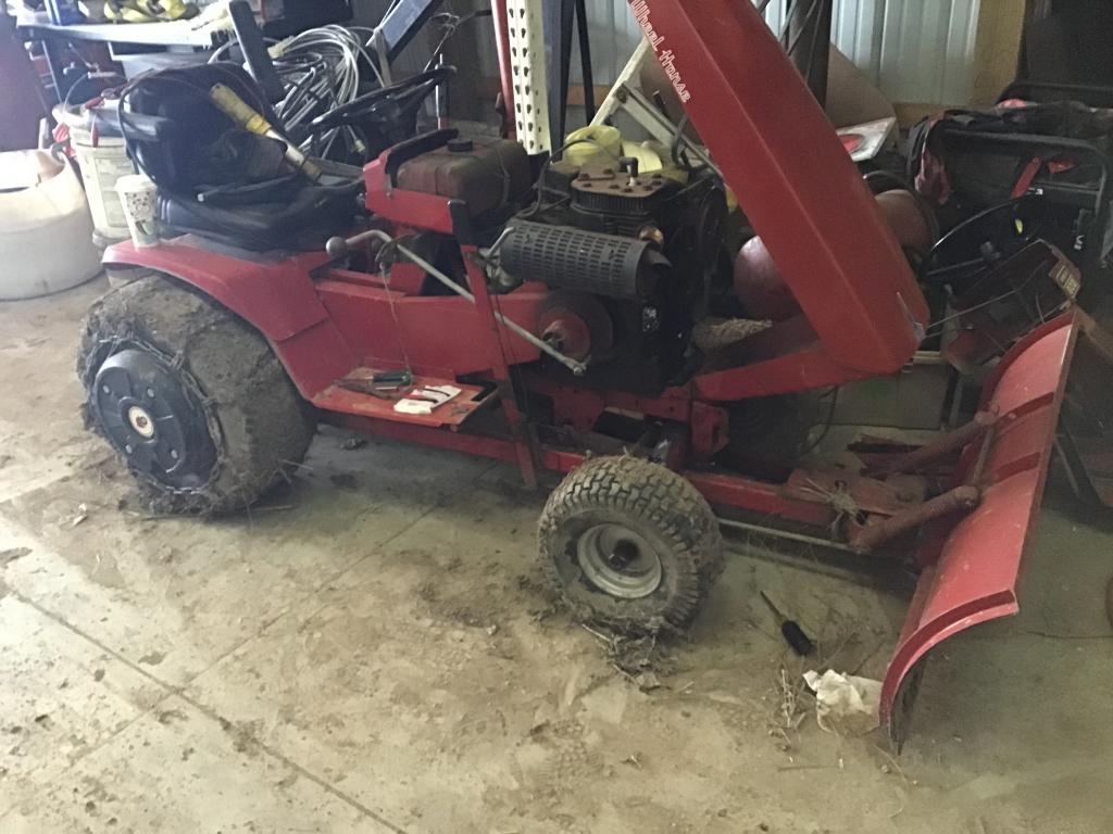

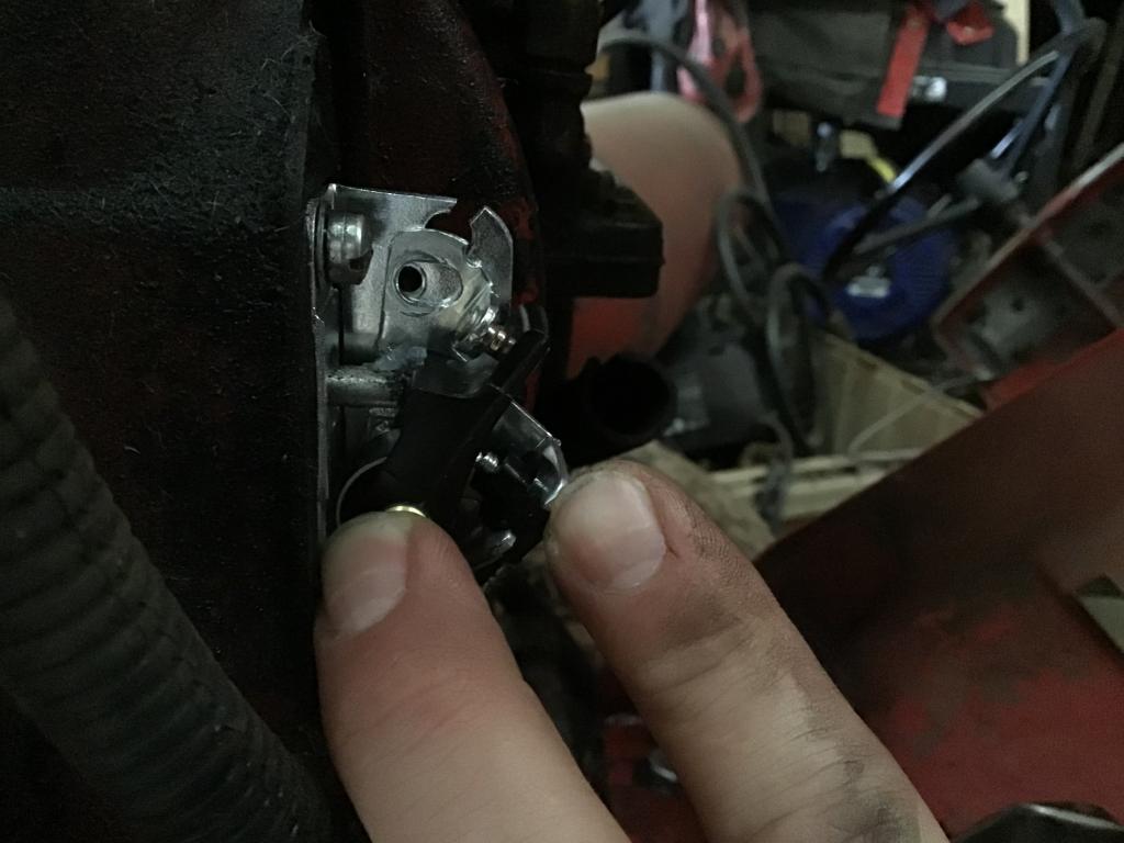

Pullstart 68,780 #1 Posted February 10, 2020 I am replacing the points on Stormy today. I left some snow in the drive to hopefully plow a bit. I use these points from the local Parts Plus in all my Kohlers that need service work, but for some reason this set doesn’t align well. See the set screw hole, it isn’t in line with the slot. Setting my gap at .020”, it grows to about .025” when I tighten the screw! Share this post Link to post Share on other sites

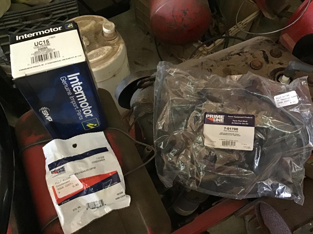

Pullstart 68,780 #2 Posted February 10, 2020 I was able to open the slot with a high speed pencil grinder and set my gap. I am loosing spark as it rolls over. The parts store had a coil, condenser and new plug wire for me, we’ll throw a couple parts at Stormy and see if it’ll fire up to play a bit in the snow. Share this post Link to post Share on other sites

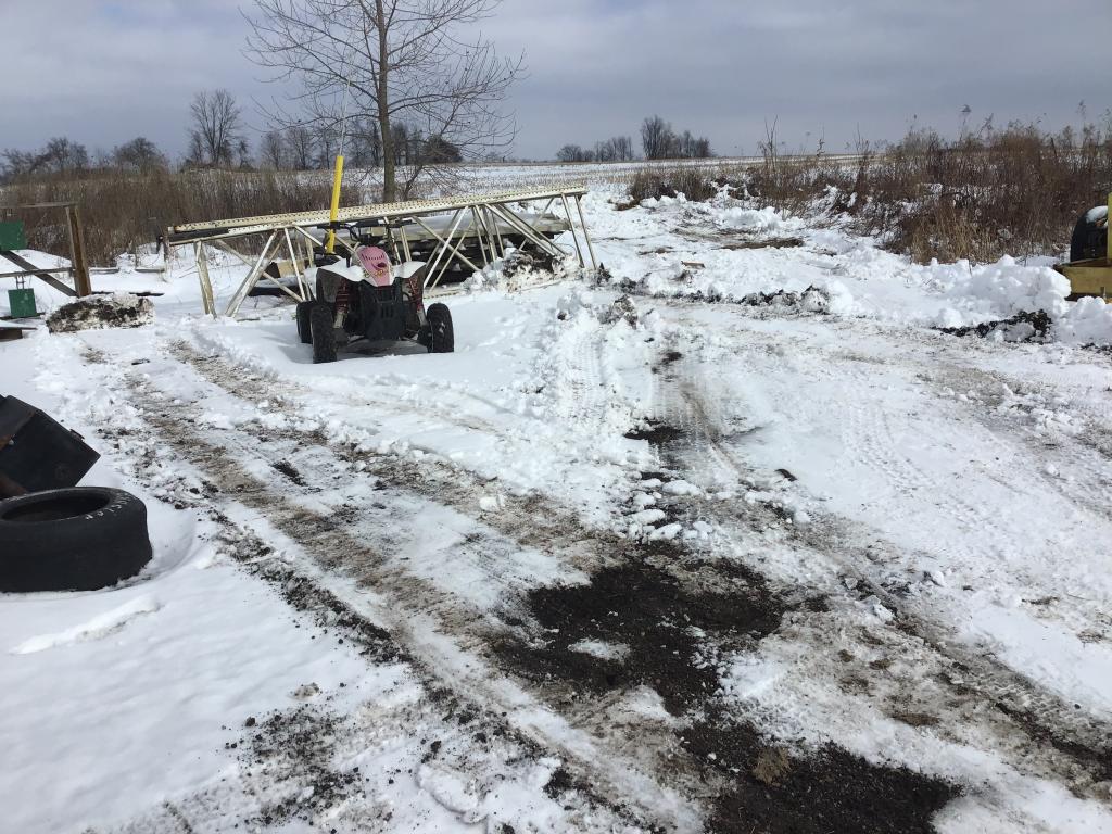

Pullstart 68,780 #4 Posted February 10, 2020 34 minutes ago, WildmanC120 said: Good luck. She purrs! I think I’ll stick to my truck for now though 5 Share this post Link to post Share on other sites
953 nut 63,977 #5 Posted February 11, 2020 8 hours ago, pullstart said: Setting my gap at .020”, it grows to about .025” when I tighten the screw! An external tooth lock washer works well to prevent creep while tightening the screw. 2 Share this post Link to post Share on other sites
Pullstart 68,780 #6 Posted February 11, 2020 52 minutes ago, 953 nut said: An external tooth lock washer works well to prevent creep while tightening the screw. This had a star type lock washer, but the slot was not letting me keep a .020 gap once the screw was tight.. the slot needed a little grinder relief to allow tightening at the proper spot. Good news though, it’s running great now! 1 1 Share this post Link to post Share on other sites
