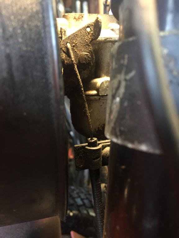

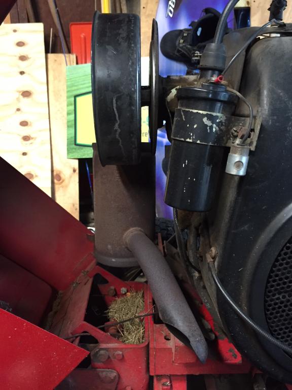

953 nut 63,977 #2 Posted February 8, 2020 Here you go. 2 Share this post Link to post Share on other sites

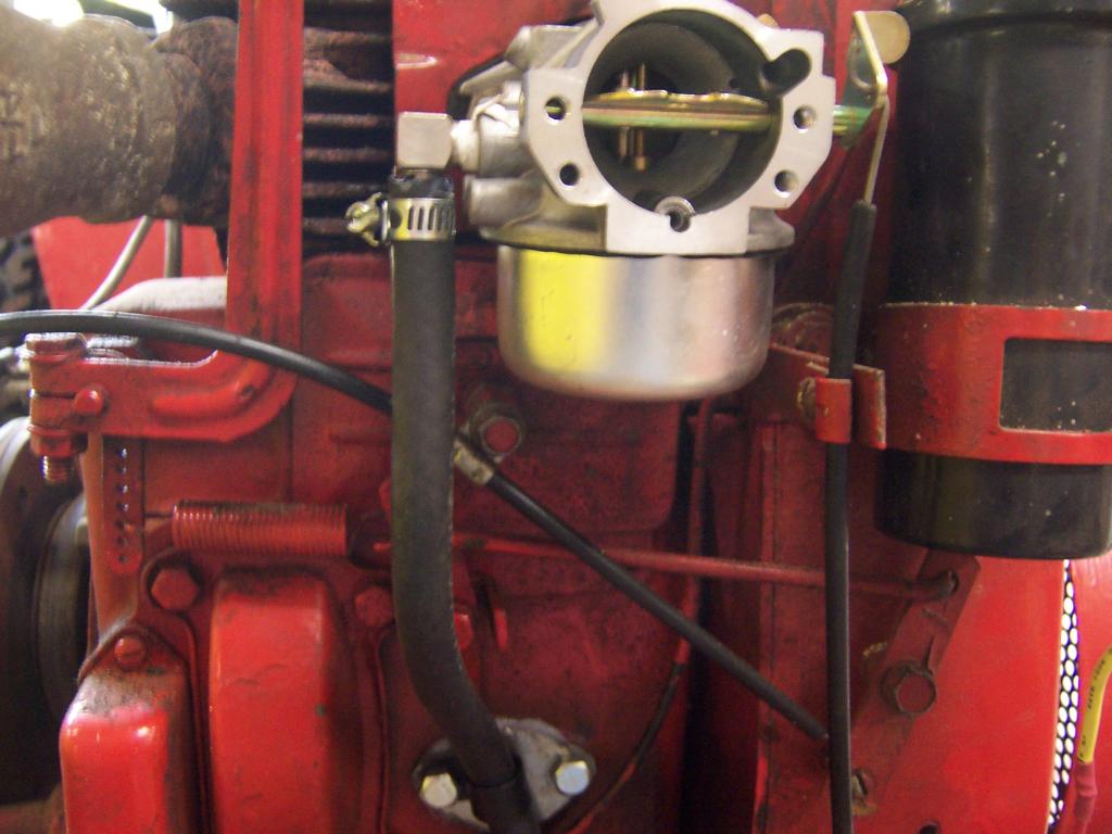

SylvanLakeWH 30,485 #3 Posted February 8, 2020 On a C 105...Hope these help... Share this post Link to post Share on other sites
oldredrider 2,553 #4 Posted February 8, 2020 (edited) 4 hours ago, 953 nut said: Here you go. Thanks Richard. That's exactly what I was looking for! Edited February 8, 2020 by oldredrider 1 Share this post Link to post Share on other sites

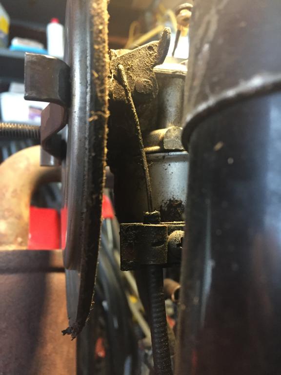

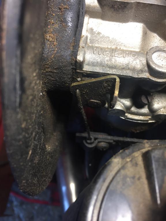

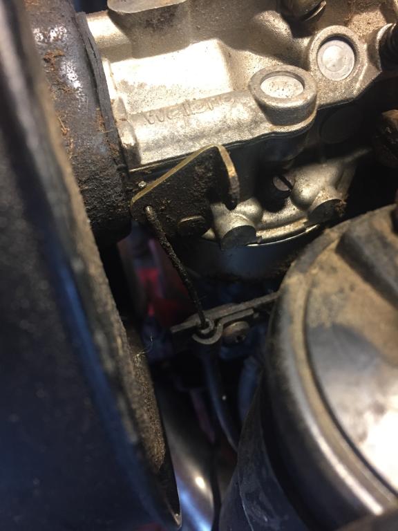

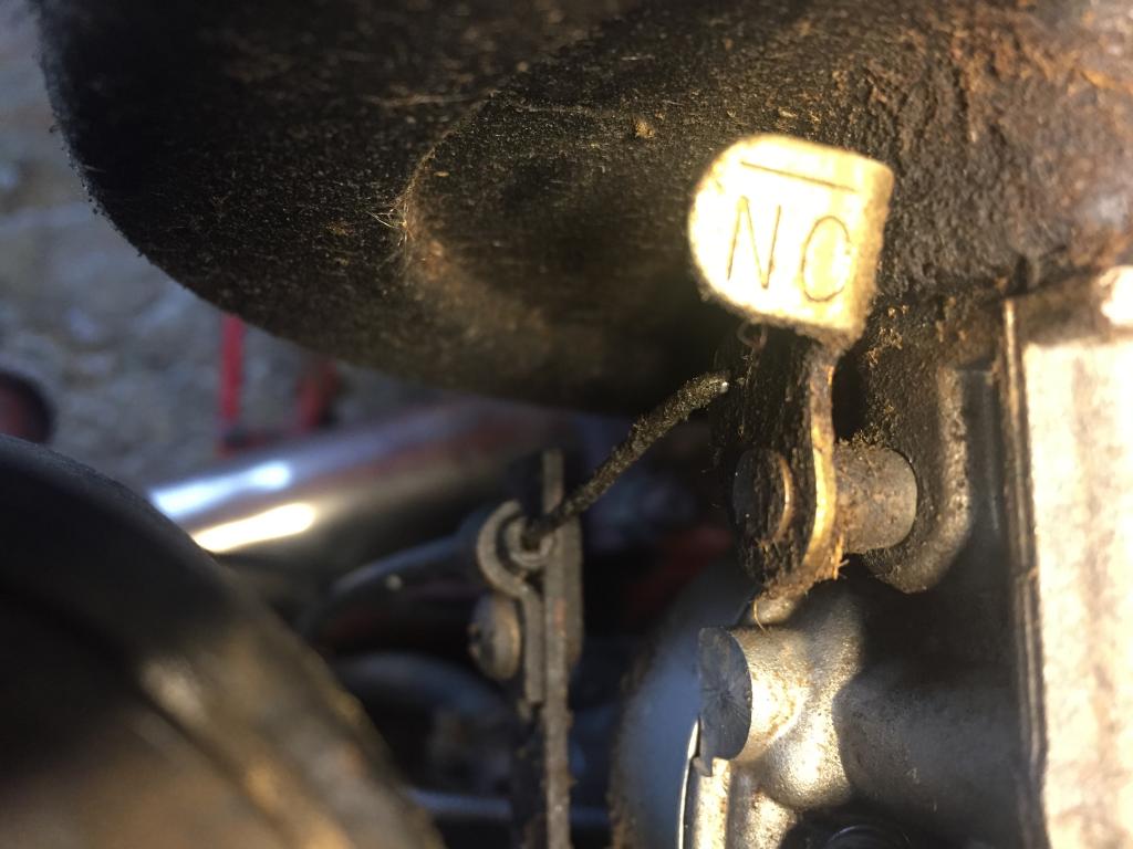

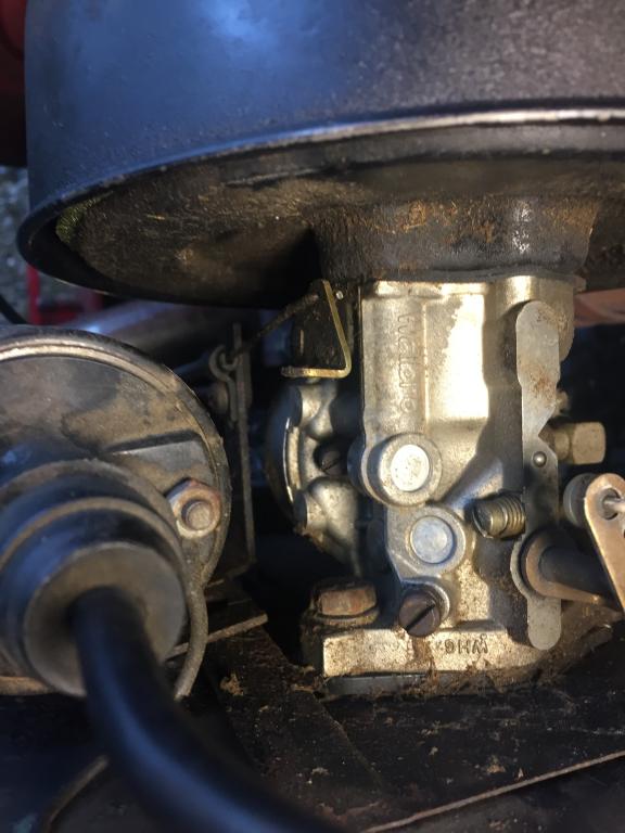

oldredrider 2,553 #5 Posted February 10, 2020 After digging through all the parts, I came up with these guys. Apparently, this engine uses a shorter linkage rod which hooks up to the throttle cable like this: Notice the throttle cable clamp is mounted to the shroud. Share this post Link to post Share on other sites
953 nut 63,977 #6 Posted February 11, 2020 6 hours ago, oldredrider said: the throttle cable clamp is mounted to the shroud That clamp is for the choke cable, the one on the breather/valve cover is for the throttle. Should work fine. Share this post Link to post Share on other sites
oldredrider 2,553 #7 Posted February 11, 2020 Not shown in the pic but there is a clamp for the choke cable mounted in the conventional spot. The throttle cable mounted in the shroud clamp lines up perfectly with the linkage angle thingy. If you look closely at your pic, there is a mounting hole for a clamp on your shroud. 1 Share this post Link to post Share on other sites
