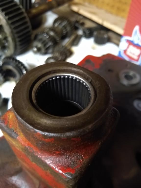

Psychonova68 36 #83 Posted February 21, 2020 What's the easiest way to get the needle bearings out of the case? Can they be pressed or punched out? Share this post Link to post Share on other sites
ebinmaine 80,457 #84 Posted February 21, 2020 1 minute ago, Psychonova68 said: What's the easiest way to get the needle bearings out of the case? Can they be pressed or punched out? Assuming you're talking about the wheel bearings that are at the outside... I've found that my easiest way is to find something just smaller then the inside diameter of the case. Such as a socket. Put an extension on it and it gives you a nice even surface to tap those from the outside in. Others will likely chimed in with different ways of doing it as well. 1 Share this post Link to post Share on other sites

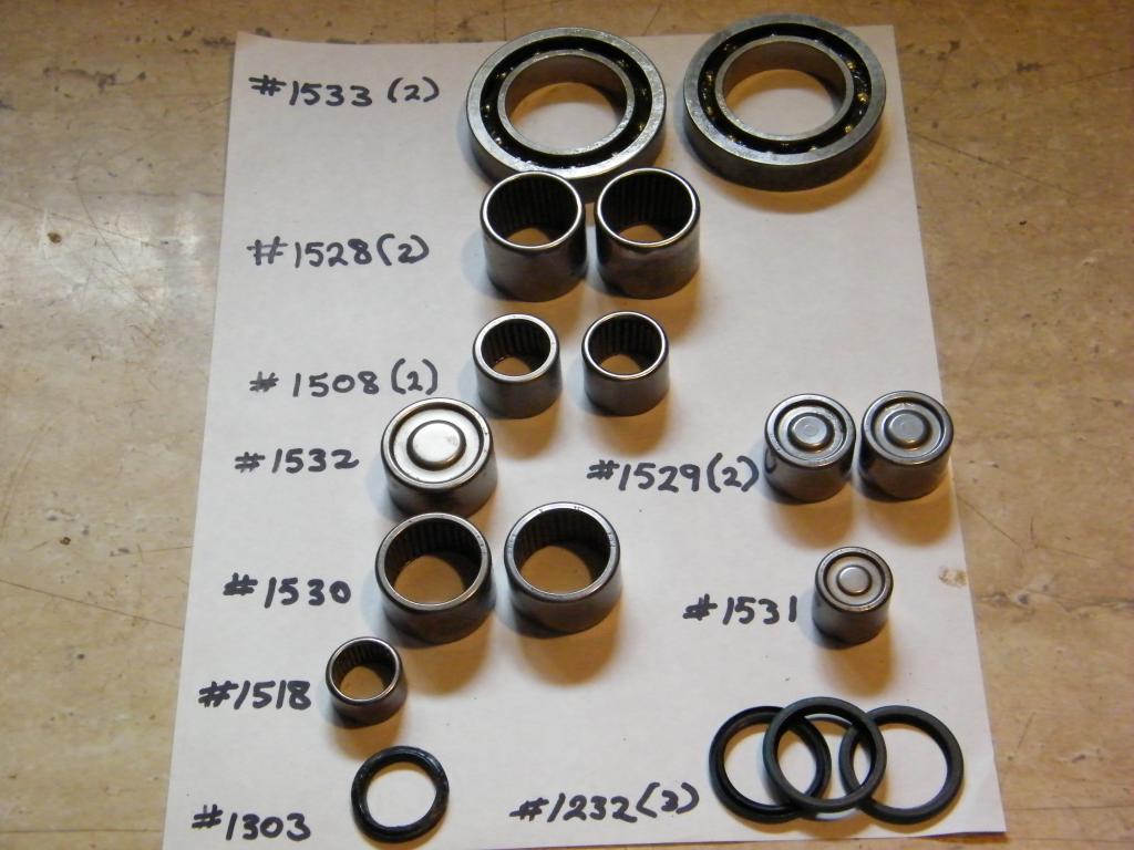

pfrederi 21,095 #87 Posted February 21, 2020 (edited) 3 minutes ago, ebinmaine said: Are you replacing the carrier roller bearings or were those okay? Need to be careful in describing the inner bearings. WH used two types. most common is a Ball bearing (#1533) but in some years (I guess when they didn't have any 1533s) the used a straight Needle / Roller bearing. #8048 Edited February 21, 2020 by pfrederi 2 Share this post Link to post Share on other sites
Psychonova68 36 #88 Posted February 21, 2020 I'm replacing all of the bearings because it was cheaper to buy the whole kit than individually buying about half of them. I got the axle bearings out with ease (2 1533s and 2 needles). But the bearings I was referring to are the ones that you can see an indent on the outside of the case. I wasn't sure if I could punch them out. Share this post Link to post Share on other sites
stevasaurus 23,816 #89 Posted February 21, 2020 Those are the cap bearings. They are one piece and treat them the same as the regular needle bearings. They are actually easier to punch out. When you put in the new cap bearings, do it from the out side of the case and tap in until flush. Some cap bearings in this picture. Share this post Link to post Share on other sites
pfrederi 21,095 #90 Posted February 21, 2020 47 minutes ago, Psychonova68 said: I'm replacing all of the bearings because it was cheaper to buy the whole kit than individually buying about half of them. I got the axle bearings out with ease (2 1533s and 2 needles). But the bearings I was referring to are the ones that you can see an indent on the outside of the case. I wasn't sure if I could punch them out. I drive them out from the inside using a socket and/or a washer that fits the bearing lip but smaller than the hole in the case. 1 Share this post Link to post Share on other sites
