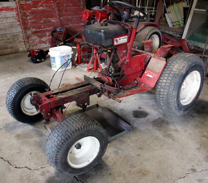

Mr Magoo 226 #53 Posted June 1, 2020 I got it fired up today, but it wasn't pretty. First off, the fuel pump is not pumping the fuel. I could get it to flow only by gravity. It looks to be the original. I'm not sure what I will do with that yet. Not sure if I want to try one of the replacements, a pulse, or I may order a rebuild kit from Then and Now Automotive. It would only run with the choke partially closed, so obviously the carb needs some attention. I do have a new one, so I may throw that on while I rebuild the original. I found that the wire leading to the breaker points is missing insulation so I will replace that. I also have new points and a condenser to put on it, but forgot to bring them to the property. The next issue was that I did get quite a bit of smoke on first start, but not so much after it warmed up a bit. It smelled really bad. Probably has not run in more than 15 years and it smelled like a combination of burnt mouse nest and oil. Maybe fluffy had a nest in the muffler. My wife was also trying to work in the barn while I was doing this and was not happy! I agreed that next time I would roll it outside to start it up. One good thing is that I did engaged the hydro and she went forward and reverse. 2 2 Share this post Link to post Share on other sites

Mr Magoo 226 #63 Posted June 24, 2020 So I picked up a long block this week. Hoping it works out. I only paid $50.00 for it. Someone had the head off of it and cleaned it all up. It does have a STD piston in it which I was glad to see. Cylinder looks okay and the piston looks concentric in the bore not like my original. One thing I seemed to notice is that when I rotate it through, the valves seem to come up more than my old one. Could be mistaken. One other question I have is that it has a wires coming from behind the flywheel which I assume is the stator. I guess I never noticed this wire if my original C-120 engine has one. Again, my tractors are not here with me, but at a weekend property and I can't look at it right now. I didn't notice it on my other C-120 either, but I did not have to tear into it much to get it running. Is it safe to assume that they both have a stator or is there a different charging system on some? 1 Share this post Link to post Share on other sites
ebinmaine 79,071 #64 Posted June 24, 2020 I'm thinking both should have a stator. On mine it's a black (or red) sleeve with the 2 wires in it. Comes out from behind the flywheel by the starter. 1 Share this post Link to post Share on other sites
Mr Magoo 226 #65 Posted June 24, 2020 Just now, ebinmaine said: I'm thinking both should have a stator. On mine it's a black (or red) sleeve with the 2 wires in it. Comes out from behind the flywheel by the starter. That's what this one has. Someone chopped it off so I will have to put some new terminals on it and extend it. A tree fell on the tractor and crushed it from the steering wheel on back. Missed the motor to my good fortune. 1 Share this post Link to post Share on other sites

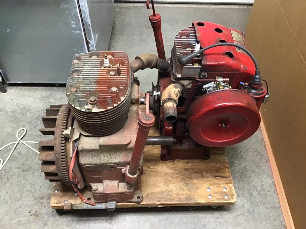

Mr Magoo 226 #66 Posted July 5, 2020 Still won't run. Turn the key and nothing happens. 1 Share this post Link to post Share on other sites
ebinmaine 79,071 #67 Posted July 5, 2020 I wouldn't be too concerned. Probably a loose ground. Share this post Link to post Share on other sites
Mr Magoo 226 #68 Posted July 5, 2020 Getting ready for a heart transplant. The ugly one on the left is actually the new one. 1 Share this post Link to post Share on other sites
richmondred01 2,372 #69 Posted July 5, 2020 Never meet an ugly k series. 2 1 Share this post Link to post Share on other sites
