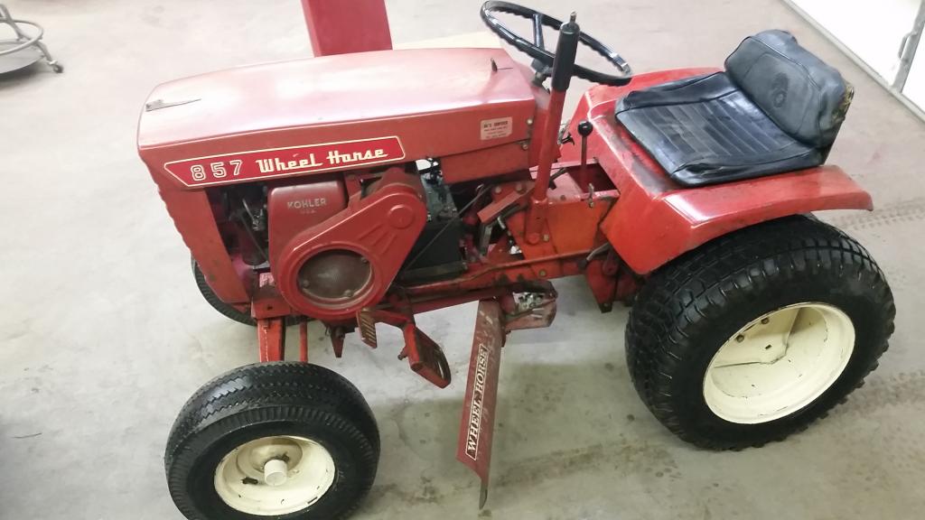

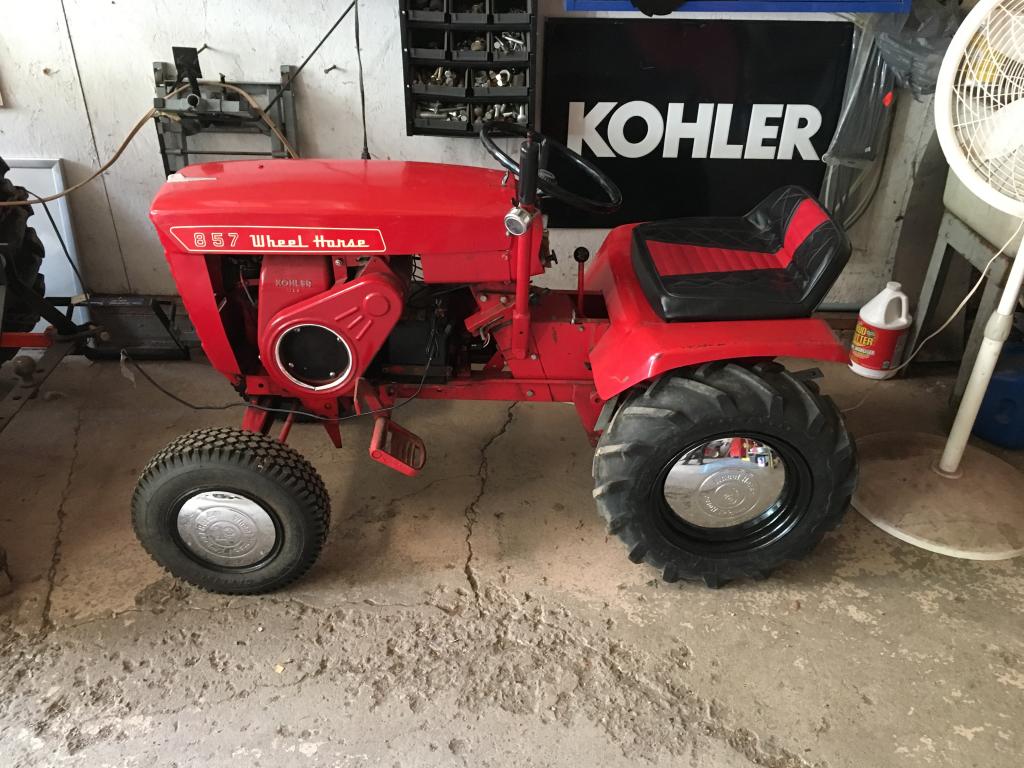

WHX?? 55,200 #7 Posted January 30, 2020 (edited) Jim 857 is a go to worker of mine! She a got new axle bearings this winter and maybe a motor refresh next winter. Time for some 857 pics! Just one of the many great things about RS is the way the pics just pop at ya not those itty bitty thumbnails like other sites! Did I mention the fellas like their pics here Mr. Walker?!?! Edited January 30, 2020 by WHX24 3 2 2 Share this post Link to post Share on other sites

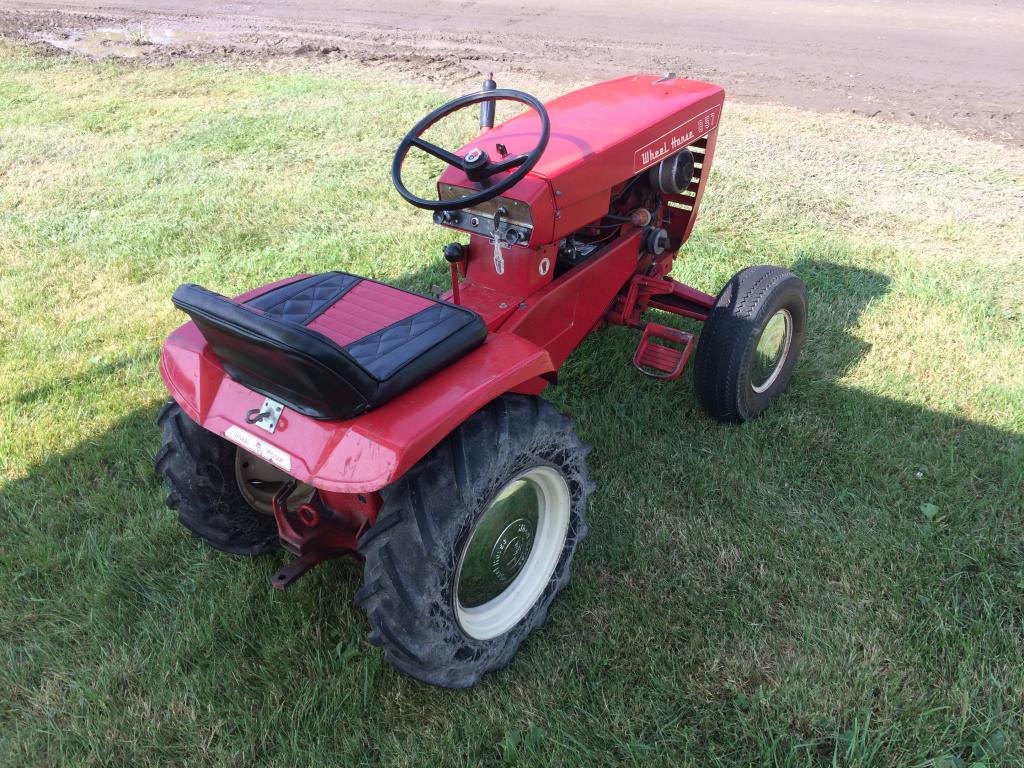

squonk 45,593 #8 Posted January 30, 2020 (edited) WHO DOESN'T LIKE 857 PICS! HHHOOOWWWAAARRRDDD!!! Edited January 30, 2020 by squonk 4 1 1 Share this post Link to post Share on other sites
WHX?? 55,200 #9 Posted January 31, 2020 One question here tho Mike ... is that a trailer queen or a worker? Any pics of it in the dirt? Share this post Link to post Share on other sites

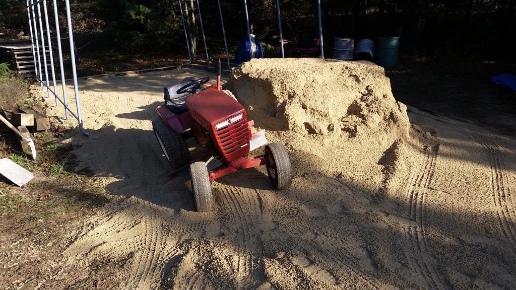

squonk 45,593 #11 Posted January 31, 2020 8 hours ago, WHX24 said: One question here tho Mike ... is that a trailer queen or a worker? Any pics of it in the dirt? HHHOOOWWWAAARRRDDD!!! is my yard tug/ show cruiser. Notice the mud splashed on the tires in the first pic after puddle jumping at our steam show 2 ys. ago. I added a Bad Boy air horn to go along with the bike bell since! 1 Share this post Link to post Share on other sites

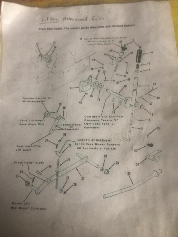

Lane Ranger 11,814 #14 Posted January 31, 2020 (edited) Two of the best charts you can use to keep track of your Wheel Horse tractor requirements. I keep them on the wall of the garage. Edited January 31, 2020 by Lane Ranger 2 Share this post Link to post Share on other sites
