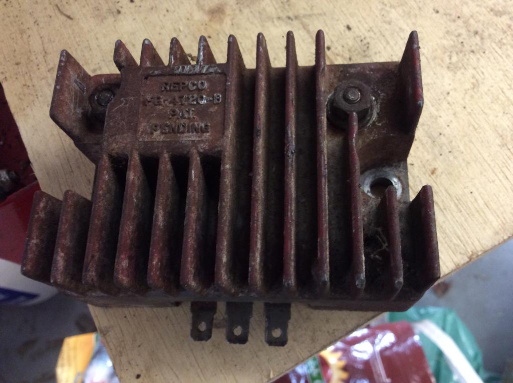

Searcher60 209 #4 Posted January 30, 2020 7 hours ago, gwest_ca said: Looks like Kohler supplied the regulator with the engine so that is where you need to look for it. Item #47 https://www.partstree.com/models/k301-47147-kohler-k-series-engine-made-for-wheel-horse-12hp-9kw/breaker-ignition-02110163509-29/ You won't like the price but should find a suitable replacement using the part number. Part# 41 403 08-S rated at 10 amps. You may find a 15 amp is cheaper but would require different wire connection. Garry Negative, mine is located behind the center console below the fuel tank. Just like a C series, but I have magneto ignition. Unless Kohler supplied the rectifier and Wheel Horse mounted it on the chassis. Thanks. Share this post Link to post Share on other sites
953 nut 64,660 #5 Posted January 30, 2020 There are only a handful of 12 volt Rectifier/Regulators on the market. There will be a three wire connector that fits the R/R and that will narrow the field down. The other glaring difference will be the heat-sink (the aluminum fins that dissipate heat). Some have short fins and must be in an airstream to cool and others (like yours should be) have longer fins. Show us a photo of the electrical connection please. Share this post Link to post Share on other sites
gwest_ca-(File Mod) 12,070 #6 Posted January 30, 2020 3 hours ago, Searcher60 said: Kohler supplied the rectifier and Wheel Horse mounted it on the chassis. That is what happened. Up till this time period the starter/generator and regulator came bolted to the engine. When they went to the Bendix starter and alternator stator they introduced the electronic regulator with the first one's Wheel Horse used being 10 amp. The C-Series use a 15 amp regulator that has different terminal locations but will work for you. Supply and demand seems to keep this one more economical. 101450 was the part number at the time. Garry Share this post Link to post Share on other sites
Achto 31,314 #7 Posted January 30, 2020 (edited) 14 hours ago, Searcher60 said: Anybody know what the part number is for a 69’ Electro rectifier? Thanks in advance 12 hours ago, troutbum63 said: That's a pretty crazy price, talk about price gouging. I like to use OEM parts as much as the next guy, but they shouldn't cost more than the tractor is worth. Try this site instead. http://www.psep.biz/store/kohler_voltage_regulator.htm Part #PSEPJDR4720 if your terminals on the regulator are all in a line. Part #MESJDR2256 if your terminals are one row of 2 with the third term in a separate row. Edited January 30, 2020 by Achto 1 Share this post Link to post Share on other sites
Searcher60 209 #8 Posted January 30, 2020 17 hours ago, gwest_ca said: Looks like Kohler supplied the regulator with the engine so that is where you need to look for it. Item #47 https://www.partstree.com/models/k301-47147-kohler-k-series-engine-made-for-wheel-horse-12hp-9kw/breaker-ignition-02110163509-29/ You won't like the price but should find a suitable replacement using the part number. Part# 41 403 08-S rated at 10 amps. You may find a 15 amp is cheaper but would require different wire connection. Garry Negative, mine is located behind the center console below the fuel tank. Just like a C series, but I have magneto ignition. Unless Kohler supplied the rectifier and Wheel Horse mounted it on the chassis. Thanks. Here is a picture. Note the Repco #. Share this post Link to post Share on other sites

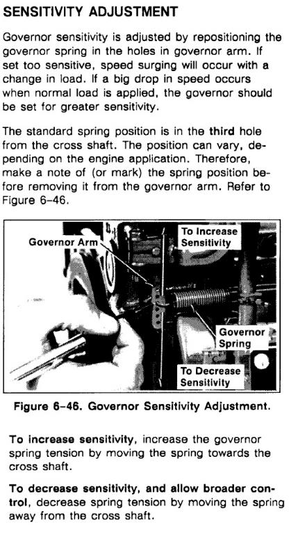

Searcher60 209 #9 Posted January 31, 2020 On 1/30/2020 at 7:00 AM, gwest_ca said: That is what happened. Up till this time period the starter/generator and regulator came bolted to the engine. When they went to the Bendix starter and alternator stator they introduced the electronic regulator with the first one's Wheel Horse used being 10 amp. The C-Series use a 15 amp regulator that has different terminal locations but will work for you. Supply and demand seems to keep this one more economical. 101450 was the part number at the time. Garry Thanks, I ordered the Stens 435-057, $18.00 shipped. Hope it is correct. I have 26.3 Volts AC coming out of the Stator. Can you comment on a couple other issues? Who makes a throttle cable worth a dam? Is the Stens cable junk because the knob turns on the shaft and it will not hold position? Or, are they all a problem? Also, on the K series, on Wheel Horse, which holes do the governor springs go into? Thanks in advance. Share this post Link to post Share on other sites
gwest_ca-(File Mod) 12,070 #10 Posted January 31, 2020 From section 6 of the service manual Garry Share this post Link to post Share on other sites
