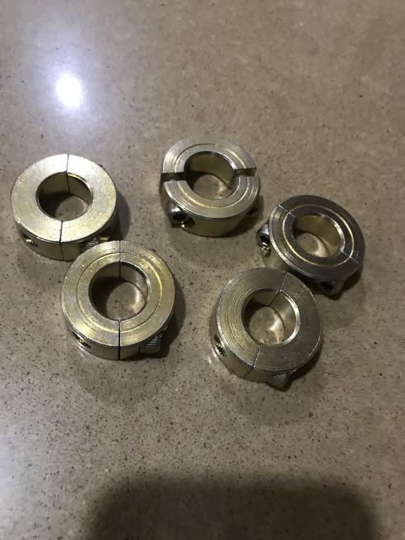

Lane Ranger 11,628 #1 Posted January 29, 2020 (edited) I have been using a two piece 3/4 inch collar when rebuilding my Wheel Horse tractors. These two piece collars are particular good when putting on the steering wheel shaft! They work well at other applications on the wheel horse tractors also! Edited January 29, 2020 by Lane Ranger 2 2 Share this post Link to post Share on other sites

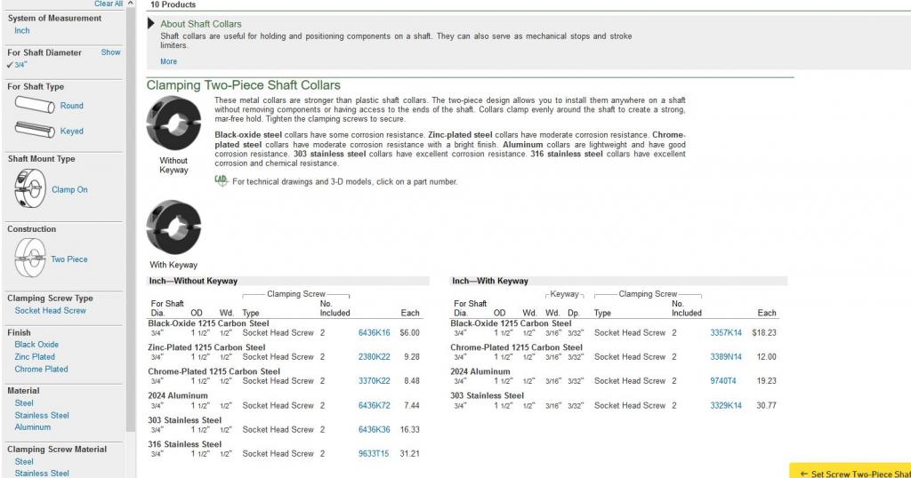

Lane Ranger 11,628 #5 Posted February 13, 2020 (edited) I buy mine on Ebay. I have been buying zinc coated. 8 hours ago, Pops said: Lane where do you gets these ? Edited February 13, 2020 by Lane Ranger Share this post Link to post Share on other sites
