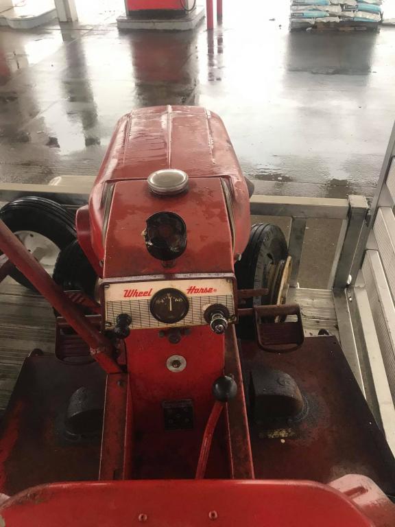

Lane Ranger 11,680 #1 Posted January 27, 2020 (edited) I need to buy a new throttle and choke cable for a 702. Where can I get them that are compatible with the installation on a 7 HP Holer on the 702? And reference part number or link would be apprecaited! Edited January 27, 2020 by Lane Ranger Share this post Link to post Share on other sites
