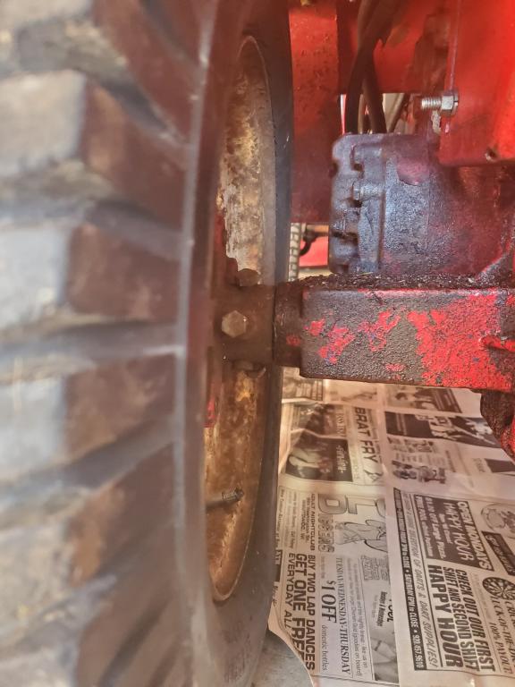

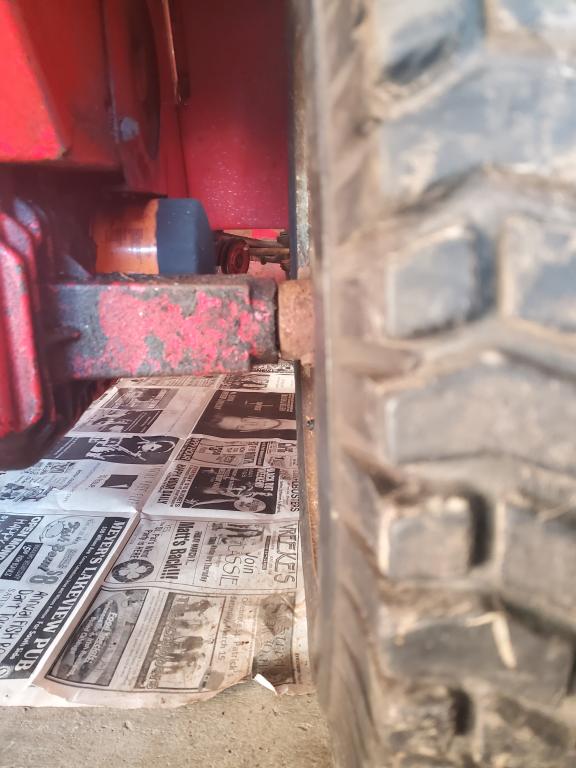

12Horse Paladin 1,038 #1 Posted January 27, 2020 GoodMorning, everyone. I dont kno how far ill go, or get, but im looking for info, help, instruction...on how to pull my rear hubs on my Bronco14, find the problem, and fix/repair/replace them. Whatever is needed. They both have terrible amount of play that even i know is not right. I just really dont know ehere to start, what im looking at or for, or how to go about things. I also think they were 'fixed' once before, as those bolts in the housing...im pretty sure arent factory. Ive posted these pics b4, but rightnow, they are all i have. Any input or instruction would b appreciated. Share this post Link to post Share on other sites
ZXT 2,401 #2 Posted January 27, 2020 (edited) Remove the two set screws (or however many the hubs have) and pull them off. Since they're already loose, you shouldn't need a puller. Edited January 27, 2020 by ZXT 2 Share this post Link to post Share on other sites
pfrederi 19,943 #3 Posted January 27, 2020 That is a real hack job. Looks like they may have drilled though the axle and hub and put in a bolt..looks like a nut on it in second picture. Jonah types faster. Remove all bolts hub will probably pull right off. If it doesn't start with a 2 or 3 jaw puller. If that doesn't move it then we will lok at better ideas. If you break the hub with jaw puller I doubt it is any great loss. If they are that hacked up the will probably have to be replaced any way 2 Share this post Link to post Share on other sites
oliver2-44 11,261 #4 Posted January 27, 2020 If they have excessive play the keyway in the axle or in the hub is probable wallowed out. Once you have them off, then we can help you determine what needs repair/replacement. Also if the hubs don't come off easy don't hammer on the back of the hub flange. The flanges break easy, and you could also shear the axle snap ring inside the tranny. You also should not use a typical 3 jaw bearing puller to just grab the flange. If you use a puller you need a bearing splitter or similar behind the whole flange for the puller to grab. 2 Share this post Link to post Share on other sites

Achto 31,115 #8 Posted January 27, 2020 43 minutes ago, ZXT said: If they didn't use a bolt that fit tightly in the hole, that would explain why it didn't work well My Raider 12 had a trough bolt installed before I took ownership. It did not fair well. I ended up repairing the axle and setting every thing up for a full length key. 1 1 Share this post Link to post Share on other sites

pfrederi 19,943 #10 Posted January 28, 2020 If the hub is loose feeling I doubt you will need a puller once you get the bolts out. but yes new hubs will probably be in order.. if not new axles ...sorry Share this post Link to post Share on other sites
stevasaurus 23,620 #11 Posted February 1, 2020 Get the hubs off and give us some pictures of them and the axles. Share this post Link to post Share on other sites
squonk 45,593 #12 Posted February 1, 2020 While you're at it, get that junk Fram filter off of the hydro and put on a Napa 1410 Share this post Link to post Share on other sites
Achto 31,115 #13 Posted February 1, 2020 (edited) Hate to agree with Squonk but,.... The orange death will have to go. Edited February 1, 2020 by Achto 1 Share this post Link to post Share on other sites
