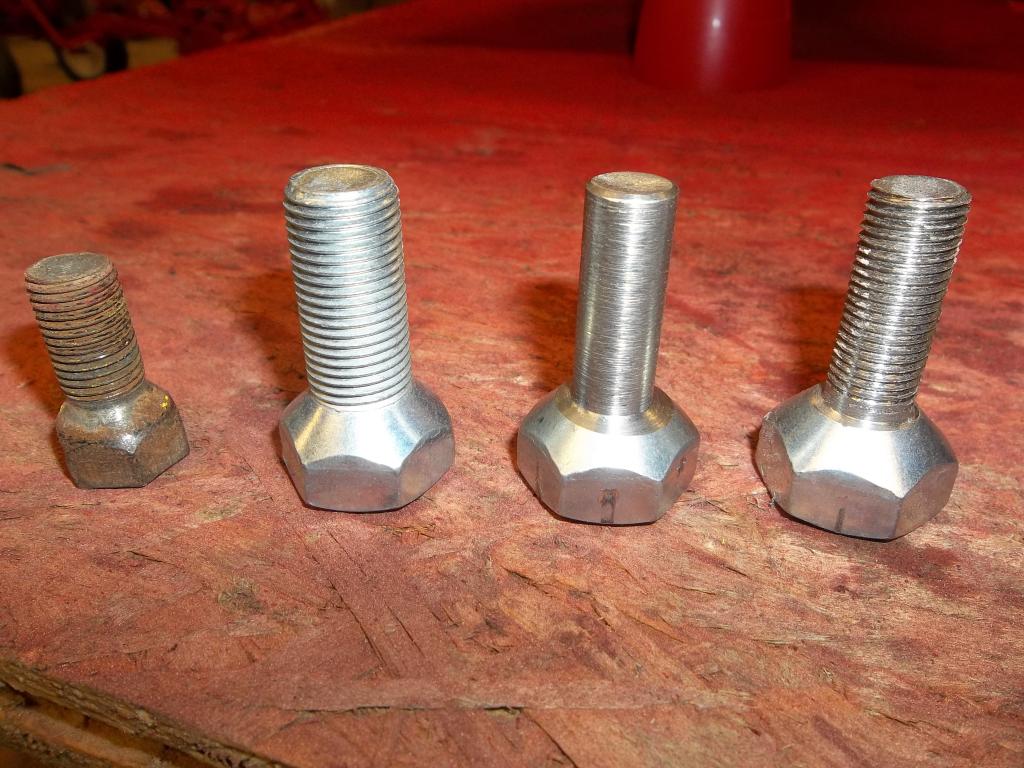

Oldskool 6,678 #154 Posted February 14, 2020 All the welds are ground down and body filler applied. More sanding and sanding. Having an issue with the wheel stud bolts. The head goes to far into the hole in the rim. Going to go at it a different way. I ordered some that have a 7/8" head with a 9/16" thread. Going to turn the 9/16 to 7/16 and re-thread. 1 Share this post Link to post Share on other sites

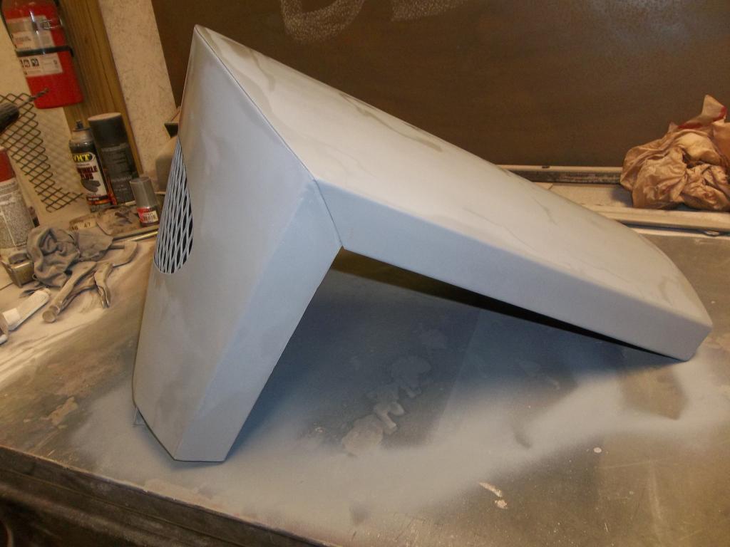

Achto 32,140 #155 Posted February 15, 2020 25 minutes ago, Oldskool said: Just wondering, it looks like you used lacquer based air dry filler?? If this is what you used please be ware that this filler will shrink over time letting imperfections show again. This will even happen after it is painted. A two part filler like Bondo that you have to mix together will not shrink. Just wanted to give you a heads up. 1 Share this post Link to post Share on other sites
Oldskool 6,678 #156 Posted February 15, 2020 2 minutes ago, Achto said: Just wondering, it looks like you used lacquer based air dry filler?? If this is what you used please be ware that this filler will shrink over time letting imperfections show again. This will even happen after it is painted. A two part filler like Bondo that you have to mix together will not shrink. Just wanted to give you a heads up. You are absolutely correct. Actually this is a skim coat over Miro-Lite body filler to fill in pin holes and dig marks and etc. 1 Share this post Link to post Share on other sites
Oldskool 6,678 #157 Posted February 15, 2020 16 hours ago, Oldskool said: Having an issue with the wheel stud bolts. The head goes to far into the hole in the rim. Going to go at it a different way. I ordered some that have a 7/8" head with a 9/16" thread. Going to turn the 9/16 to 7/16 and re-thread. Well that plan has taken a turn. The parts didn't come in today. I won't have them till Tuesday. . Been trying to come up with a work around to have it done this weekend but nothing is coming to mind. UGH.!! 1 1 Share this post Link to post Share on other sites

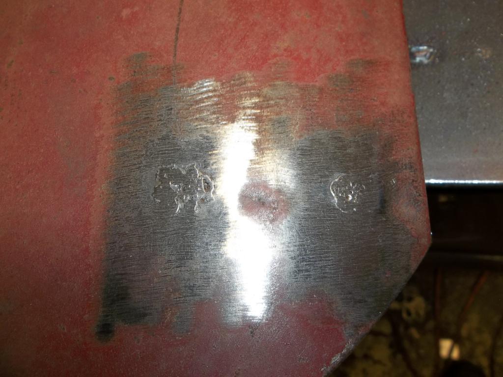

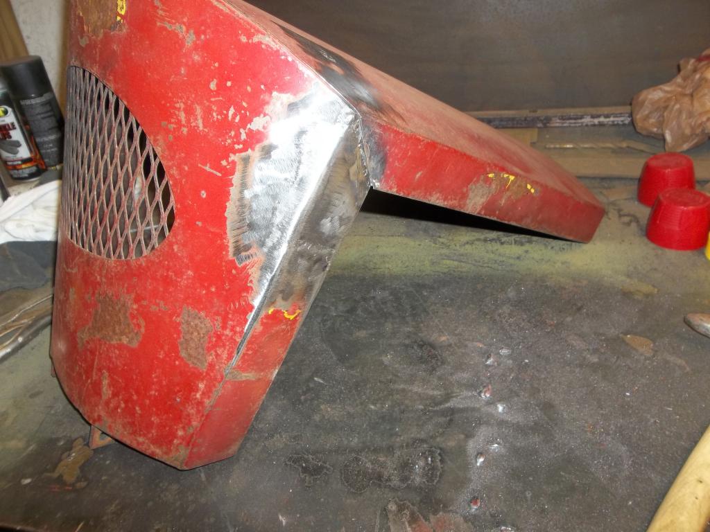

Oldskool 6,678 #158 Posted February 15, 2020 SOOooo this isss NOT my day. Just dropped the hood, landed on the corner of a cement block. Just stripped the whole thing and now back to dent repair. 3 Share this post Link to post Share on other sites
Oldskool 6,678 #160 Posted February 15, 2020 Well made it back to were I was and made a little ground 1 2 Share this post Link to post Share on other sites

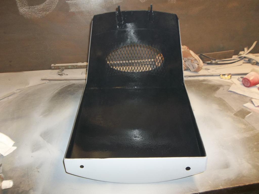

Oldskool 6,678 #162 Posted February 16, 2020 Made some progress today. The seat has been dropped off at a buddies house, who happens to be clear coating some small parts. I was thinking it would be better for wear and tear. The hood is coming along nicely, but I don't have enough paint to finish. So this is where I am stopping today 1 1 1 Share this post Link to post Share on other sites

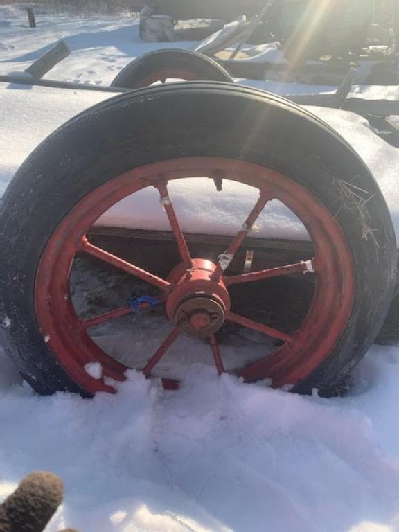

Oldskool 6,678 #166 Posted February 17, 2020 I don't know what I'm gonna do with these yet but they will be coming home with me. 4.00-18 with a 1'bore 1 1 1 Share this post Link to post Share on other sites
Stormin 9,988 #167 Posted February 17, 2020 10 minutes ago, Oldskool said: I don't know what I'm gonna do with these yet but they will be coming home with me. 4.00-18 with a 1'bore I like those. Look great on a retro 1920s - 30s wooden cart/trailer. 1 Share this post Link to post Share on other sites
Oldskool 6,678 #168 Posted February 17, 2020 9 minutes ago, Stormin said: I like those. Look great on a retro 1920s - 30s wooden cart/trailer. Thats what I was thinking, or make one that looked like a manure spreader? 1 Share this post Link to post Share on other sites
Darb1964 1,169 #169 Posted February 17, 2020 I like them, you'd have to pry them out of my cold dead hands if they were mine. 2 Share this post Link to post Share on other sites
Oldskool 6,678 #170 Posted February 17, 2020 10 minutes ago, Darb1964 said: I like them, you'd have to pry them out of my cold dead hands if they were mine. I agree 100%. I'm getting them on a trade. They were just sitting there waiting for someone to take them home 2 Share this post Link to post Share on other sites

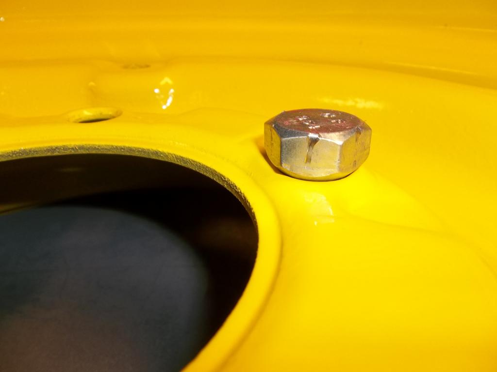

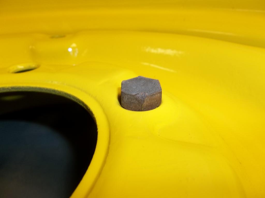

Oldskool 6,678 #171 Posted February 19, 2020 A little update on the wheel stud bolts. You can see the original bolt in this pic. It sits to low in the hole Share this post Link to post Share on other sites
Oldskool 6,678 #172 Posted February 19, 2020 Here is the fix for that. I have gone from 7/16 bolt with a 5/8 head to a 9/16 bolt turned down to 7/16 with a 7/8 head. A much better fit. 1 Share this post Link to post Share on other sites

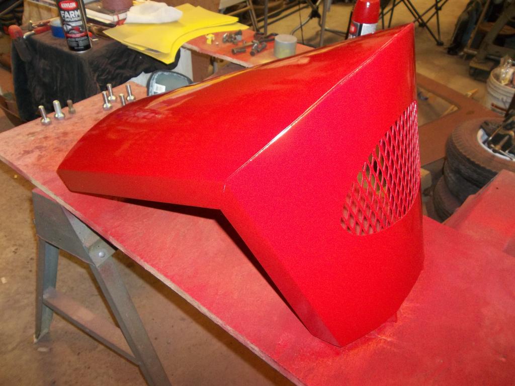

Oldskool 6,678 #174 Posted February 19, 2020 and the hood is now red 2 1 Share this post Link to post Share on other sites
