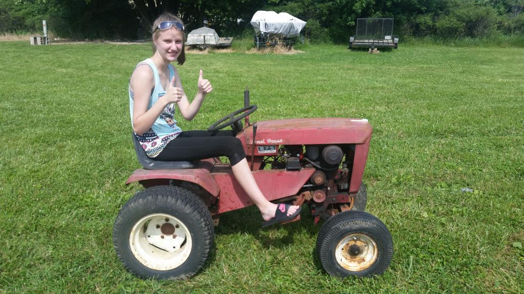

bottjernat1 2,196 #1 Posted January 27, 2020 Good morning folks! I was wondering what frame will swap out with an 1965 875? My daughters 875 I discovered has a major issue when i jacked it up the rear end and the front where not moving insync LOL! I noticed someone has welded a steal plate over where the typical cracks happen. It has been like that for years im assuming my late dad knew about it. My friend joe had a frame he said he would sell me for $5 but i wanted everyone's expertease on what all model frames will interchange! Thanks for the help!! Share this post Link to post Share on other sites
