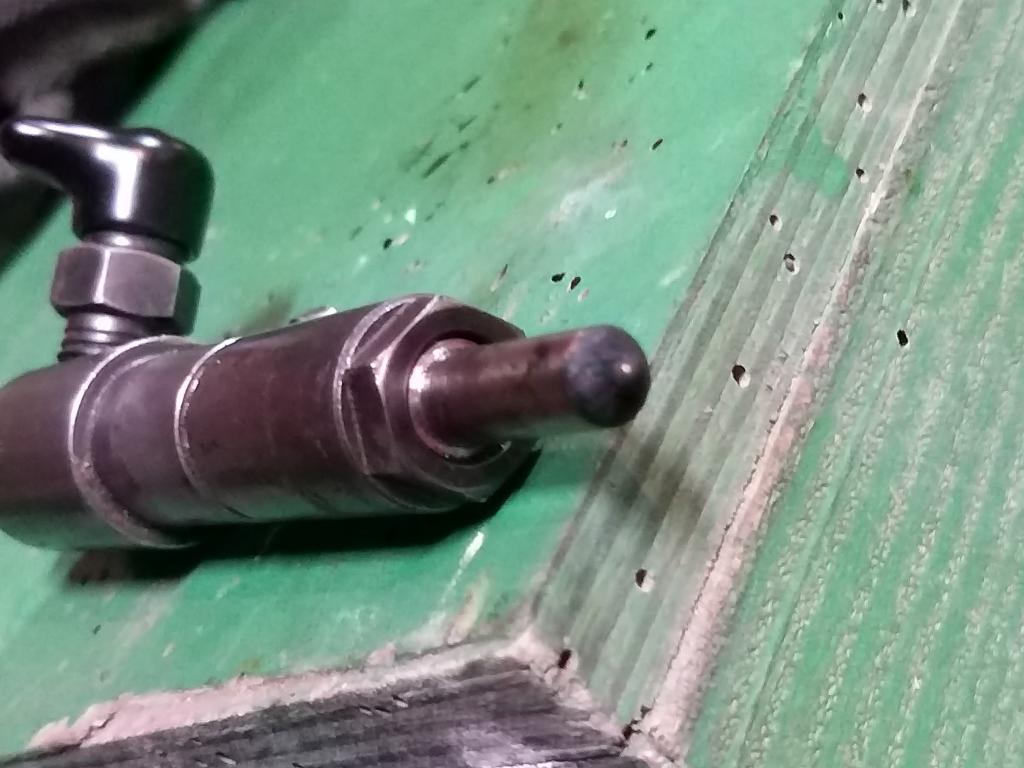

Bertie 314 #1 Posted January 26, 2020 My 512d was losing power and blowing black smoke. Found an nos injector which I replaced today along with an oil service, now running spot on but look at this injector can't believe it was still running.. Share this post Link to post Share on other sites
peter lena 9,713 #2 Posted January 27, 2020 welcome bertie, glad you found your issue, and the relatively easy fix. you might improve your fuel filter set up, and regularly add a diesel fuel additive , a number of car/truck shows i watch emphasize diesel fuel detail , good luck with yours , pete 1 Share this post Link to post Share on other sites
Bertie 314 #3 Posted January 27, 2020 24 minutes ago, peter lena said: welcome bertie, glad you found your issue, and the relatively easy fix. you might improve your fuel filter set up, and regularly add a diesel fuel additive Hi Peter, funnily enough I've purchased some additive and I need to rework the filter set up so see how that goes... overall it's a great little engine that sips diesel unlike my other Wheel Horses 👍 1 Share this post Link to post Share on other sites
