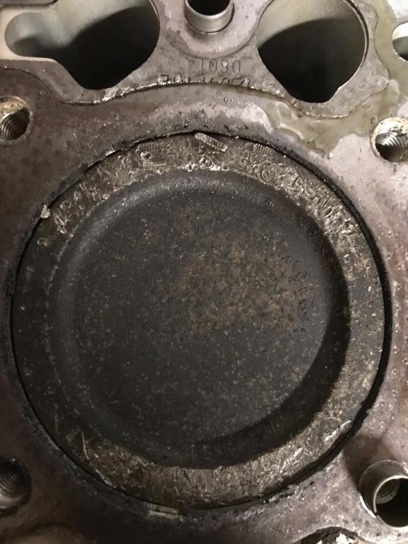

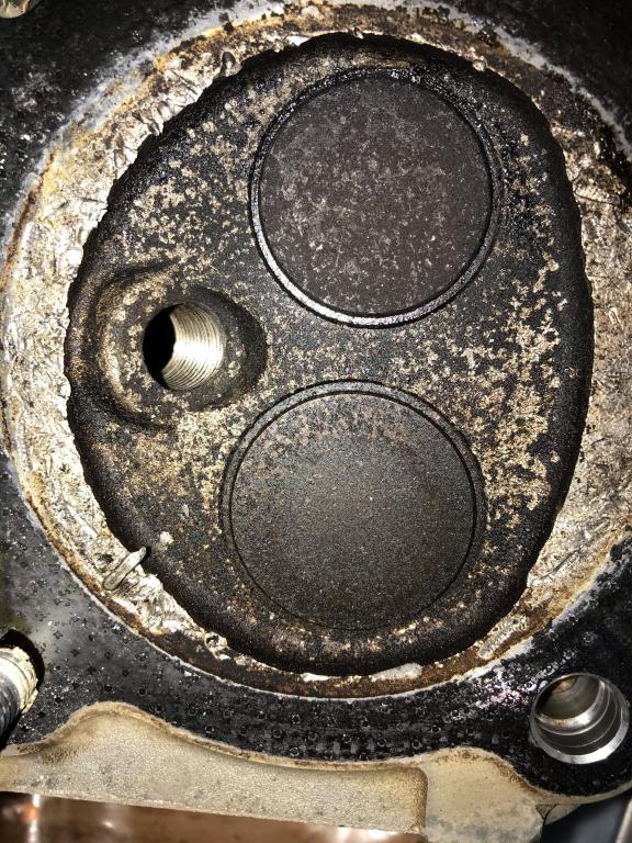

CDN 0 #5 Posted January 24, 2020 Hi Guys, She is all opened up and i found the culprit. Well found it long before i opened it up but needed to see if any thing else was broken. One of the screws from the choke butterfly was sucked in and mashed to death in the cylinder. Now how bad is this can i just clean her up and put it back together? or do i need a head and piston? Thanks Folks have a great evening! Jonathan Share this post Link to post Share on other sites
lynnmor 8,557 #6 Posted January 24, 2020 Move the piston down and carefully check the cylinder wall for marks or deep scratches. I would pop the valves and see if they, or the seats, are damaged, If all checks out, I would carefully clean and smooth surfaces, making sure any bits of metal are removed and then put it back together. Be sure to clean the intake and exhaust for junk that might find its way back in. Share this post Link to post Share on other sites
8ntruck 8,575 #7 Posted February 5, 2020 Probably would be a good idea to pull the piston to make sure no crud made its way into the rings. If you decide to re-use the piston and head, you will want to make sure the burrs that were beaten into the edges are all removed. They will become hot spots if they are not removed. This is why the throttle plate screws are staked . Share this post Link to post Share on other sites
