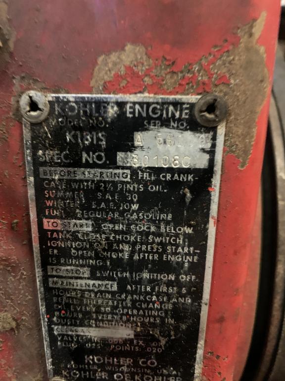

pfrederi 20,892 #33 Posted January 17, 2020 (edited) .006 .008 Intake .017 .019 exhaust It is a Wh Spec # Edited January 17, 2020 by pfrederi Share this post Link to post Share on other sites

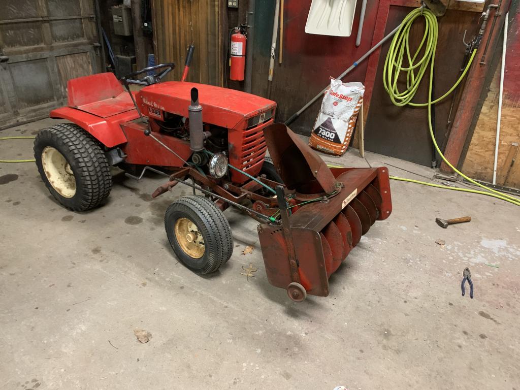

Chris1055 106 #37 Posted January 18, 2020 Well fellas it was a fun day getting this tractor at least to run. It’s a really nice survivor and I want to do a thread on this tractor being brought back mechanically and doing it’s yearly chores. Tonight I’m going to put a st 324 snowblower on it that I went through and some chains. Getting some snow tomorrow. After I run it for a bit I’ll recheck the valves. Seems to run alright in the mean time. I also would like your guys input on what you would like to see in my up coming threads. What do you guys think of the headlights? They are griffin 501 bigger than 401 but nice in the winter nights . Good and bright 1 Share this post Link to post Share on other sites
953 nut 67,497 #38 Posted January 18, 2020 Your Spec number ha a suffix of "A" so it is not an Automatic Compression Release engine. Share this post Link to post Share on other sites
