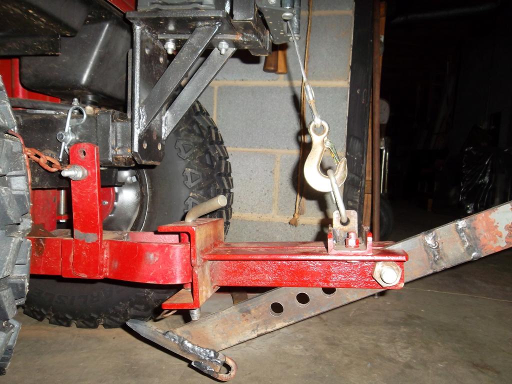

CCW 1,519 #27 Posted January 19, 2020 17 hours ago, AHS said: Looks good! From an axle reese hitch, ( the ones of eBay?) Homemade version I made to accept my 2" Reese hitch. 1 Share this post Link to post Share on other sites

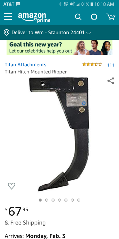

gwest_ca-(File Mod) 12,455 #35 Posted January 30, 2020 On 1/15/2020 at 10:51 AM, WVHillbilly520H said: Yes and you could just use a "box scraper" shank... Look at my post above. The bottom of the ripper needs to be beveled the other way. It will just keep coming up the way it is. I used a straight tapered helper spring off the front axle of a GM 4x4. It is about 3/4" thick in the center and 3/16" thick on the ends. Beveled the bottom so the point was forward and sharpened about 8" of the leading edge. Used it to cut invading tree roots headed for the garden. Could go down about 24" total in 2" increments because the roots are tough to cut but it worked. Garry Share this post Link to post Share on other sites
WVHillbilly520H 10,379 #36 Posted January 30, 2020 56 minutes ago, gwest_ca said: The bottom of the ripper needs to be beveled the other way. It will just keep coming up the way it is. I used a straight tapered helper spring off the front axle of a GM 4x4. It is about 3/4" thick in the center and 3/16" thick on the ends. Beveled the bottom so the point was forward and sharpened about 8" of the leading edge. Used it to cut invading tree roots headed for the garden. Could go down about 24" total in 2" increments because the roots are tough to cut but it worked. Garry https://www.agrisupply.com/18-inch-box-blade-shank/p/105646/... This is what I have and it worked decently for what the original poster was wanting to do ... Trench for cable/water line ect. 1 1 Share this post Link to post Share on other sites
wallfish 20,510 #37 Posted January 30, 2020 7 hours ago, WVHillbilly520H said: This is what I have That's how I built the teeth on the hoe bucket, replaceable when they get worn. Welded the front edge to get a hardened edge but bet that whole thing is hardened, hmm. 1 Share this post Link to post Share on other sites
