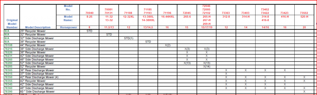

WHX?? 58,347 #34 Posted January 14, 2020 This little piece of attachment list says not only will a 314 handle a 48 but a 312 will too. Knowing my Kohlers I wouldn't be afraid to hook one up to a 310! 4 Share this post Link to post Share on other sites

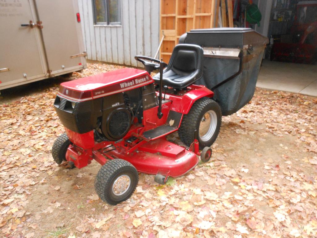

JCM 11,451 #36 Posted January 14, 2020 WH 312-8 with a 48'' SD mower and bagger with 5 hp briggs. 1 Share this post Link to post Share on other sites
