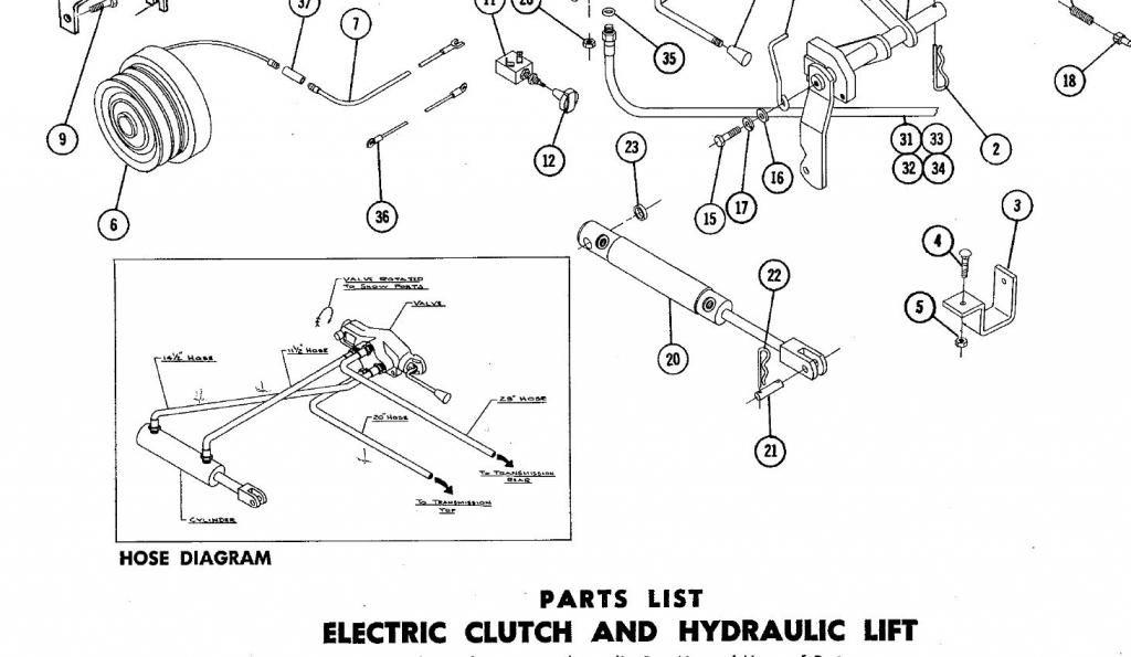

pfrederi 20,828 #26 Posted January 21, 2020 Raising the lever raises deck. The hose in the front port of the valve goes to the rear of the cylinder. Rear most valve port hose goes to front end of cylinder. Inside center port on valve goes to port next to tow valve on the pump. Outer hose on valve goes to port on back of pump via hole in the tool box. 1 Share this post Link to post Share on other sites
Searcher60 209 #27 Posted January 21, 2020 (edited) 6 hours ago, pfrederi said: Raising the lever raises deck. The hose in the front port of the valve goes to the rear of the cylinder. Rear most valve port hose goes to front end of cylinder. Inside center port on valve goes to port next to tow valve on the pump. Outer hose on valve goes to port on back of pump via hole in the tool box. Thanks for your reply. One question, do you mean by front of cylinder the end that the chrome rod comes out, or does front of cylinder mean the end of cylinder at the front part of tractor? My hoses going to the pump are backwards. Edited January 21, 2020 by Searcher60 Share this post Link to post Share on other sites
pfrederi 20,828 #28 Posted January 22, 2020 (edited) Front of tractor Check the manual for a diagram Edited January 22, 2020 by pfrederi 1 Share this post Link to post Share on other sites
Searcher60 209 #29 Posted January 22, 2020 Someone has the ones going to the trans swapped. I will change them today. Should make the lever work as it should. Thanks for that, now do you have any magic for rewinding the electric PTO coil? Thanks again! 1 Share this post Link to post Share on other sites

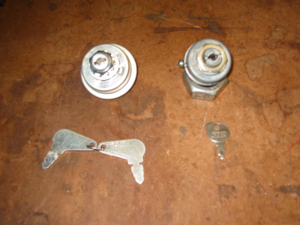

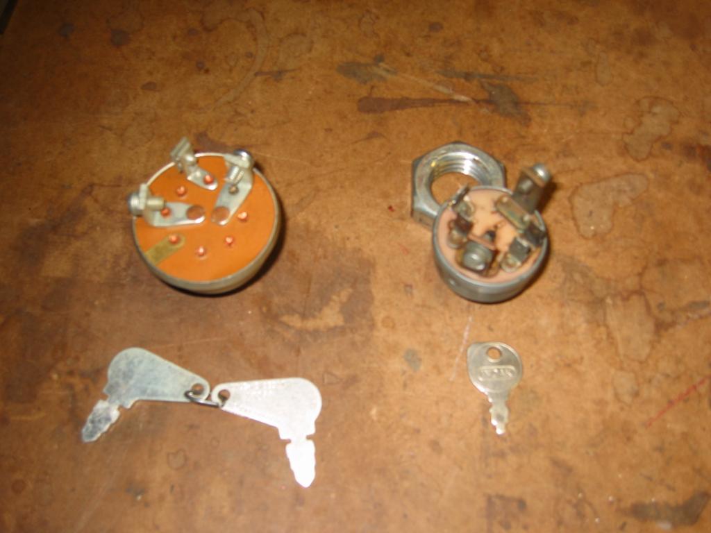

Searcher60 209 #37 Posted January 26, 2020 On 1/12/2020 at 11:48 AM, pfrederi said: WH used same key switch for Kohler Breakerless Magneto and Techy solid state engines. It is the one on the right in pictures. there is a possibility switch was replaced maybe with a Cole hersee heavy duty one (on the left.) The solenoid must have been a modification by a previous owner I cannot find any Charger Electros that came with solenoids. How many terminals on your switch??? Key is C-Hersee 83353 The Amazon link you give for the switch on the right does not go to that switch. Do you have the correct link or somewhere else to get one? Also, the battery terminals face to the rear of the tractor in the battery box, is the the positive or negative terminal supposed to go towards the PTO side of the tractor? Thanks very much. Share this post Link to post Share on other sites
ebinmaine 79,524 #38 Posted January 26, 2020 34 minutes ago, Searcher60 said: battery terminals face to the rear of the tractor in the battery box, is the the positive or negative terminal supposed to go towards the PTO side of the tractor? I don't know which way they're SUPPOSED to go... But I ALWAYS put the negative post near the belt guard which is towards the PTO. I do that so if have to jump that tractor or need it to jumpstart another tractor I'll have less chance of touching the positive cable to something big and metal like the belt guard. 1 Share this post Link to post Share on other sites
pfrederi 20,828 #39 Posted January 26, 2020 1 hour ago, Searcher60 said: The Amazon link you give for the switch on the right does not go to that switch. Do you have the correct link or somewhere else to get one? Also, the battery terminals face to the rear of the tractor in the battery box, is the the positive or negative terminal supposed to go towards the PTO side of the tractor? Thanks very much. The only amazon picture i gave went to the 5 wire harness and plug. I do not have a link for the switch on the right. i thought you were going to use a generic magneto 5 pin switch? The wood in the batter box is not original. WHs back then came with full sized batteries (22NF) top clamp style. They were mounted with neg to the rear left side... 1 Share this post Link to post Share on other sites
Searcher60 209 #40 Posted January 26, 2020 2 hours ago, pfrederi said: The only amazon picture i gave went to the 5 wire harness and plug. I do not have a link for the switch on the right. i thought you were going to use a generic magneto 5 pin switch? The wood in the batter box is not original. WHs back then came with full sized batteries (22NF) top clamp style. They were mounted with neg to the rear left side... I have been having 2nd thoughts about which ignition switch to use. I have two battery boxes, the one that came on it, which is 6 inches wide needed a spacer under it as it would not fit between the oil drain pipe and steering gear unless it was raised. I have the 7781 from the parts list also. It is 5 1/2” and will fit without raising it. Using the original ignition switch simplifies the wiring. As long as the compression release is working as it should, the original should last a long time. i have another dash, face place, and lots of other parts. Been going at it pretty hard. 1 Share this post Link to post Share on other sites
pfrederi 20,828 #41 Posted January 26, 2020 Your battery box issue is because the oil drain on Kohler powered Chargers was out the front of the block. (Techy out the back) Forget the parts diagram explosion look at the photos in the operator manual Share this post Link to post Share on other sites
Searcher60 209 #42 Posted January 28, 2020 Any Toro dealers selling below list? I like the original ignition switch because you cannot run the starter with the PTO engaged. Best deal so far is about $76 shipped with tax for the original WH 8362 switch. Also, on the Electro12, where/what did the battery ground originally bolted? Thanks Share this post Link to post Share on other sites
ebinmaine 79,524 #43 Posted January 28, 2020 If you have a small old school auto parts store that sells Standard motor parts, BorgWarner, or Cole-hersee I would not hesitate a heartbeat to use one of those. You may be able to do an online search and find that switch at a much better price or one of the above listed aftermarket brands. My 1970 Charger had the ground cable going up to the shelf that holds the gas tank. I believe that to be a reasonable place because it's closer to ground the ignition switch or whatever. However... It's tough to say you could have too many grounds and I would highly advise Running A Full Size Ground cable directly to the ENGINE. Electricity will always find the path of least resistance and if the big cable becomes disconnected or corroded it WILL go out a small cable and melt it, even on ground. I've had it happen. Share this post Link to post Share on other sites
pfrederi 20,828 #44 Posted January 28, 2020 plus one on a direct engine ground add on.. In most 5 pole switches i have seen the ACC terminal (power source for the Electric PTO) is not hot when it is cranking. Share this post Link to post Share on other sites
