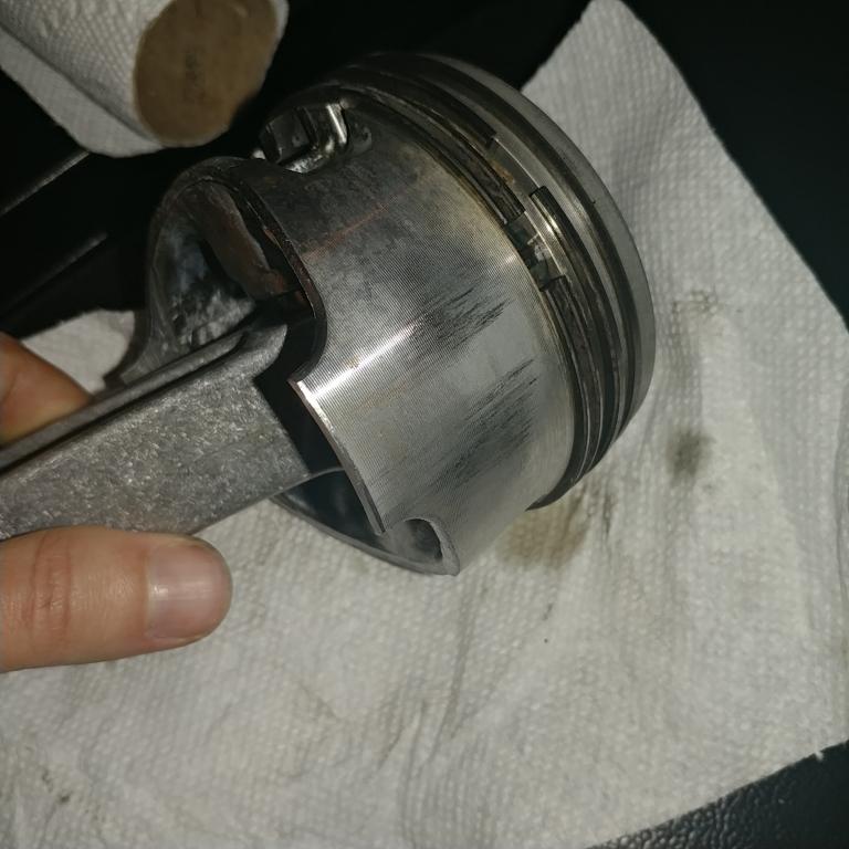

1990Onan520-H 15 #55 Posted February 6, 2020 On 2/2/2020 at 3:08 PM, bcgold said: Would like to see some pictures of those pistons. Here's the piston from the damaged cylinder. No rings are stuck in either cylinder and rod journals look great. Wrist pins tight and all clips in place. Lifters are also free to move. I'm wondering if this gear play is normal and the tap was out of adjustment valves. At this point I think I'm going to buy all new gaskets and seals and throw it back together hoping for the best. The engine seems to be in decent shape for 1000 hours and 32 years. 1 Share this post Link to post Share on other sites
troutbum70 858 #56 Posted February 7, 2020 Looks like you have been on what Trump calls a witch Hunt. Had you during your journey done a valve tappet adjustment? Share this post Link to post Share on other sites
1990Onan520-H 15 #57 Posted February 7, 2020 1 hour ago, troutbum63 said: Looks like you have been on what Trump calls a witch Hunt. Had you during your journey done a valve tappet adjustment? Not yet, but I will be doing one. They were out of spec for sure. Intake valve had zero clearance and the exhaust I believe too much. Cleaned out the piston rings, although they were not in bad shape at all. Going to order a complete gasket set tonight to reseal it all and toss it back together. Just going to hope she has another few hundred hours left in her. I put the pistons back in tonight too so reassemly has started. Also as a side note, when I pulled the pistons out there was no ridge. They came out no problem. Share this post Link to post Share on other sites
