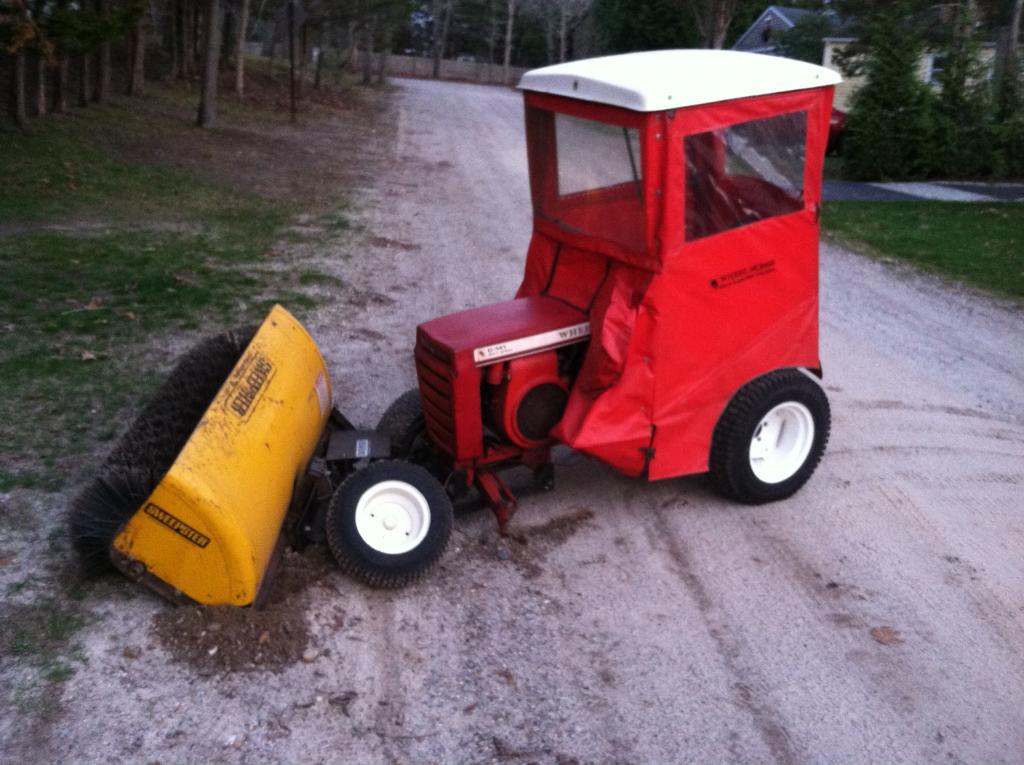

c-series don 11,481 #8 Posted January 9, 2020 The wheel can also pop off if you have a sweeper hanging off the front end and the C clip comes off the front axel. Ask me how I know 😜 3 Share this post Link to post Share on other sites
pfrederi 19,956 #9 Posted January 10, 2020 2 hours ago, c-series don said: The wheel can also pop off if you have a sweeper hanging off the front end and the C clip comes off the front axel. Ask me how I know 😜 i see you are a long way from the shop..just like when mine fell off plowing snow. 1 Share this post Link to post Share on other sites
12Horse Paladin 1,038 #10 Posted January 11, 2020 On 1/9/2020 at 3:59 PM, c-series don said: The wheel can also pop off if you have a sweeper hanging off the front end and the C clip comes off the front axel. Ask me how I know 😜 As of last night... I really wish you hadn't posted that.😲 Sigh...more figuring out; more work ahead. But with fresh snow n a shop with no heat, leaves me kinda dead in the water. Ah, it's all good.😉 But...can it be spring, now? Share this post Link to post Share on other sites
