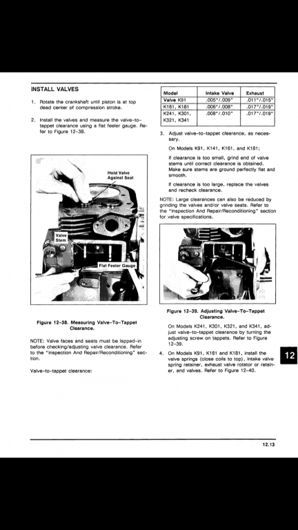

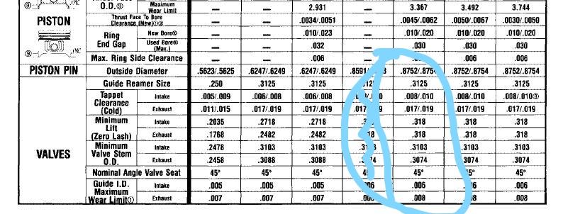

pfrederi 20,257 #26 Posted January 10, 2020 What is clearance between valve stem and the tappet. K301 circled Share this post Link to post Share on other sites
pfrederi 20,257 #27 Posted January 10, 2020 (edited) What is clearance between valve stem and the tappet. K301 circled Edited January 10, 2020 by pfrederi Share this post Link to post Share on other sites
The Tuul Crib 7,354 #28 Posted January 10, 2020 Heres a chart Share this post Link to post Share on other sites
AHS 1,674 #29 Posted January 10, 2020 15 minutes ago, The Tool Crib said: Heres a chart Ok! I got the kohler k series Manuel ordered today. Share this post Link to post Share on other sites
pfrederi 20,257 #30 Posted January 10, 2020 (edited) 5 minutes ago, AHS said: Ok! I got the kohler k series Manuel ordered today. You can download it for free from the manual section here Edited January 10, 2020 by pfrederi Share this post Link to post Share on other sites
AHS 1,674 #31 Posted January 10, 2020 I know, but I wanted it in a book form. I’m old school!😁 Share this post Link to post Share on other sites
