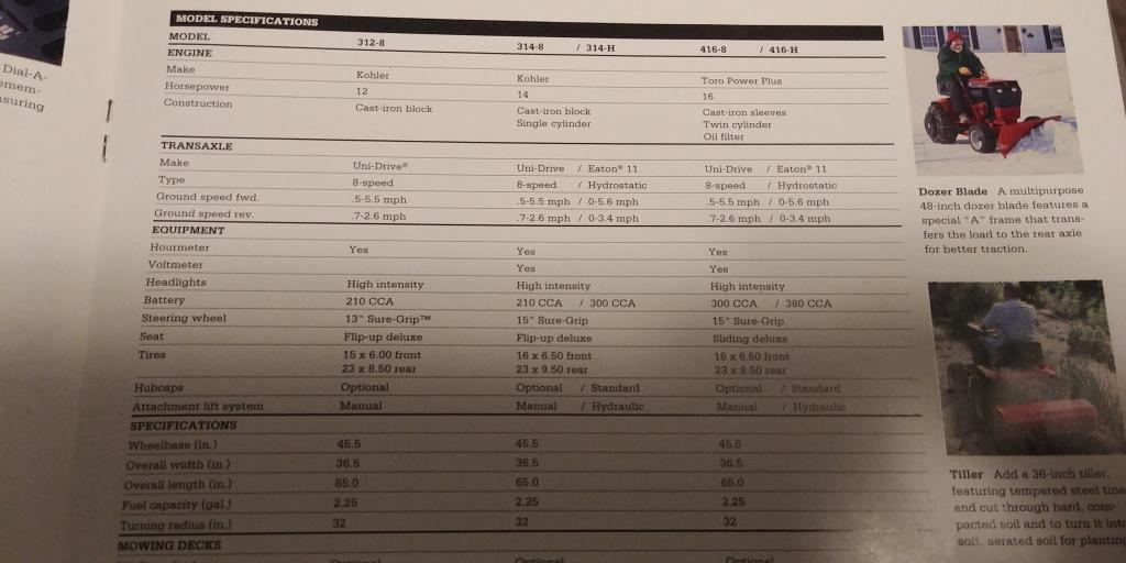

WVHillbilly520H 10,378 #12 Posted January 6, 2020 48 minutes ago, WVHillbilly520H said: I would say (because most tractors of that model did) the 314H came with 8" front wheels and either a 42" or 48" mowing deck. The 310s and 312s were more likely to use 6" front wheels. 23 minutes ago, midpack said: There are different spindles between 6" and 8" front wheel models. The 300 series machines I've seen usually have 6" My 400 series and C machines have 8" Here it is straight out of my 1996 sales brochure... 1 1 Share this post Link to post Share on other sites
midpack 1,104 #13 Posted January 6, 2020 6.5" tires? Share this post Link to post Share on other sites
WVHillbilly520H 10,378 #14 Posted January 6, 2020 Things that make you go hhhmmmm.... But I have personally seen more 314-5 with 8" wheels than 6" , but never 6.5". Share this post Link to post Share on other sites
gwest_ca-(File Mod) 12,000 #15 Posted January 6, 2020 Those are tire widths - not wheel diameters. Garry 1 Share this post Link to post Share on other sites
WVHillbilly520H 10,378 #16 Posted January 6, 2020 8 hours ago, gwest_ca said: Those are tire widths - not wheel diameters. Garry That being said 16×6.5 tires 99.9% go on 8" wheels. 1 Share this post Link to post Share on other sites
