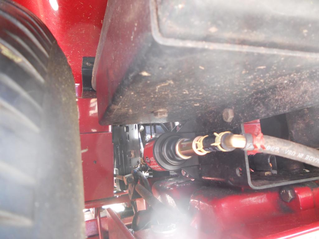

Racinbob 12,706 #2 Posted January 3, 2020 I didn't remove the fuel pump. It was still fine but I had issues getting it started that was caused by the fuel tank under the seat. It was likely the issue was made worse because the fuel pump on the Command is higher than a K-series. I just found a cozy spot under the tank to mount the pump and ran it to the original fuel pump. Starting issues completely resolved. I used a Mr. Gasket #42s pump. 5 1 Share this post Link to post Share on other sites

biged77 113 #6 Posted January 3, 2020 I use a Mr.Gasket 42s. Installed it several years ago under the tank like Racinbob. No problems since. Ed 2 Share this post Link to post Share on other sites
