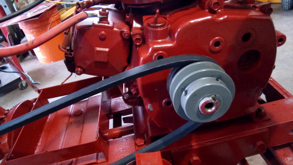

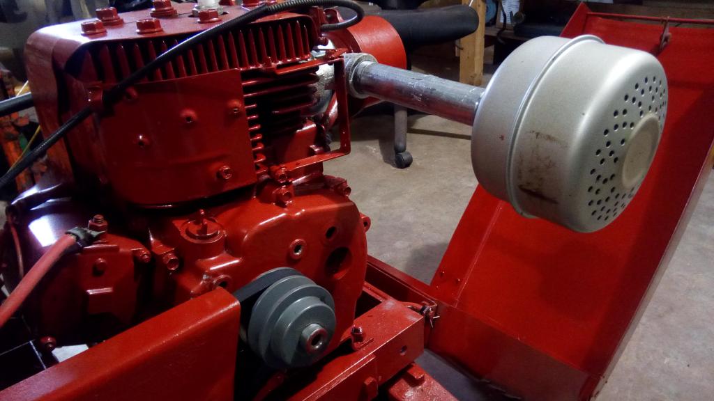

C_hasbeen 249 #79 Posted February 16, 2020 I believe my belt is to short, it is 70 inches because the old one was but I did not think maybe my pulley is different size than previous people had on it. I slipped the belt some to get the paint off of the new front pulley which helped some. I may see what the next size up is. Does this picture look like I should have more slack with clutch pushed down? Share this post Link to post Share on other sites
rjg854 13,384 #80 Posted February 17, 2020 The belt guard is what will give you your answer 2 Share this post Link to post Share on other sites
Achto 32,797 #81 Posted February 17, 2020 Without the belt guard installed there is nothing to stop the belt from spinning. 1 Share this post Link to post Share on other sites
Pullstart 71,333 #82 Posted February 17, 2020 glad to see some lint was the only major problem with that engine! She’s a beaut! Share this post Link to post Share on other sites
C_hasbeen 249 #83 Posted February 17, 2020 15 hours ago, rjg854 said: The belt guard is what will give you your answer Oh because it has that piece on the end so it would hold up the belt? I best put it on tonight and see what happens. 2 Share this post Link to post Share on other sites
ebinmaine 80,777 #84 Posted February 17, 2020 1 minute ago, C_hasbeen said: because it has that piece on the end so it would hold up the belt Exactly. The belt GUARD is the belt GUIDE on many tractors Without that in place it won't shift or clutch right. 2 Share this post Link to post Share on other sites
C_hasbeen 249 #85 Posted February 17, 2020 7 hours ago, ebinmaine said: Exactly. The belt GUARD is the belt GUIDE on many tractors Without that in place it won't shift or clutch right. Well I just put my belt guard on and what do you know! Shifts fine! Now that I look at it while I was stuffing the belt in there from dangling down. 2 Share this post Link to post Share on other sites
C_hasbeen 249 #86 Posted February 17, 2020 22 hours ago, rjg854 said: The belt guard is what will give you your answer Thanks a million! 2 Share this post Link to post Share on other sites

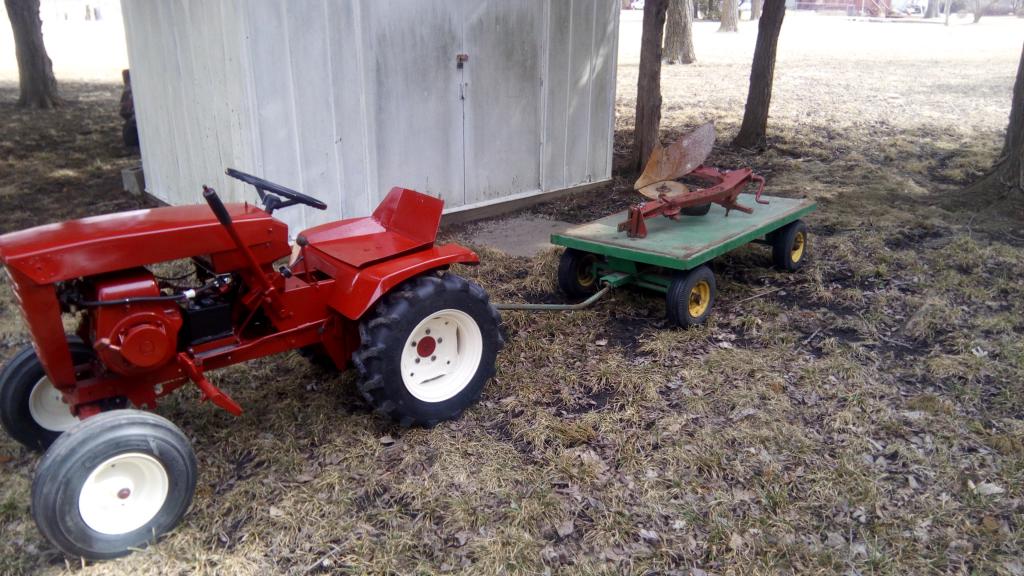

C_hasbeen 249 #91 Posted February 22, 2020 Finish the electrical last night charging system works, I need to put a choke cable on yet. First start today choke and two revolution of the starter ang running. After it is warm just bump the starter and running. I think I will make an exhaust bracket yet. I have calcium from one rear tire left from the old ones, I need to fill all of my tires yet and put on my wheel weights. Will need to get it done won't be to long till I meet to get the new garden going. 3 2 Share this post Link to post Share on other sites

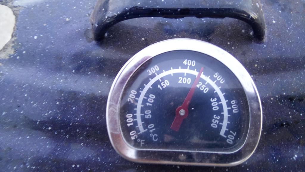

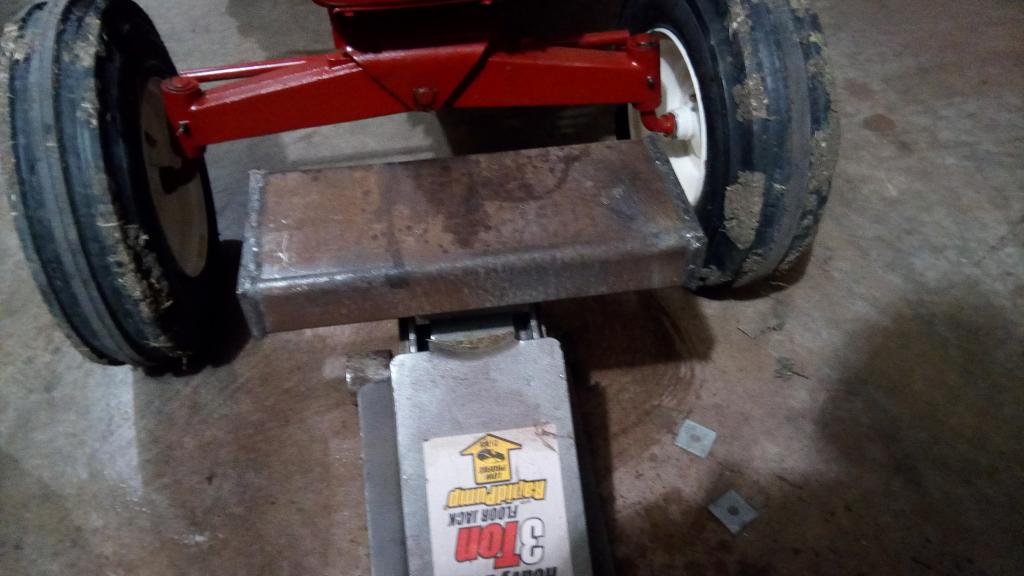

C_hasbeen 249 #93 Posted February 29, 2020 My front weight I used 5 x 2 box tube 1/8 wall 12 inch long and capped the ends with 1/8 iron. Oh and filled it with lead before welding on the last end cap. I had some lead so I put the BBQ grill in over drive. Now after it cools down I will clean it up with the angle grinder and ponder the mounting brackets. 2 Share this post Link to post Share on other sites

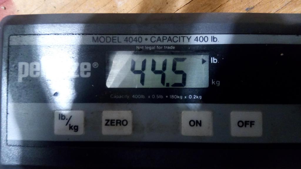

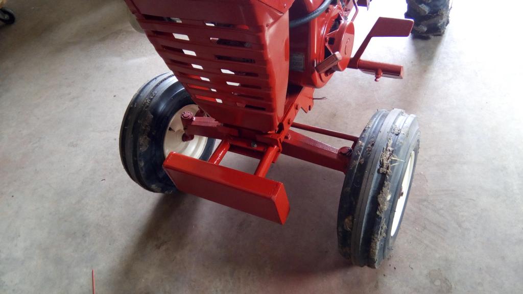

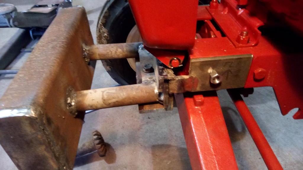

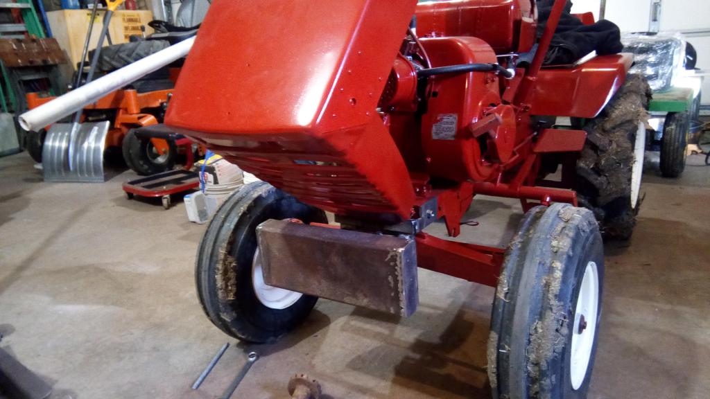

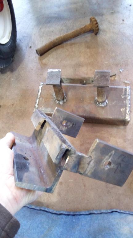

C_hasbeen 249 #96 Posted March 1, 2020 Detachable front weight. I made this bracket to mount solid on the tractor with a bolt on each side and the bracket butts up to the accessory mounting plate and sits solid against the front of the frame, the weight I slide in left to right and drop a bolt in it and it is solid. Weld are not pretty but will hold fine, I used 1 inch axle shaft to stand the weight out in front a way. Bracket and weight come in at 50 & 1/2 pounds, that should help with that heave cast iron plow. Welds need cleaned up and paint applied yet. 3 2 Share this post Link to post Share on other sites
C_hasbeen 249 #97 Posted March 1, 2020 I kinda like how it turned out. After I get my chicken coop built rear wheel weights go on for plow time. 3 1 Share this post Link to post Share on other sites
