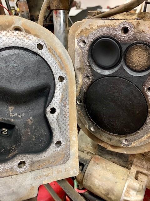

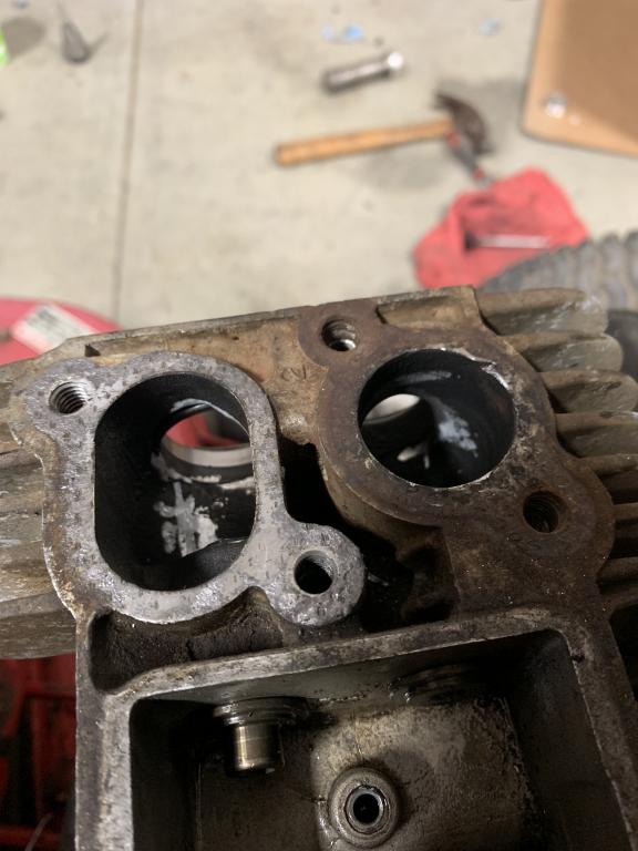

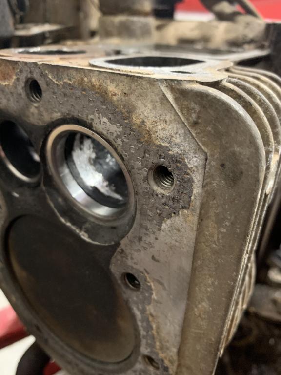

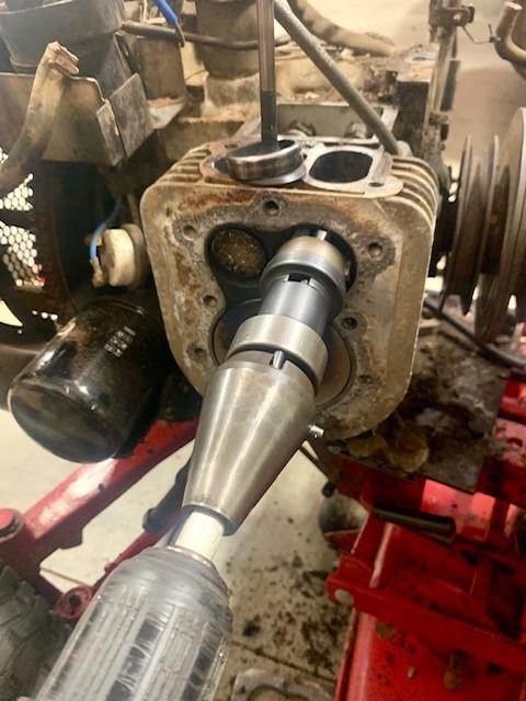

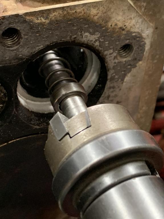

Greentored 3,220 #1 Posted December 31, 2019 Halfway through a chassis up resto on my 91 520H, I yanked the heads to do a decarbon and bet you know exactly what I found. I had a speed shop for awhile and still have some equipment, I have already fabbed up adapters and will be cutting in oversized seats right on the tractor and thought this may be of interest to some. Sometimes its not how we get there, its knowing what the end result needs to be and finding a way to do it. On another note, this 1308 hour, obviously poorly maintained P220G engine was otherwise pretty impressive! Bores are beautiful, guides are tight, valve adjustments were within a few thousandths (aside from the zero lash rear intake, indicating the seat issue). Note #3- As an experiment, I warmed this engine to operating temp, ran it up to 2200rpms, and trickled half a bottle of seafoam right down the throat, shut it down, let it sit 30min, and did it again til the bottle was empty, then ran the hell out of it for 15 minutes. Look at the carbon in the pic, or lack thereof! No I cant conclude the seafoam did this as I do not know the maintenance history or 'before' carbon, but judging by the rest of the tractor, I highly doubt the heads have ever been off it. Anyone else ever tried this? 3 Share this post Link to post Share on other sites

lynnmor 8,076 #3 Posted December 31, 2019 How much press are you going to use to retain the seat? I was able to use a .010" oversize Onan seat by boring a very small amount on a Bridgeport milling machine and leaving .0055" press. Of course the block was not worn much. I warmed the block for about an hour with a heat gun while the seat cooled in dry ice. Using this method and working very fast the seat will go in with very little persuasion. If you hesitate for more than a couple of seconds, the block will shrink while the seat grows. I made tools to stake a bit of metal around the seat for additional retention rather than using a prick punch, Onan made such a tool. The carbon looks about the same as any Onan that still runs well, I never use Seafoam. Share this post Link to post Share on other sites

Greentored 3,220 #5 Posted December 31, 2019 3 hours ago, lynnmor said: How much press are you going to use to retain the seat? I was able to use a .010" oversize Onan seat by boring a very small amount on a Bridgeport milling machine and leaving .0055" press. Of course the block was not worn much. I warmed the block for about an hour with a heat gun while the seat cooled in dry ice. Using this method and working very fast the seat will go in with very little persuasion. If you hesitate for more than a couple of seconds, the block will shrink while the seat grows. I made tools to stake a bit of metal around the seat for additional retention rather than using a prick punch, Onan made such a tool. The carbon looks about the same as any Onan that still runs well, I never use Seafoam. Ive always used .008-.010 on aluminum heads and .006-.007 on iron and havent lost one yet, so shooting for the same. Believe it or not, always made my cuts, tossed the seats in a cup of ice water, centered them up and knocked em in. The key was to not have ANY sort of rough edge on the seat chamfer, and Id make a VERY light chamfer cut on the head as well, and knock any edge off with a scotch brite. Kinda dig your idea and may throw some heat on the block to facilitate things a bit. I lucked out as well, the seat did 'sink' about .020 but the bore measures .001 larger than the seat. If I were patient I believe a +.010 Onan seat would be just fine and save some hassle. I nicked a seat on a set of Harley heads once while porting and needed to replace. I froze the seat, tossed the head in the gas grill at 300, and the seat literally fell in- that was at .010 interference at room temp. Still amazing how much materials 'grow'. 1 Share this post Link to post Share on other sites

Greentored 3,220 #9 Posted January 2, 2020 (edited) New seat installed, refaced the valves at 44 degrees per the book, stoned the seats at 45, and she’s back up and running! This procedure worked very well but as I’ve seen before, the aluminum on these small engines (and import vehicles/some fords) is apparently of different quality and tends to almost smear versus a nice clean cut. It hasn’t presented a problem in the past and hopefully doesn’t here either. Set up for at .010 press, then heated the block, froze the seat, and drove it home. Coming from a lifetime of hotrodding, the sharp edges in the ports drove me nuts, so it got a quick port touch up, mainly in the exhaust short turns. More concerned with efficiency and perhaps a touch cooler running than power increases. Has anyone ever hopped up one of these Onans? Edited January 2, 2020 by Greentored 1 Share this post Link to post Share on other sites
